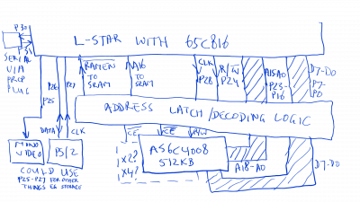

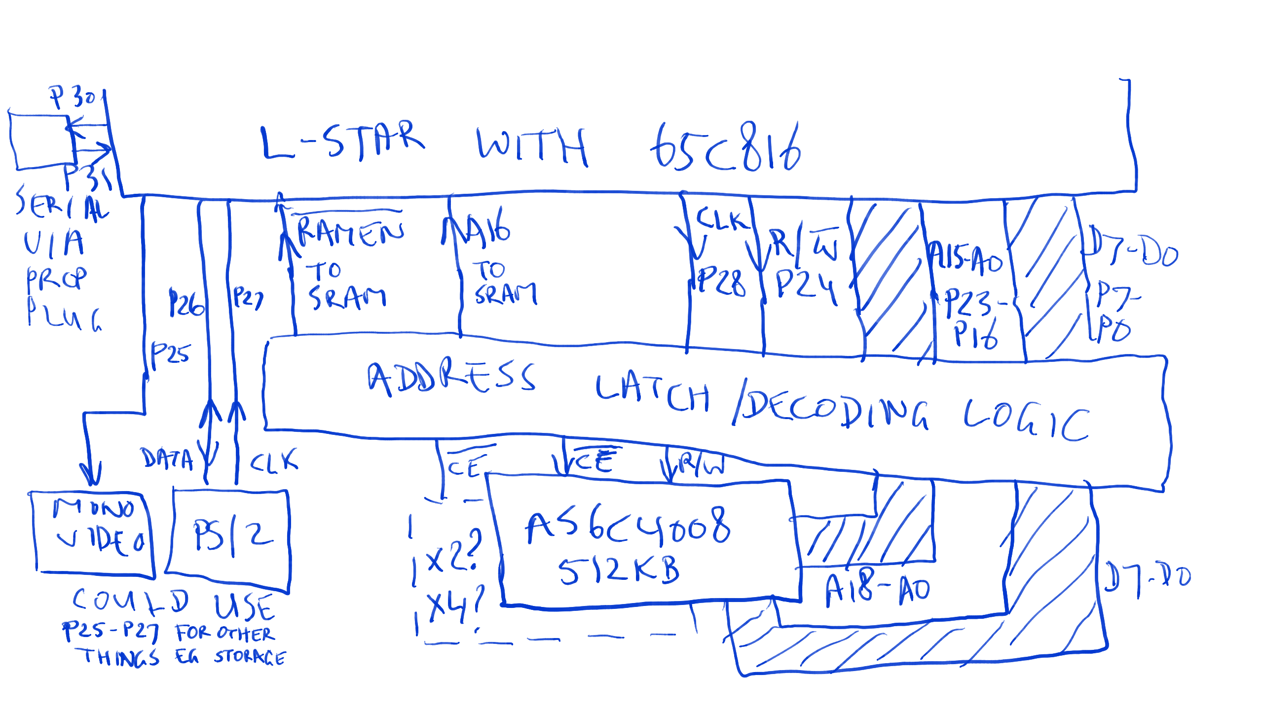

Slightly crazy idea. What would happen if you put a 65C816 in the L-Star? The pinouts are similar enough that with a few jumpers tying some previously NC pins high it might just work.
PostPosted: Wed Dec 07, 2016 10:15 pm
Posts: 229
Not THAT crazy :-)
It's certainly possible to put a 65C816 DIP chip (The link is the Mouser product page of the DIP version; the picture on the page is wrong) into the 65C02 socket and make it work; I think the pins that I don't use are extra outputs on the 65C816, used for more complex systems e.g. with multiple processors. So you won't have to cut any traces on the PCB and I don't think you would even need to solder any of the unconnected pins unless you want to make something complicated (in that case you can always build the L-Star circuit on a breadboard or veroboard, it's not that complicated).
However, I'm not sure if it will "just work": the 65816 multiplexes the address bus with the data bus so during Phi1, instead of putting the D0-D7 pins in high-impedance mode (like the 6502 does), it puts the high 8 bits of the address onto D0-D7. It may be necessary to touch up the Propeller firmware in a few places if you're going to use some of the existing firmware; obviously I didn't design it for a 65C816.
That said, it should probably be pretty easy to create a 65C816 system with a simple I/O system (e.g. emulating the Apple 1 PIA module and using the serial port). I could modify the SRAM control module from the Apple 1 SRAM project so that it reads D0 during Phi1 and interpret it as A16 to do a lookup in the internal table to enable the RAM chip via P27 (jumpered to !RAMEN). It would also put the A16 bit onto P25, which would be jumpered to A16 of the SRAM chip.
That gives me an idea: you could build an expansion board with another 128KB SRAM chip and pretty much nothing else, and run another cog generating the Chip Select for this chip on P26 (it would also use tap into P25 for A16).
Or you could put some address latching/decoding logic on an expansion board and add the biggest DIP SRAM chip available (as far as I know) which is 512KB: the AS6C4008-55PCN. Or more than one, they're not that expensive. I'm going to think about this idea for a while because it might be fun to run Fuzix on a system like that.
Too bad it would still have to run the 65C816 at 1MHz though, but I have some ideas to fix that. It may be possible to run the clock at (say) 4MHz for any areas that don't have to be monitored by the Propeller.
Anyway... I would like to get more documentation online and I would like to emulate some more existing systems like the PET and the Hob-bit (Acorn Atom). Also there's still no ACIA emulation for the OSI so I need to finish that. Those are my highest priorities right now. Feel free to run with the ideas, though!
===Jac
