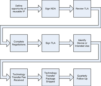

They do license it, but it doesn't look practical for hobbyists unless you have money to burn. See http://westerndesigncenter.com/wdc/cores.cfm .
Licensing Process
IP License Business Model
The WDC licensing business model is flexible and is a combination of licensing fees and royalties that can be negotiated at the time of licensing. Our Technology License Agreement (TLA) is available to those qualified potential licensees under an NDA. Once licensed, all required views of the technology are transferred under the TLA. Our IP has been proven in volume production standard products and various licensed ASIC products of our licensees on various pure play foundries for example UMC and TSMC at sub-micron geometries. In addition, several integrated device manufacturers have had significant success within their internal manufacturing facilities over the last 25+ years. WDC can retarget to specific process nodes or as a licensee you can retarget to any CMOS process node you desire.
Comments on Lattice FPGA Usage
“Our Lattice XP2 implementation is an instant-on emulation of our GDSII hard cores. Having an emulated ASIC core gives the user the ability to either emulate an ASIC or just stay with the XP2 for complete flexibility in one device. Flexibility in design is one of the hallmarks of the 65xx brand technology over the last 33 years. This legendary flexibility secures a wide breadth of application not available with other processor families especially on an 8-bit cost effective bus. The Lattice XP2 devices help showcase our products while providing the end customer with new value added features.”
- David Gray, WDC Engineering Manager
