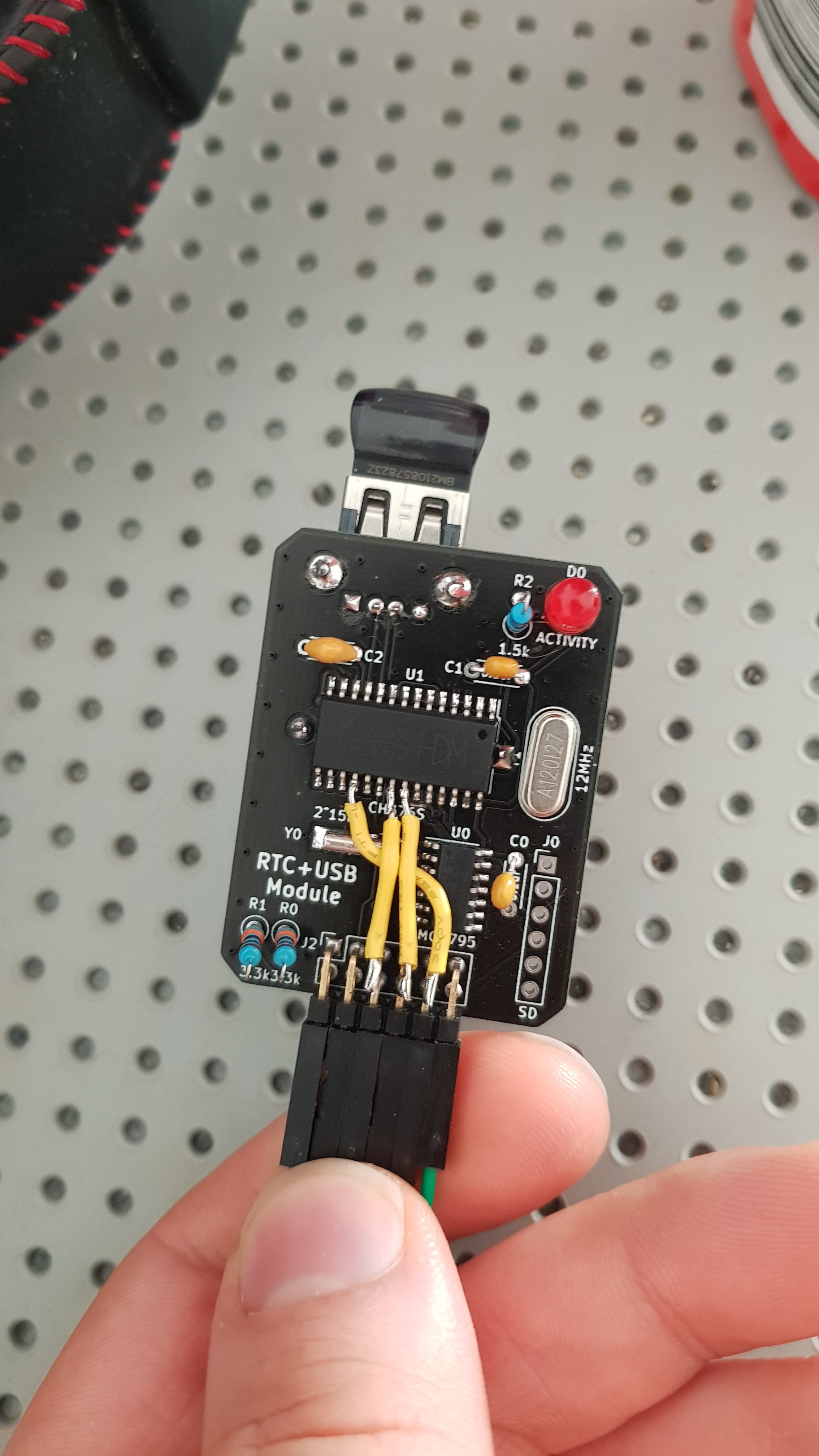

i've been using the CH376 with my 65816 SBC and it's been working perfectly fine (still making a C library for the chip). though i'm using the SPI interface instead of the parallel one, as that takes up less IO on my VIA. especially useful since i also have an RTC on the same SPI lines.
here the module i made that contains both the CH376 and the MCP795 RTC (battery holder on the back):
(ignore the botch wires, i already fixed that in v2, and once i confirmed the RTC works i'll upload all files to my github)

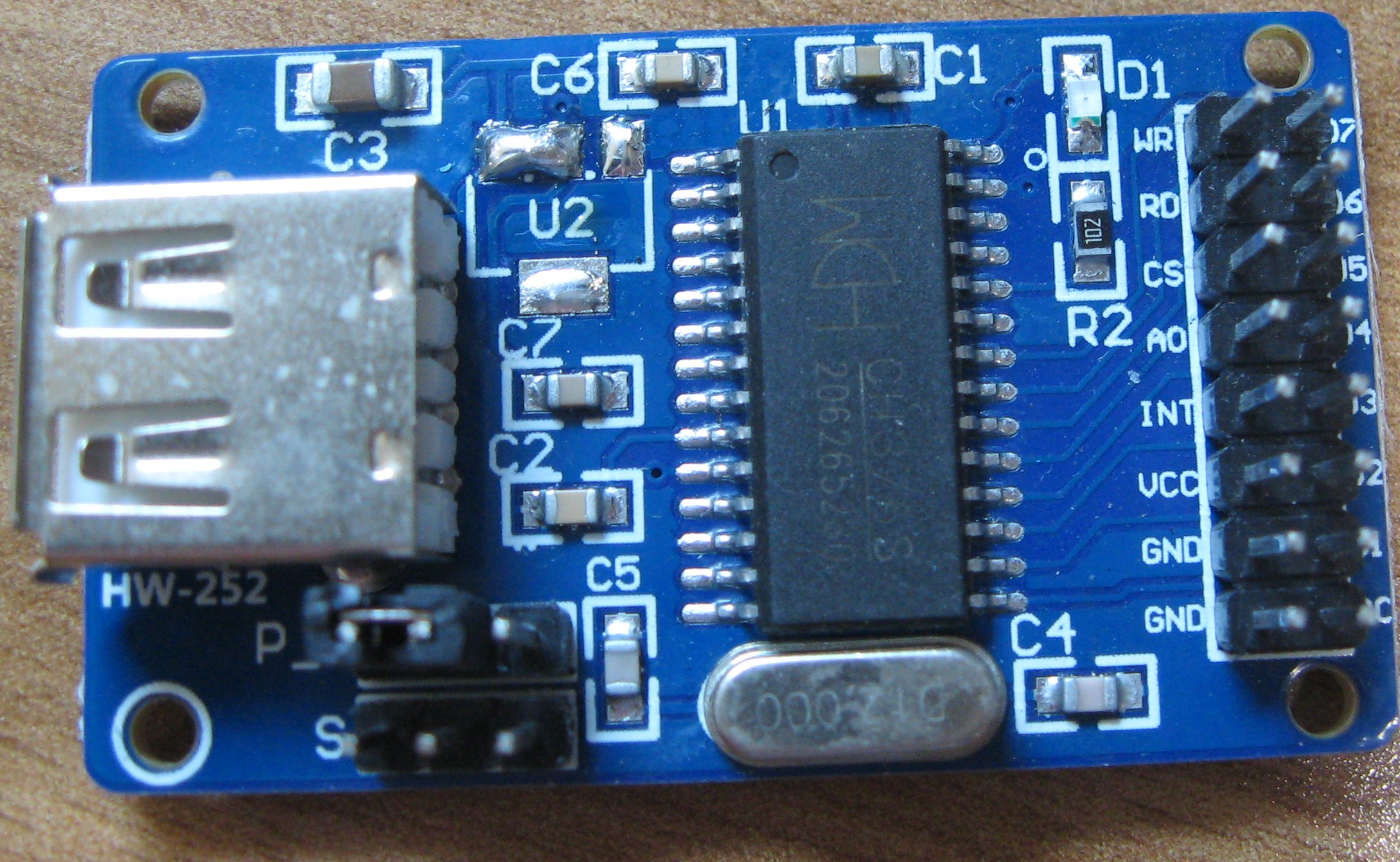

if you're using one of those arduino CH376 modules, they're running at 3.3V which may cause occasional issues when reading from the chip. you can modify the module to run directly with 5V by simply removing the regulator and bridging the left and middle pins of where the regulator used to be. also i'd recommend making use of the INT line, i find it much more convenient than polling the BUSY bit in the status register.

PostPosted: Sun Jun 11, 2023 3:00 am
Posts: 255
Thanks for mentioning this. I removed the 3.3V regulator and that seems to have resolved issues I was having with the chip locking up or returning garbage data. Now I just need to play around with it and figure out how to get it working. I'm using the parallel mode and have it wired directly to my bus.
There are multiple variations of the CH376S board out there. I checked out the voltages on mine and, sure enough, VCC (pin 28) was running off a 3.3V regulator. More interestingly, V3 (pin 9) had a cap on it, but was not tied to VCC, which the datasheet says it should be for VCC=3.3V operation. The "just a cap on it" configuration is only for 5V VCC. This means the board came in a configuration that is not valid, according to the datasheet - it says that pin 9 should be tied to VCC when running the chip off 3.3V and should just have a cap to ground on it when VCC=5V.
I believe the V3 pin is an internal regulator that makes around 3V for the USB data lines (USB 2.0 power is 5V, but the data line signals run around 3 or 3.3V). When running with 3.3V VCC there wouldn't be enough voltage after the internal regulator so, when running off 3.3V for VCC, they recommend tying 3.3V directly to V3 as well (esentially bypassing the internal regulator).
For others thinking of bypassing the regulator, double check that VCC (pin28) is NOT shorted to V3 (pin 9) on your PCB. Looking at screen shots of other boards, it's hard to tell but it appears they are shorted on at least some variations of the board. For 5V operation, the V3 pin (pin 9) should only have a cap to ground on it and should NOT be tied directly to VCC (pin 28).
Here's a photo of my modified board (U2 removed and two of its pins shorted to tie VCC to 5V):
