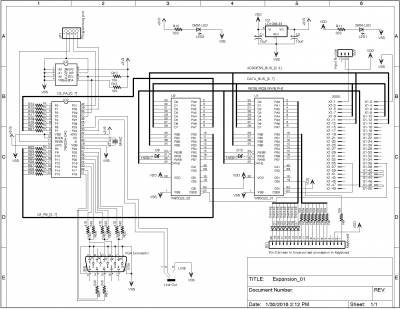

Alamorobotics wrote:
I'm not sure why there are diodes on the IRQ for the W65C22, the schematics I copied had them so I threw them in there... :lol:
http://www.westerndesigncenter.com/wdc/Schematics/W65C816SXB.pdf
They should not cause me any problems since I don't plan to use the IRQ for now..
Any thoughts about the diodes ?
The W65C22S (note the S) has a totem-pole interrupt output, whereas many devices use an open collector output. On a wired-OR interrupt line, the diode will prevent one of the open collector devices from trying to sink the output of the W65C22S. This arrangement is not necessary if using the W65C22N, which has an open collector interrupt output.

Thanks Garth for the IRQ primer, nice work...
That explains the diode, the schematics uses a MMSD4148 and I picked the through hole version of it.
What would be a better choice for through hole diode ?

You're welcome. Actually, that's the IRQ/NMI connections page of the 22-chapter 6502 primer which is about building your own 6502 computer and is mostly hardware-oriented. My interrupts primer is separate, and is at http://wilsonminesco.com/6502interrupts/ .
As for a recommended diode in thru-hole: I checked Mouser's site for Schottky diodes hoping to find one in a DO-35 package like the common 1N4148 or 1N914 uses, but the only one they had listed turned out to not be Schottky, if you look at the data sheet. In the DO-41 package (like the 1N4001 uses), there's the 1N5817 which is usually used for switching power supplies, not logic, but it looks like it would work ok. Even at 20mA, its forward voltage is only about 100mV. Schottkys do have a lot of capacitance, and this one sits at close to 200pF but it should still work ok for this application since you don't need to switch as quickly as a logic gate does.

Thanks for the recommendation, I have finished the schematics and also update Github.
I replaced the diode in the schematic but kept the one on the prototype board.
https://github.com/alamorobotics/W65C81 ... d_VGA_SID/
I'm wrapping up the soldering and hope to be done tonight...

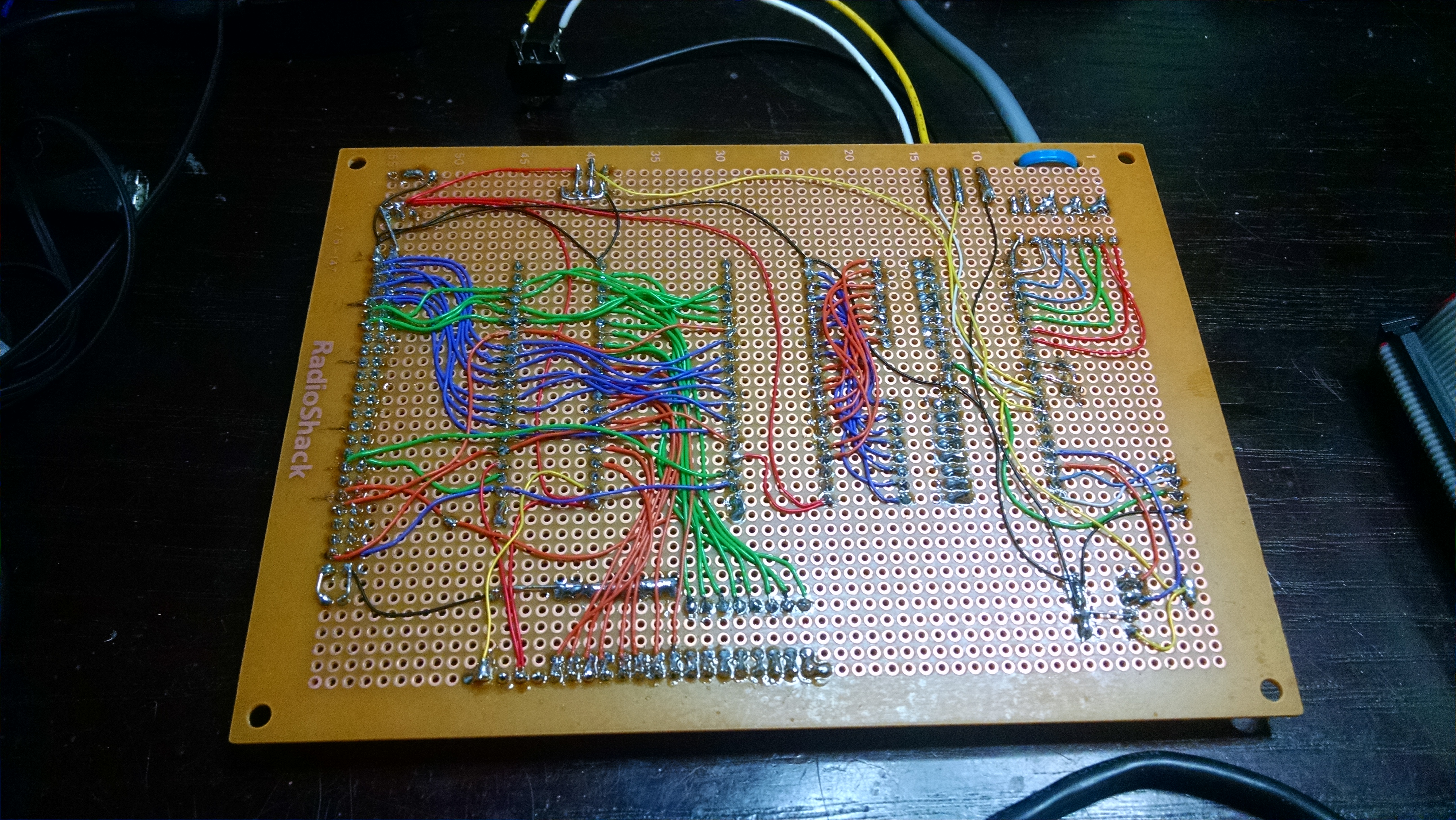

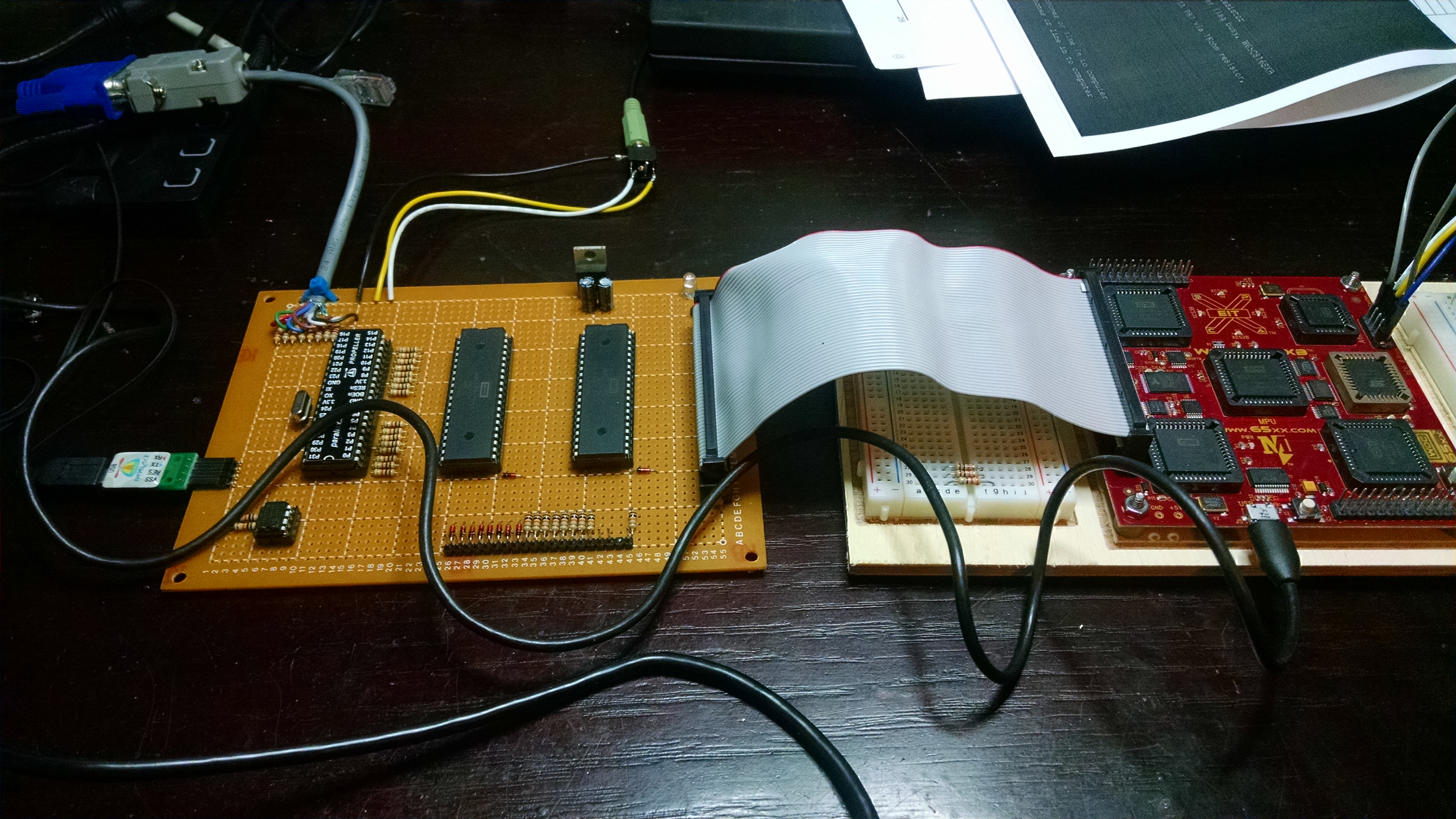

Got it all done and tested, seem to work OK.
Lots of interference between the SID emulation and VGA, will look into it later... ;-)
Now for the fun part, programming...

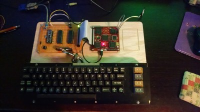

Made a little board to bolt everything down to and the keyboard...
Starting to look like a little computer... ;-)

PostPosted: Fri Feb 05, 2016 7:45 am
Joined: Tue Dec 01, 2015 10:19 am
Posts: 11
Looks really nice :)
How did you do the board? 3d printer?
Doh, I sould have looked closer at the picture :) Saw the wood parts now!

Howdy...
Yes, that is simply some cheap plywood from Home Depot.
I made a hobby CNC machine earlier and used it to cut the base for the Zeberpupin computer.
I call it Zeberpupin in honor of the Dilbert cartoon, http://dilbert.com/strip/2011-11-21
