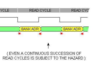

Hmm, 4.5V or so is probably what the CF was getting on Friday, back when it was inadvertently being powered via the input-protection diode (rather than the 1N4148).
I have a half-baked theory that says the main board has noise on the +5 -- spikes during which the voltage briefly sags below +5 -- to which the CF is sensitive (more sensitive than the circuitry on the main board). Having the diode there tends to isolate the CF from the noise because the diode will stop conducting during the sags, and the CF will be sustained by its bypass caps. (The diode also changes the current waveform on the Gnd & supply conductors feeding from the main board to the CF, thus possibly alleviating some unnoticed shortcoming in the layout or wiring practices.... but that's a different half-baked theory! :) )
Can I suggest you try adding a lot of extra bypass capacitance to the main board? As an experiment, temporarily connect one or more high-quality electrolytic caps (tantalum, maybe, not aluminum) from Gnd to Vcc, keeping the leads short. Then see if the CF will work when you connect it directly to +5 (ie, short out the diode). If adding extra bypass capacitance allows normal operation (ie, with the CF tied straight to +5, no diode), then I'd look into the matter further. For example you may well have fractional-cycle instants of bus contention that cause so much extra noise the original caps are inadequate.
ETA:
cbscpe wrote:
Next thing will be some buffers (one 74HC245 and one 74HC244) so all signals to the CF-Card will be buffered in order to be able to power cycle the CF-Card for tests (actually I consider this also in the final setup so I can hot-swap CF-Cards)
I overlooked your mention of the '245. Adding THAT could be crucial, and not because of hot-swap considerations. Presently you have no transceiver isolating the multiplexed lines d7-d0 from the rest of the data bus, and that means increased risk of contention.
(I'm talking about contention on a fine time scale, where the opposing drivers have no problem for the majority of each half-cycle but they butt heads for 5 ns or so during the handover from one driver to the other. This is illustratated in Managing the 65816 multiplexed bus).

PostPosted: Sun Jan 03, 2016 7:11 pm
cbscpe wrote:
I have added the buffers (74HC245 and 74AC541) in the meantime without any change in the behavior and second all output enables are gated with PHI2 (OE of RAM, IORD of CF-Card, etc) so there should be no congestion even with a 65C816.
It's good that you isolated the CF from the CPU's D7-D0, but the EPROM is still tied in directly, n'est pas? I realize the EPROM /OE is deasserted when Ø2 is low, but there could still be a significant degree of contention. It's a bit optimistic to suppose the EPROM, the UART and the RAM are all capable of relenquishing the bus promptly when told to do so. EPROM's in particular aren't especially fast devices, and I can easily believe it's head-butting with the CPU for 10 ns or more before finally letting go of the bus. During that time the power supply rails get smacked!
Here's another way of explaining. If someone had an '816 system and failed to qualify an OE (for example) then there'd be contention that lasts for half-cycles at a time. THAT kind of contention is very severe, but luckily it's widely understood, and also pretty easy to fix.
Less severe but still a problem -- also much harder to fix and NOT widely understood -- is contention on a finer time scale, caused by the chips' internal delays in obeying their OE input. Contention could be eliminated if all chips on the bus received their OE commands simultaneously and obeyed those OE commands in a timely fashion, but reality conspires against both of those propositions!
WDC recommends using a '245 bus transceiver with the '816, which means the data bus is split into two portions. IMO that doesn't eliminate the problem but it can help a great deal. The mux'ed portion is driven only by the '816 and the '245, which means RAM and I/O needn't participate in timing-critical bus handoffs with the CPU. Having the '245 there also physically shortens the mux'ed portion of the bus, helping with EMI and signal integrity. Perfect handovers can't be guaranteed, which means contention-related current spikes won't be entirely eliminated. That's a good reason to keep the bus short.
Certainly it's possible to deviate from WDC's recommendation of including that '245 bus transceiver, but it's a tradeoff with downsides that including potential difficulty with power supply noise. I'll be interested to hear what you discover, Peter!

I added some tantalum and some other capacitors and I have now two CF-Cards that work without a diode. Your half-baked theory is more like bulls-eye :!: :!: :!: In other words the final setup needs to pay special attention to noise on 5V. I'm sure that was the issue, else those capacitors would never have helped.
As for the other points they will disappear soon. First I had no intention to use a W65C816 but I have no W65C02 at hand. I still need to order some. That was definitively a big mistake and might be the source of most of the noise on 5V. Especially when you think that disabling outputs is slower than enabling, so it is make before break and not break before make, which is very bad actually. The EPROM will be replaced by a blind-load mechanism. The goal actually was to add the CF-Card to ROMulus 1st but before messing up with a running system I built a dedicated test environment.
One point I'm still not convinced is the importance of the contention situation. It is true that the databus of the W65C816 is always an active output when PHI2=low. But that does not cause any issues with reading data from any device (IO, EPROM, RAM). It will only cause some excess current during transition but not more. Mostly during the leading edge of PHI2. When you don't need A16..A23 this will not be an issue. On the falling edge of PHI2 this is less an issue as the W65C816 will definitively wait tdhr (10ns) before activating the output, else it would violate it's own requirement regarding data hold time.
Thanks a lot for your thoughts and hints, they were very useful.

Awesome! I love how you ended up fixing the computer (which was working) and also a Compact Flash (which was working), but you didn't have to do anything to the other CF's -- which weren't working! :D
break before make
Right, break before make (or, worst-case, simultaneous break/make) is what you want. IOW the dead time should be >= 0. (But I'm not sure why you said, "disabling outputs is slower than enabling." Surely for some chips that'll be true, and for others not?)
Good point. Part of the spec for the 816's output enable is found by examining the spec for its input requirements!
I had no intention to use a W65C816 [...]That was definitively a big mistake and might be the source of most of the noise on 5V.
So you're not convinced the source of most of the noise is important? Maybe you're saying the problem will go away when a 'C02 replaces the '816, so why worry.
No I'm not and if it is then it would be the same issue with any 65816 based System. Because if you look at a 65816 system you can assume that only one peripheral device (RAM, IO, ROM, ....) will have it's chip select asserted and that will be the only one involved in a contention situation with the data bus of the CPU. Now when we follow the recommendation of WDC then we have 'only' a '245 competing for the data bus with the CPU on the leading edge of PHI2. And in most cases a '245 is worse than any peripheral, this beast is a high current bidirectional buffer/Driver with a very low output impedance. I argue that a '245 produces even more noise. As my final goal (not this system) still is a 65C816 based system I need to find a solution for this and anybody building a 65C816 system as well. I always thought that it is a pitty that there is no 65C816 with a non multiplexed address bus, a TQFP-44 case would have enough pins for A16..A19 and if you ommit some of the rarely useful signals even for all address signals.
