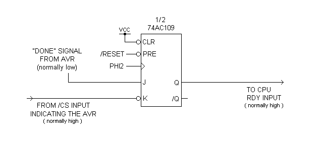

cbscpe wrote:
You could use a pulse generated by the AVR to clear the RDY status. But the shortest pulse you can generate is 50ns with an AVR running at 20MHz.
I modified one of my other wait-state diagrams, Peter -- see what you think of this (below). This will tolerate the 50ns pulse lagging into the following 65xx cycle, so it offers faster operation than your 74xx74 solution. OTOH I'm not 100% convinced the "problem" needs to be solved! Perhaps you've already considered this. If you're willing to avoid 65xx R-M-W operations on the AVR, then any 65xx access to the AVR will be followed by at least two non-AVR accesses. The 65xx will need to fetch its next instruction, so you're guaranteed to have several cycles of delay before another AVR access.
BTW, RDY is a positive-logic signal. Pulling it down constitutes negating it, meaning "No, I'm not ready to move on. I need more time." High (asserting it) means, "Yes. Ready. Go."
The only thing I'd add to that circuit is a small Schottky diode in between the flop's Q output and the MPU's RDY pin, as RDY is bi-directional.
Jeff, thanks a lot, looks promising. Just that with J=H and /K=L the ff will toggle, so I will probably add another flip-flop between DONE and J to limit the DONE=High time to one PHI2 cycle. But the good thing about your approach is that each state change is synchronous to PHI2 and that is what is important in such a circuit.
The reason devices such as UARTs exist is they do very efficiently in hardware what a microcontroller less efficiently and more slowly in software.
Contrary to the subject of this post (which was not started by me btw.), I'm primarily interested in the following IO features of the AVR: I2C, SPI, ADC, Timers with PWM outputs. The USART is interesting because of it's synchronous mode. So you can connect a PS/2 keyboard and a Mouse and the USART does all the frame checks (start-bit, parity-bit, stop-bit). Also using the USART of the AVR we do not do anything in software related to the RS-232 protocol. The only difference in efficiency comes from the fact that a read/write to a register is slower than that of your preferred UARTs.
Yes of course and also the pull-up should not be to weak.
You want the flipflop to toggle then, as I think you know. Yes there are limits on the max and min duration (measured in 65xx clocks) that DONE may be high. Still, I have a feeling the limits may be acceptable as-is. If not, they could be extended with another FF as you say. (As-is, the min duration is one 65xx clock plus a few ns for setup time. The max duration would depend on whether R-M-W instructions will be applied.)
