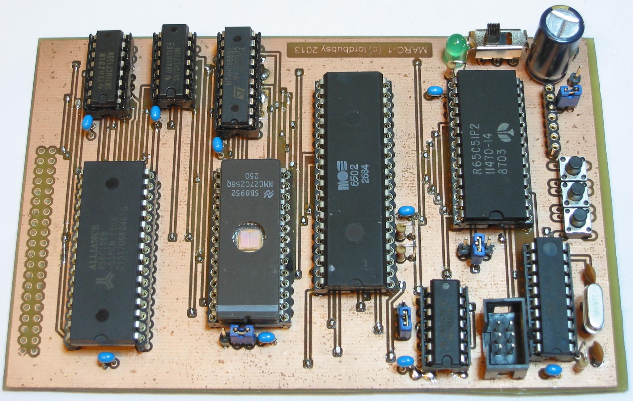

BTW, I don't see a bypass capacitor near the EPROM. An EPROM generates a large transient when /OE is asserted.
They’re just shy and hid themselves :)
Something else to consider is that fill planes (aka ground pours) are detrimental to high speed digital circuits.
I routed the whole board except for GND and VCC. After that I chose GND (because of lesser air wires) to route by hand and leave VCC. Then I filled the back and top with a polygon plane, and connected both planes to VCC. There were only three VCC air wires left to be routed. If I’m correct, then every polygon is connected to VCC leaving no floating polygons. Perhaps I interpreted it wrong, but I thought this was a good thing to do. So I’m confused.
We have a topic around here in which the discussion centered on internal ground and power layers vs. filled planes vs. nothing.
That’s the thing, I read so many different views of the topic...
Marco

Of course, multi layer boards with dedicated ground planes are better. But that's not an option for home made boards, so the choice is between boards with a few ground traces, or boards with ground pours. Ground pours have an advantage over ground traces that they allow return current to flow closer to the signal trace, reducing the magnetic field. Of course, this requires that the ground pour is not cut up into islands, but continuous over the board. This can be achieved by using ground pours on both sides of the board, and attaching them to each other wherever you can.
In addition, ground pours work very well as heat sinks, and they require less etchant.

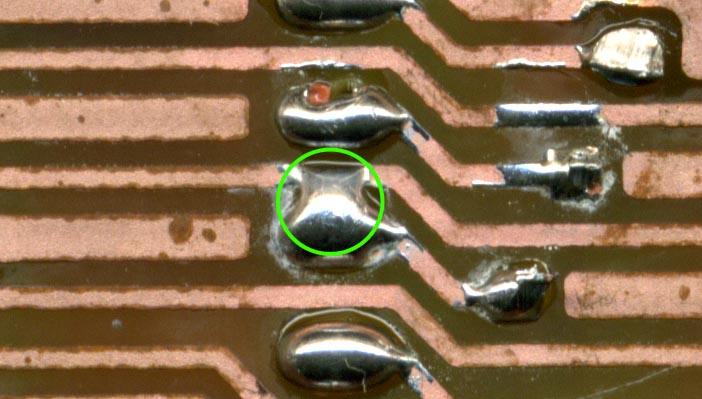

I programmed the ATtiny a week ago and checked for all VCC’s and GND’s. then I installed all chips but unfortunately my MARC-1 didn’t work. To be honest, I didn’t expect it to, at least not right away.
OK, all IC’s pulled out and comparing the eagle board layout with the PCB. That way I found *SEVEN* unsoldered connections. ALL of them were at the top layer on IC sockets.
Result, MARC-1 not working.
Then I rebuild the entire computer on breadboard for comparison, which also didn’t work. Now I began to question the design. On a separate breadboard I rebuild my first design with 32k RAM, 16k ROM and I/O at $8000. I had to have something working! This one ALSO did not work. And I worked really careful and slow. After some measuring I found a faulty jumper wire. It was brand new. :roll:

RES, RDY, IRQ and NMI were high. There was a clock at CPU pin 37 and PHI2 at 39.
I installed the ATtiny, the 74HCT74 and the MOS6502 and connected %11101010 to the data lines of the ACIA. I checked A15-A0 with the scope. They toggled between high and low, each with double frequency. Except for A5 which was high all the time.
I made a scan with 1200 DPI and searched for the short. Seems I shorted A5 with D6 with a very nice blob of solder! :oops:
Then I installed the 74HCT00, 74HCT688 and an EPROM with a test program which jumps from $C000 to $FF00 in a 2 second interval. I checked A8, A9, A10, A11, A12 and A13 for toggling.
After that I installed RAM and used a program which jumps from $C000 to $1000 in a 2 second interval. I checked A12, A14 and A15 for toggling.
Then I installed the 74HCT138, the ACIA and connected the UART correctly.
BINGO!!!
After the "week of hell", MARC-1 finally works. :D
Urk! That's where solder mask comes in handy. Don't know how you'd create one on a homemade PCB though.
