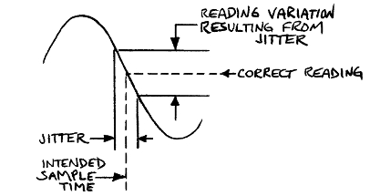

I delayed in posting this response because I realized I had a small error in my RMS jitter numbers that I needed to correct on my potpourri web page.  Some of what's below has been at least partially addressed above but I'll post it anyway as it may still be helpful.
In the case of something like a printer port or RS-232 port, there may be lots of leeway in timing to service the interrupt after it hits, and you may do just fine polling it once in a while instead of using the interrupts.  As long as you take care of it before the next one comes in, you're fine.  The requirements are pretty loose.  Actually, in the case of a printer port, you can delay service as long as you want, and it won't have any significant effect, since the printer will patiently wait for the next data.  It will probably still be printing data from its buffer while it is waiting anyway.
However, what might be a problem is that every single program you write now has to have polling places in it to check the port or other peripheral that might need service at any time.  If you use interrupts, then once your interrupt service is set up, the next program you load can be oblivious to the servicing.  The only other way around this is to have a multitasking system where a task services the port.  That is still not suitable for fast response times though, and, if you have preëmptive multitasking, it will use...here it is...timer interrupts!
When I do the audio sampling however (or any fast analog sampling-- it doesn't have to be audio), the exactness of the timing is very critical, so you can't just do another sample just any ol' time it's convenient within a wide window of time.  The exactness of the timing is more important than the amount of response time delay.  Jitter is how much the sample timing "rattles around" on each side of the exact ideal time.  Jitter causes audio distortion and noise, so it is desirable to minimize it.  In professional digital recording equipment where they want 16-bit (or more) performance to 20kHz, they go to great lengths to minimize jitter in the sampling clocks.  In the case of the 65c22 using the time-out period of T1 (timer 1) to produce a train of very evenly spaced interrupts, the jitter of the crystal-controlled system clock that runs it, and the aperture jitter (ie, the timing sloppiness of the sample-and-hold circuit in the A/D converter) can easily be dwarfed by the fact that there will be a variable number of clock cycles left to finish the currently executing instruction before the interrupt sequence can start.  So with interrupts on a 6502 system, the RMS jitter, for just recording, or just playback, is about 1.8 clocks, and 2.6 clocks for the entire record-play combination, which is a little over one-half the average instruction time.  (Wait states would make it worse, which is a reason I don't want to use them.)  Without interrupts, there is no way of achieving that kind of timing accuracy, let alone while running a program that does something else useful, unless you use separate buffer circuitry that clocks the samples in and out at an independently controlled rate so µP instruction length and progress won't affect it.  Buffer circuitry like this would often be used with DMA which further complicates things.
The number of bits of resolution in your A/D or D/A converter refers to voltage precision (and hopefully initial accuracy too), while the jitter refers to timing accuracy.  Jitter has the effect of reducing the number of bits of accuracy (particularly in high frequencies), thus producing noise and distortion.  This diagram illustrates why:
I cover this matter of jitter and effective number of bits further on the circuit potpourri page at http://wilsonminesco.com/6502primer/potpourri.html#JIT (where I just made some corrections in the calculations, since my earlier numbers were slightly too optimistic).
