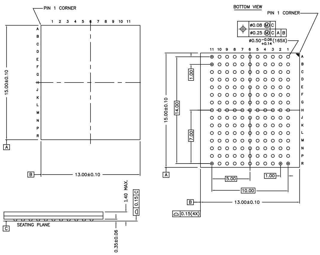

Neither would I:
FBGA165 sure isn't a hobbyist friendly package, the pads are below the chip (between the chip and the PCB).
From the drawings, that's a field of 11*15 pads, pads have 0.5mm diameter, 1.0mm distance from center pad to center pad.
There is a story that hobbyists had soldered something like that in an oven, but at 200€ per chip that's pretty daring.
Trying to solder thin enameled copper wire to 165 pads max. "dead bug style" also would be pretty daring.
On the other hand, getting the chip soldered into the PCB by the PCB manufacturer would feel like cheating. ;)
