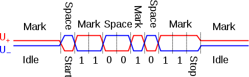

If these specs aren't enough, you can go to RS-422 or -485 which are differential (balanced), and the output can come from 5V or 3V drivers since the inputs can tolerate up to 6V and you only need 200mV difference between the two wires to get a valid logic level. Here's the idea, showing transmitting $D3:
RS-422 and -485 can go both much farther and much faster. RS-422 can do 10Mbps at 40 feet, and RS-485 can do 35Mbps at 33 feet. Both can go at least 90kbps at 3/4 mile. A rule of thumb for RS-485 max speed versus cable length is that the speed in bit/s multiplied by the length in meters should not exceed 10^8. Thus a 50-meter cable should not signal faster than 2 Mbit/s.
