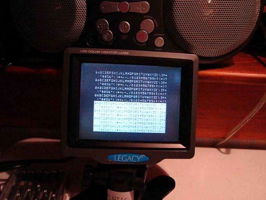

PostPosted: Sun Aug 28, 2011 8:52 am
Joined: Thu Jul 22, 2004 11:46 am
Posts: 43
Location: Sweden
The MC6847 has an internal character generator and a character ROM generating 64 different characters.
The following picture shows you the characters.
The first character '@' is obtained by storing a 0 in the video memory, a 1 for the letter 'A' and so on. To convert an input ascii character would be as simple matter of subtracting an offset from the ascii character and storing it into memory.
Any scrolling that needs to take place will have to be implemented in software by simply moving everything from the 2'nd line and onwards, 32 bytes down in memory. The device have no support itself for doing that. In fact, the only thing programmable is the control input pins on the device, and that is only affecting graphic modes, inversion and color space. My schematic shows you how you can connect these signals.
