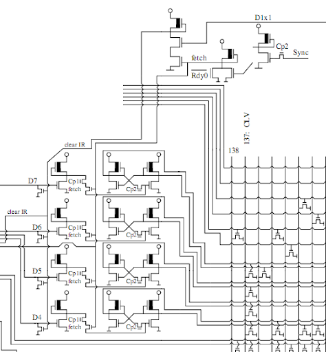

To add to your ideas, Jeff, I had another look at Beregnyei's giant schematic
Here's the logic which clears the IR - as you suspect, it uses SYNC as a qualifier:
(picture only shows one half of the IR but the other half is identical)

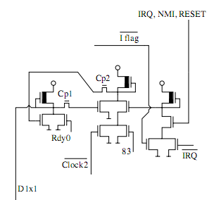

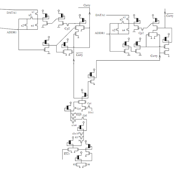

The signal D1x1 is doing all the work. It's also used to control the PC incrementer (although the circuit for that doesn't look quite right to me)
D1x1 is the output of this little collection:
and you see PLA output 83 is one of the inputs, also Clock2 which is one of the six Timing Control signals - the other important ones being IRQ with the I flag, and a composite signal labelling IRQ, NMI, Reset. (Also Rdy0 which is a combination of RnW and RDY and turns up everywhere)
Lo and behold, PLA output 83 detects the 8 branch instructions. So they are treated specially, and deliberately so. Although I still don't quite see why.
(That composite signal is certainly a function of NMI, and I see BRK detection nearby, but I don't see IRQ or RESET, so something isn't quite making sense there.)
I think "this little collection" is the Interrupt-Acceptance-Flip-Flop I suggested. Although the designers' dynamic logic techniques (using gate-capacitances to store bits) make me reluctant to unravel the flip-flop itself, I'm sure D1x1 is the "IAFF" output signal. Referring to the complete diagram and following D1x1 around I quickly found where it gets gated onto bit 4 of the data bus. This is exactly as anticipated, since, when the interrupt pushes the processor flags to the stack, it is the BRK bit, bit 4 in the flags byte, which indicates -- by being 0, actually-- that the BRK is of the hardware ("forced") variety.
The signal D1x1 [is] used to control the PC incrementer
Again this agrees with expectations. Hardware BRK is a zero-byte instruction but software BRK is 2-byte. I expect D1x1 allows PC to be incremented (or not) in order to derive the appropriate return address.
I think the "interrupt as an instruction" theory is amply established. (BTW my insight owes a lot to page A-11, Table A. 5.4 of the MOS Hardware Manual, where they pretty much spill the beans if you're paying attention.) Understanding the interrupt as an instruction shows us its limitations -- why, for example, the Conditional Branch logic might need to take heed. More on that topic some other time, maybe. I don't expect that the '02, the 'C02 and the '816 deal with the matter in exactly the same fashion. And the '816's ABORT introduces yet another flavor! (along with NMI, IRQ, RST and software BRK). Finally:
Agreed - I hadn't quite spotted that this is a flop, I was only seeing significant input signals. It's a bit of a strain to make sense of this stuff.
Yes, and 76 is another that activates for the 8 branch instructions. As for timing, my take is that 83 is high for all branch-instruction states except T3, and 76 for all except T1 -- do have that right?
I'm not sure - 83 and 76 are sensitive to 2 signals from Timing Control in that way but I'm not certain of the T states.
Timing Control looks like it has 5 bits of state(#). There's Clock1 as a signal related to Sync(*), and Clock2 is 1 cycle delayed version, subject to RDY.
And then there's a 4-bit shift register starting at SYNC and subject to RDY. The two Clock signals and the 4 shift register signals go into the PLA. The block diagram would have these signals as T0, T1X, T2, T3, T4, T5. (It has T1 as Sync but T1X to the PLA.) I think there's a subtlety here.
(#) Hmm, but the hardware ref manual mentions 7 states, T0 to T6, for instructions such as ABS,X and BRK.
(*) actually Sync0 which is perhaps an early version of Sync? Is this perhaps valid in the cycle before Sync??
