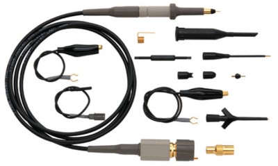

There are plenty of cheap probes from Hong Kong on ebay - but there must be room for doubt. Has anyone any experience?
Do they guarantee a minimum level of performance, including up to 400MHz or whatever you're interested in? (The probes should probably be good for more than speed of the scope, to make sure they don't limit the performance.) New ones can easily be $50 or $100 each, or more. This 400MHz one from Probe Master is $175 each.
I seem to remember my pair of 40MHz probes for my 20MHz oscilloscope was between $40 and $50 for the pair, who knows how many years ago.

Some of the new Tektronix 200MHz+ probes are going for more than $450US. Is this worth it?
The 'scope I bought on ebay had included what looks like 2 probes that were originally included with the scope. They're not being sold anymore, and since the scope is "ancient" a price comparison is impossible. And tech back then might not be up to par now...
My question is, does the Nyquist theory (2x oversample) apply to 'scope probe's too? Is it worth upgrading probes?
A DSO's sampling does not happen in the probes themselves [Edit: It seems that it does in the ultrafast scopes, beyond half a GHz or so; does anyone know?], so I suppose it's just a matter of remembering that the specified maximum frequency is usually at -3dB and the phase shift that goes with it (beyond just the time delay that the length of cable produces which is not a problem), and deciding whether you want to put up with that added to the scope's high-end drop-off or if you want to spend more to get the probes' limit up higher and out of the way.
My 20MHz scope with 40MHz (IIRC) probes does actually show a 70MHz signal, but very attenuated, and of course a square wave looks like a sine wave. IOW, the probes don't have a sharp cutoff frequency or alias all the frequencies that are beyond a certain point. But although they'll show that signal, it's worthless for anything but confirming that there is a signal and seeing the approximate period. (Actually I use my 512MHz frequency counter for the period or frequency though, which interestingly enough can also go beyond 512MHz, in spite of the fact that I originally thought that was a limit on the digital counter registers.)

I meant if one had a 'scope stating 200MHz, would the probes have to be certified @400MHz in order to properly see the 200MHz square wave signal? or did someone say 10X?!
The "10x" setting on the probe has to do with the voltage; ie, 1V will show as 0.1V on the screen. However, a square wave has all the odd harmonics (and a little bit of the even harmonics if the duty cycle is not 50%), with amplitude decreasing as you get into higher harmonics. If you have a 20MHz square wave, and you took out all the frequency content above 20MHz, you'd see only a sine wave. If you left the 3rd harmonic in and took out all the frequency content above 60MHz (the 3rd harmonic) without affecting the amplitude or phase of 60MHz and 20MHz, it would look like it's making an effort to be a square wave, but a pretty lousy one. If you could take out everything above 100MHz (the 5th harmonic) without affecting the amplitude or phase of the lower frequency components, it would improve further, but it's not going to look really square until you get to at least 180 or 220MHz (9th or 11th harmonic). So yes, if you want to get a good representation of a square wave at a particular frequency, the oscilloscope should be good to at least ten times the fundamental.

I looked up the probes that came with my scope and found they were 40MHz probes not even made for the scope! I had assumed they were OEM for the 2440. Forgive me, I am abit slow... The correct Tektronix 400MHz probes go for ~$150ea. used which isn't too bad. I'll be ordering them in a few weeks.
