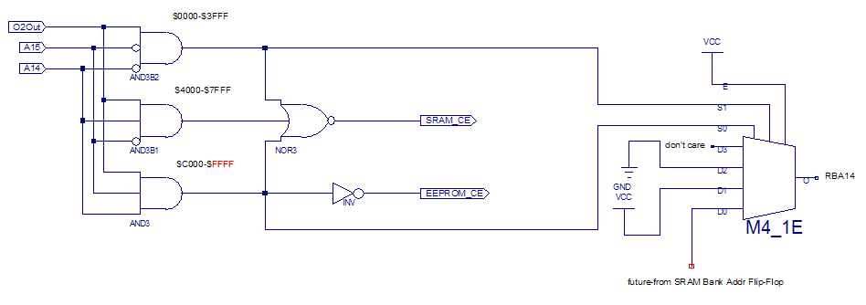

PostPosted: Wed Aug 11, 2010 10:13 pm
I've finally wired everything up... The memory map is here:
viewtopic.php?t=1370&start=190 , I divided the 64K into 16K blocks to keep it simple.
The address decoding scheme I'm using is logical but isn't working. I'm failing to understand why, but I think I know, in part because I am bad with timing diag's. So let me thank anyone ahead of time for any help they can offer!

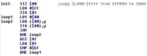

The first piece of software that runs, after a /Reset, copies $C000-$FFFF from EEPROM to SRAM using indirect indexed w/2 variables in zero page, so the multiplexers I'm using for A14-A20 at the 2M SRAM are switching from all zero's (for $0000-$3FFF) and all ones (for $C0000-$FFFF) when the program is running, and I'm thinking this is where my problem lies, but am unsure why.
Something is running, because I see the address and data lines switching on the 'scope...
Some facts:
The CPU is running at a conservative 2.5MHz since the access time for the EEPROM is 200ns.
Noise levels measure at different grounds are ~30mV, with everything running @3.3V. I don't think this is a problem. A concern though, since the
SRAM and display each take close to 300mA and everything is wirewrapped. Volts at each IC are in spec and clean looking.
I would like to know if I should pursue this idea further. Conceptually is it sound? or should I go on to another idea?
Last edited by ElEctric_EyE on Wed Aug 11, 2010 11:23 pm, edited 2 times in total.

PostPosted: Wed Aug 11, 2010 10:52 pm
Posts: 1748
Location: Sacramento, CA
Without seeing the actual decoding logic, or the init code, I will try to describe what I understand should be happening.
You say when the cpu addresses $C000-$FFFF, that SRAM is addressed to $1FC000-$1FFFFF.
Also, your ROM is addressed so that cput addresses $C000-$FFFF map to $7C000-$7FFFF in ROM.
Addresses in $0000-$3FFF always map to $000000-$003FFF in SRAM (for reads and writes presumably).
Do you have a control register in your CPLD that defines where reads come from vs. where writes go to, or are you using some other method?
After restart, your ROM must be mapped into Reads to address $C000-$FFFF or else your startup code will never run. If Reads are coming from SRAM, then you are most likely executing invalid code from uninitialized SRAM.
I would guess that if you can map writes into RAM while reading from ROM, that a simple
     lda $c000
     sta $c000
     lda $c001
     sta $c001
sequence would move ROM to RAM, then writing to a control register to set Reads from RAM vs. ROM, would do what you want.
Can you provide a little more info?

PostPosted: Wed Aug 11, 2010 11:04 pm
There are different ways you could proceed, but if I were in your shoes I'd temporarily alter this block move code so it moves the first byte... then continues to move it again and again, forever. The cycle-by-cycle execution of the loop will be exactly the same every time, and that means your 'scope can produce a stable pattern and show you what's going on. Sync the 'scope to the R/W line (which goes low for one cycle only during the loop). Adjust the timing so you can see the entire loop displayed, 15 or 20 cycles -- whatever. Then go poking 'round on the other address and control lines, and verify they're doing what you THINK they're doing, particularly on the cycles that do the data read and write.
For me, this technique is Standard Operating Procedure with a new board I'm just "breathing life into" for the first time. (It's exciting -- I envy you!!) Anyway, the point is to take the (complex) boot process (which is hard to test), and isolate something within it that is SIMPLE to test.
It's true you may have a noise issue due to all the outputs switching on that multiplexer, but before you worry about slippery problems like that, make sure there's not anything basic wrong, like a logic error.
Is the 200ns access time for the EEPROM spec'ed at 5V, even if it can run at 3V? It will definitely be slower at the lower voltage.
The 300mA does seem very, very high. Is it possible there's bus contention? My workbench computer which runs at 5MHz and the smaller one beside it running at 1MHz together take about 165mA, and some of that goes to RS-232 line drivers, op amps, and annunciator LEDs; and the clock oscillator for one of them is one of those very power-hungry crystal can oscillators that takes about 70mA.
Addresses in $0000-$3FFF always map to $000000-$003FFF in SRAM (for reads and writes presumably)....
Daryl
Exactly right.
8BIT wrote:
...Do you have a control register in your CPLD that defines where reads come from vs. where writes go to, or are you using some other method?...
Daryl
For the EEPROM to SRAM copy, both are /CS'd and read simultaneously. The /OE controls which one the CPU sees. When writing, the EEPROM is unaffected. This portion I've completed successfully in the last stage... I can provide a small schematic for that portion as well, but it's pretty much like this:( viewtopic.php?t=1370&start=152 ), focus on the upper left. The 4 bit counter controls CPU /Res, SRAM /OE, & EEPROM /OE. I've slowed the count WAY down to make sure the CPU has plenty of time to copy 16K.
Garth, I'm using this EEPROM ( http://www.atmel.com/dyn/resources/prod ... oc0383.pdf ), everything running @3.3V right now, except the oscillator@5v. But that has p-pV of 2.5V. And this SRAM ( http://www.cypress.com/?docID=22950 ). Yes, 275mA!
Jeff, I'll try your idea, soon I think. Definately before I give up this attempt.
Here's the address decoding, only 1 MUX is shown for RBA14 (SRAM bank addr). According to the FPGA report the delay is <20ns from Ax to RBAx:
Copy software, pretty simple, it stays within boundaries. It should take about 2-3 sec? to complete @2.5Mhz:
Edit: added software pic & 4bit counter is upper left (correction), not upper right.

Hmmm. "O2OUT" is Phase Two? If so, it looks to me as if the RBA14 signal (SRAM bank addr) can change state when phase 2 goes true. That ought not to be the case; address lines on the SRAM should already be stable by the start of phase 2 (ie, when CS activates). This might not be what's causing your difficulty, though.
Garth's suspicion about bus contention rings true... FWIW, my oscilloscope suggestion can reveal stuff like that, whether due to wiring errors or design issues. But I haven't described it in proper detail I'm afraid.

PS: Is there anything else on the data bus? (Maybe a 6522 or other IO device?) If so, I hope it only gets read-enabled within addresses 8000h-BFFFh. Looks as if you planned it that way.
 Post subject:
PostPosted: Thu Aug 12, 2010 11:33 am
Hmmm. "O2OUT" is Phase Two? If so, it looks to me as if the RBA14 signal (SRAM bank addr) can change state when phase 2 goes true. That ought not to be the case; address lines on the SRAM should already be stable by the start of phase 2 (ie, when CS activates). This might not be what's causing your difficulty, though...
This type of address decoding I've used successfully, in my last stage. It ran 6MHz. I'm all ears for a better type of decoding though.
The only I/O device I have at this point is the display @$8000,$8001. As an experiment I took phase 2 out of the decoding for it, and it was receiving data, erroneously, but the display was changing.
I'm pretty sure everything is wired correctly, I've doube, triple checked my wiring, rechecked the QFP to BGA adapter pinouts, and ohmed out a few pins direct from each of the IC's (54-pin TSOPII SRAM & 100-pin VQFP FPGA) to the wirewrap pins. To make sure my soldering is 100%, I guess I should check all pins, but before I spent that much time...
So the idea of "Locking" 16K blocks, which is really bank switching, is not a problem? Even in the middle of a program?
