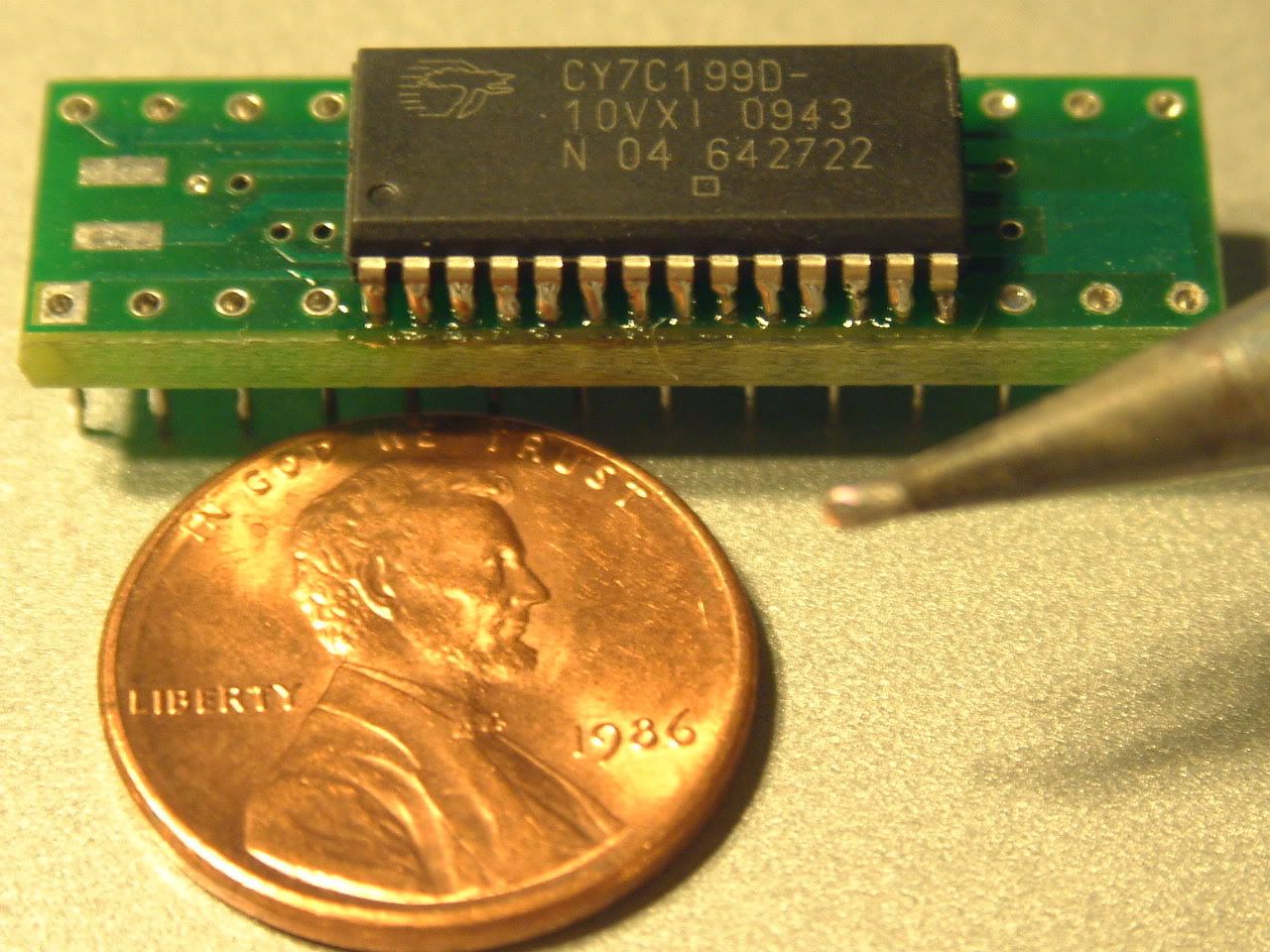

...and other manufacturers offer adapters to make SOICs and other SMT parts able to be plugged into DIP sockets. Here's one from Aries, which I've used:
I finished soldering this 32Kx8 SOJ last night. Not too bad. The solder from one lead wound up sticking to an adjacent lead. I was worried about heat so close the the IC leads, so I used a solder sucker, and it fixed it up real quick. Here's pic below. Don't be intimidated by SOJ, although DIP socket adapters are $5 each. This is my first run in with a 28-pin SOJ.
Looks pretty clean, actually. Better than I did on the POC's SRAM.
All it takes is a steady hand and some patience. Helps to also have a real small soldering iron tip. :)
Don't worry about it. At a previous job in the mid 1980's I occasionally scanned power transistsors with an IR microscope, and at the extreme, saw them operating (not just in storage) at over 350°C. I don't remember how far over, but 350°C is 660°F, and it was more than that, with this power transistor dissipating hundreds of watts. With metal migration and other issues, it would not have lasted very many hours doing that, but the fact is that it did not destroy it. I think the temperature they used to braze the die down to the metalized ceramic substrate was higher than that. (The super high operating temperature resulted from a tiny void in the braze job.)
When you put the soldering iron up to one lead, the rest of the package will give cooling, and the temperature gradient will keep the die (the actual chip inside the IC) from getting very hot. You're not applying the soldering iron directly to the die. Between the leadframe and the die there are bondwires to connect, and those are usually .001" to .002" in diameter. When they specify for soldering that the temperature be held below X degrees for Y seconds, they're referring to automatic production soldering that gets the whole thing up to that temperature, applying heat even to the package itself, not just a few leads at a time.
As an example, here's a note from the Maxim MAX220-243 data sheet:
Lead Temperature (soldering, 10s) (Note 3) .......+300°C
300°C is 572°F. As Garth pointed out, hand soldering isn't going to impose thermal loads any more severe than reflow in an oven.
