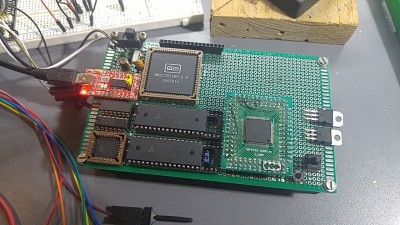

After some modifications to my board, I finally got the delay I was trying to get.

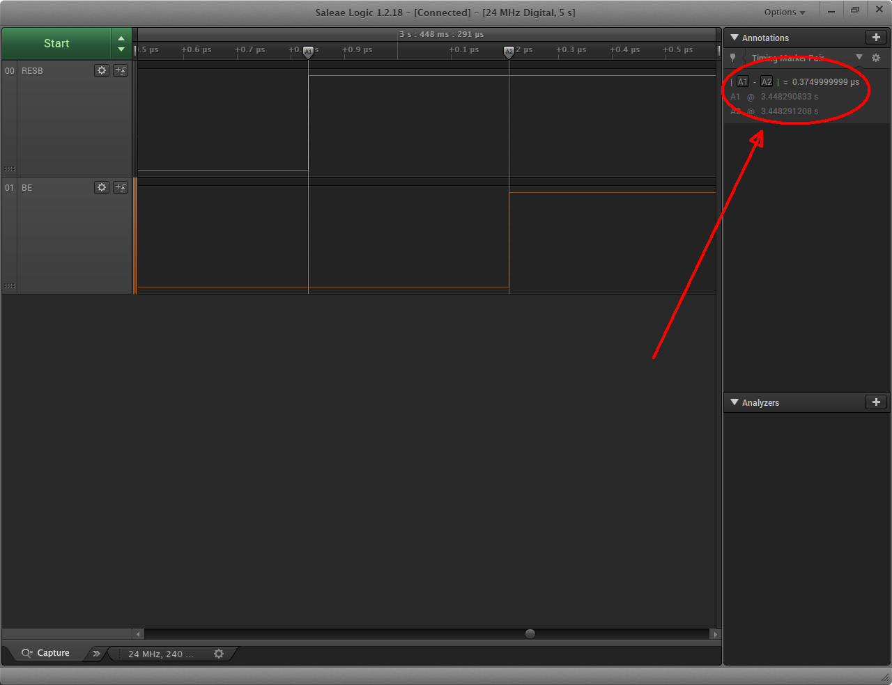

I added another 74HC00, to be able to debounce the best way they say, the reset circuit. I added a SPDT non-locking push button to get the RESB line go low and high after releasing it. And I put a RC network before the BE line so I finally got this 375ns (shown 0.375 us) delay.

The datasheet specifies that there is no max time of delay of BE after RESB for the emulation mode to be set and external memory used, instead of the internal one.
So I just can understand why it doesn't boot from the external chips... I'm doing wrong, or I'm misunderstanding the BE driven BCR setting.
