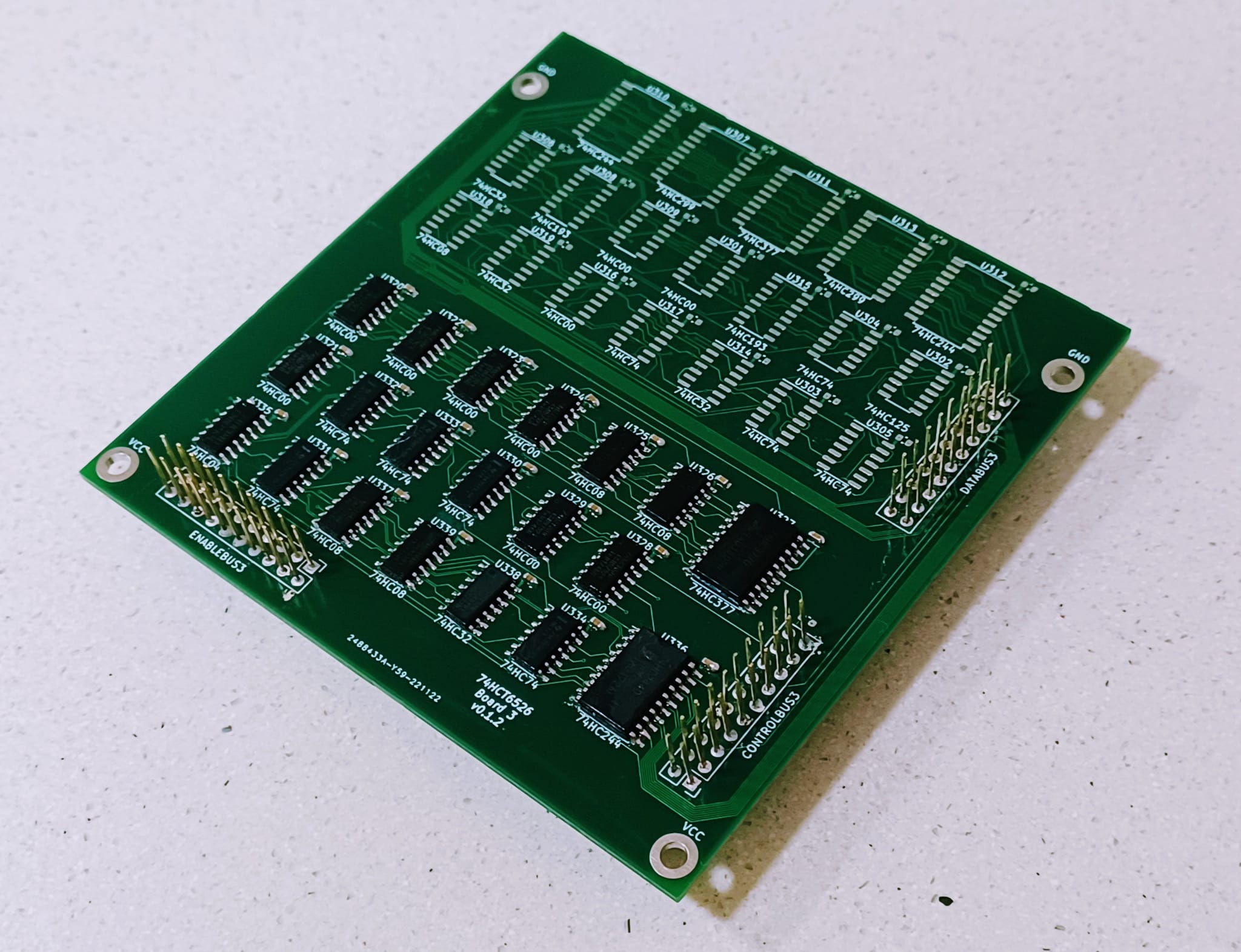

Hi all, I hope you're having a great start of the new year!
I want to introduce you to the newest member of the family.
File comment: ICR
B3, with ICR fully populated. The upper half of the board is the SDR, but I won't be soldering that in until ICR is validated. There are a couple of expensive ICs there (Two 74299 shifters) which I'd rather not to solder until I know the ICR works fine.
File comment: Full Stack with ICR
And... to my great surprise... it does. I've been only able to do some minor tests, as I finished assembling the ICR just a couple hours ago. So far :
  • Interrupt mask can be properly set and cleared.
  • Timer A and Timer B interrupts work, and I'm proud to say, the appear cycle exact!
  • Flag interrupt it's not working for some reason. Could be a a bad connection or solder joint, as at first glance, I see nothing out of place in the schematic. Further investigation is required.
  • TOD and SDR interrupts can't be tested yet, as there's no TOD or SDR to be fire the interrupt. Hopes are high, given the circuit for them is pretty much the same as TA and TB
  • Timer B bug will require extensive testing. Theres a 50/50 chance of it being "fixed". If I've managed to replicate it, I'm afraid I will also have a Timer A, SDR, TOD, and FLAG interrupt bug.
This is truly a huge milestone. I will test as soon as possible the full stack on a real C64, as now I have pretty much everything needed by the computer to work properly. TOD, SDR and Flag interrupts are not used a lot.
Today, after 4 and a half years of work, I'm 99% sure this project will succeed!
Cheers!

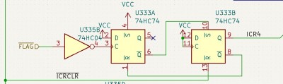

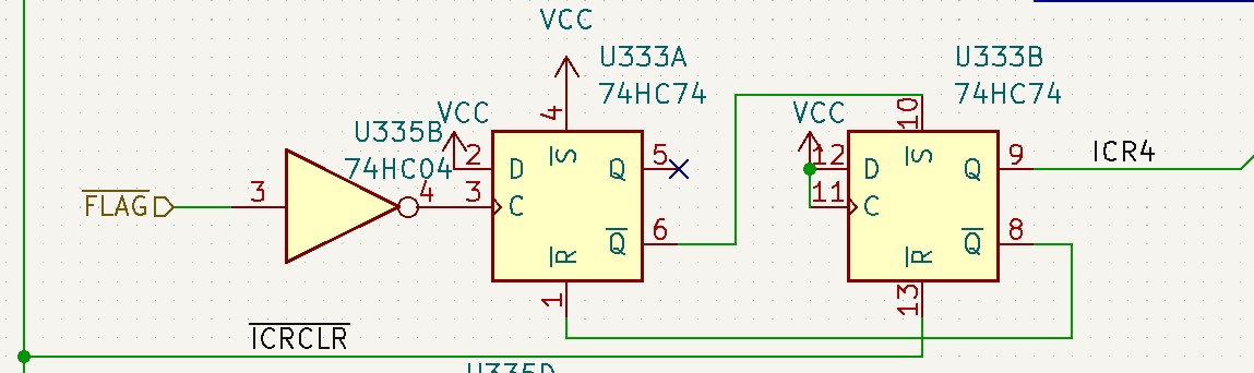

I figured out what's wrong with the flag interrupts.
I was using this (somehow unorthodox) circuit for edge detection :
When /FLAG went low, it sent a clock pulse into the first DFF, setting it to high. At the same time, /Q was fed into /SET on the second DFF, and /RESET of itself. This sets second DFF to 1, while resetting first one to 0.
I've used the same setup for CNT edge detection on the timers and it worked with no issues, but somehow, it's not working here. Connecting the first DFF /RESET pin to /Q of the SECOND DFF solves the problem, and it's probably a more correct approach.
A quick fix on the PCB, and now FLAG interrupts are working as expected. Also... they're also cycle exact. I'm getting used to this!

There were two issues on the input stage. First one, the reversed flip-flop I mentioned earlier. Second one, same issue as with the FLAG edge detector in the ICR. The circuit I used in the Timers to detect CNT edges:
won't work here. The /R input for the first pin, has to be connected to the /q input of the next flipflop:
The only difference between this board and the timers, is that on the timers, FFs are clocked by PHI2. On the SDR and ICR, they're clocked by /PHI2. As the sending CIA is on the same PHI2 as the receiving CIA, I think the edge arrives precisely at the rising edge of /PHI2, so it's missed by my circuits. It works on the timers by mere luck, so I will change that for a more correct edge detector.
