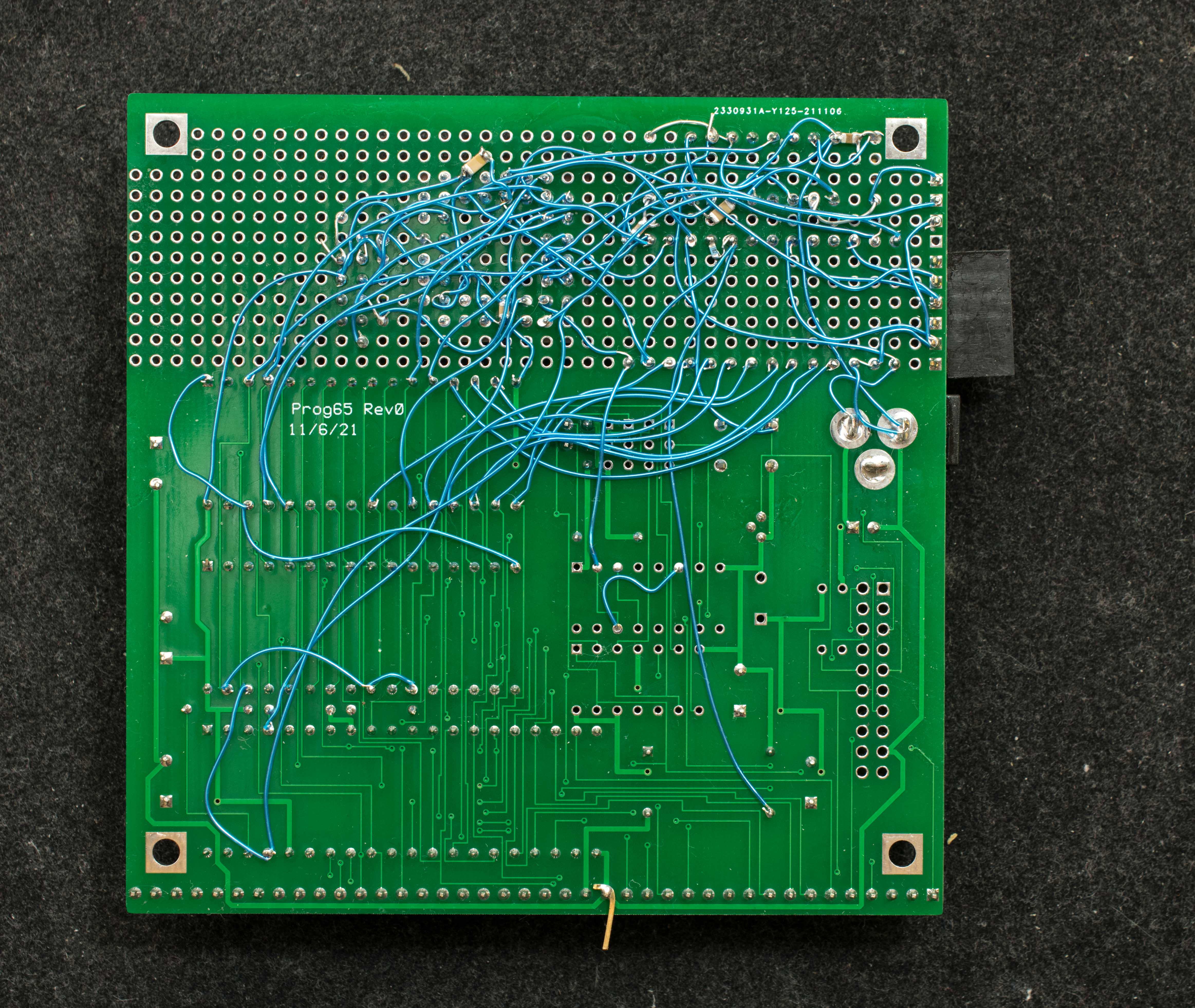

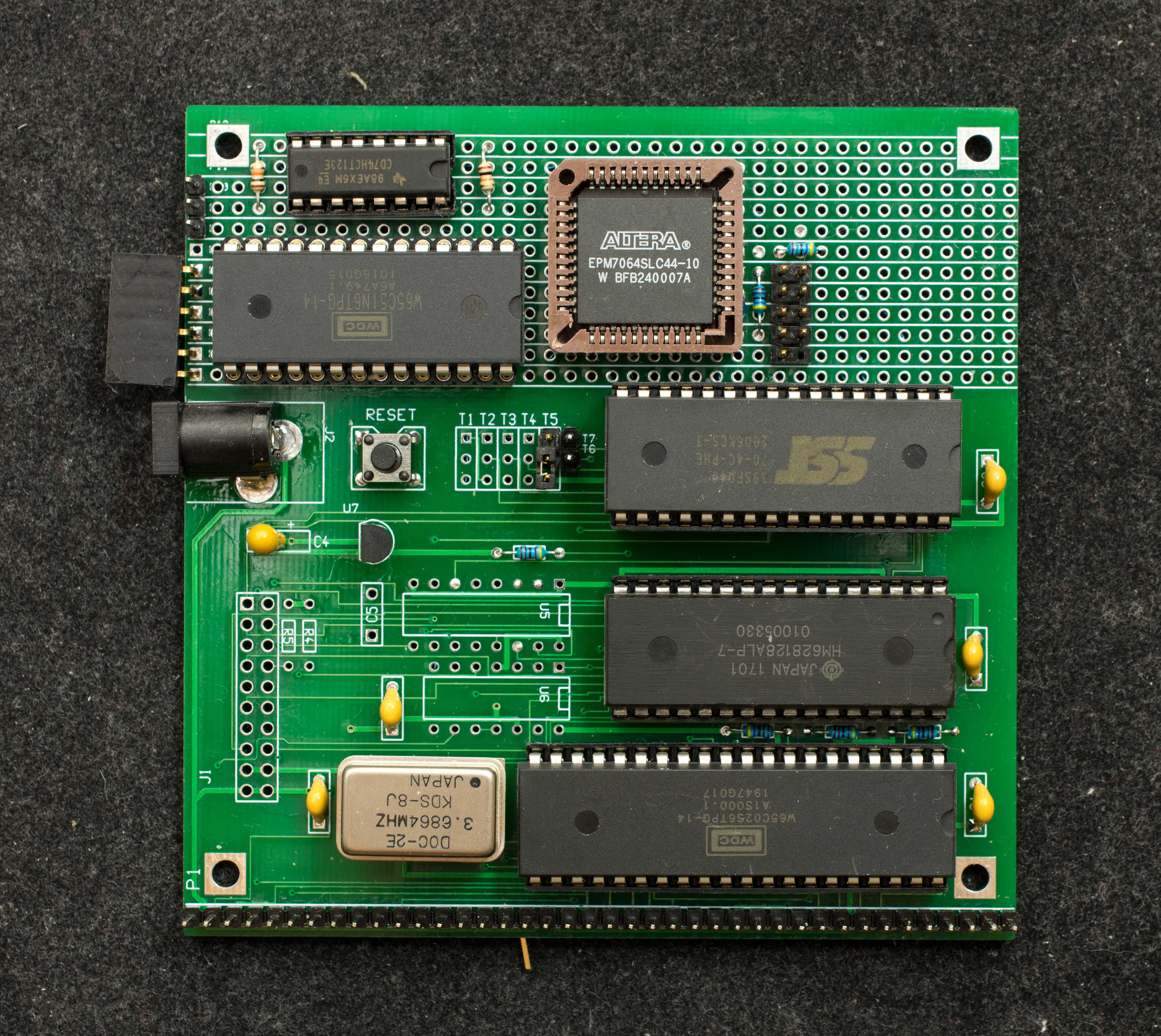

I received four W65C51 ACIA last week and built up a board to explore ROMless bootstrapping with ACIA. Because of my inexperience with W65C51 and plan to use features not well documented in datasheet, I use a CPLD as glue logic instead of discrete TTL logic. The CPLD allows me to change design easily, often without changing any wiring. Another baby step is configuring the board as a normal computer booting out of EPROM so I can checkout ACIA a little bit at a time.
The first obstacle I ran into is the W65C51 documentation is rather poor. The relationship between RxC, XLTI, PHI2 are unclear. PHI2 is system clock, that part is clear, but can I tie the same system clock to XLTI AND RxC? XLTI is nominally 1.84MHz, but I'm not sure it can be driven to higher clock.
Another obstacle is the ACIA transmitter does not work immediately after reset; it needs some kinda initialization first. The document is unclear, but somehow RTSB (an output of ACIA) needs to set low in order to transmit data out.
The one I'm worrying about is whether ACIA receiver works immediately after reset without initialization. I need that to work in order to bootstrap with ACIA.
PostPosted: Mon Dec 06, 2021 10:22 pm
PHI2 and XTLI are not related. XTLI is normally 1.8432MHz to get the standard bit rates, but I've heard of people doubling it to 3.6864MHz to get 38.4kbps with 1111 in the BRG. It's not guaranteed to work with 3.6864MHz, and I have not tried it myself, but apparently everyone who has tried it, with every brand, has had success. RxC is just 16 times the receive bit rate, regardless of how you come up with that rate. (Note that it can be an input or an output.) You'll usually have the transmit rate locked to the receive rate though (with control register bit 4 = '1'). If you input 1.8432MHz into RxC, you'll get 115.2kbps (which I do for programming our bluetooth devices for work). I've also done MIDI at 31.25kbps by inputting 500kHz from a VIA's PB7 toggled automatically from its T1 timeout in free-run mode.
The transmitter is automatically disabled if CTS\ is high. The receiver is disabled if DCD\ is high. The transmitter will be turned off if bits 3 and 2 of the command register are 0's.
Hardware reset leaves it in 8,N,1, 16x external clock, no echo, transmitter off, RTS\ high (ie, false), receiver disabled; so I don't think it will work for this particular idea.
PostPosted: Tue Dec 07, 2021 1:24 am
Posts: 1117
I believe you are right. W65C51 documentation does not explicitly said receiver and transmitter are disabled at reset. It says DTRB and RTSB are high at reset. My mistake is thinking DTRB and RTSB are programmable output discrete that do not reflect the internal state of the receiver and transmitter. Not so; if DTRB is high that means receiver is actually disabled and if RTSB is high that means the transmitter is disabled. So if I want to bootstrap off the W65C51, I'll need a way to jam a value into its command register immediately after reset. Sigh...

I'm not quite giving up on W65C51, yet. 6502 does something after reset and before pulling reset vector so that may be a window of opportunity to jam data into ACIA's command register. I'm glad I have a CPLD already wired in to explore that window of opportunity.

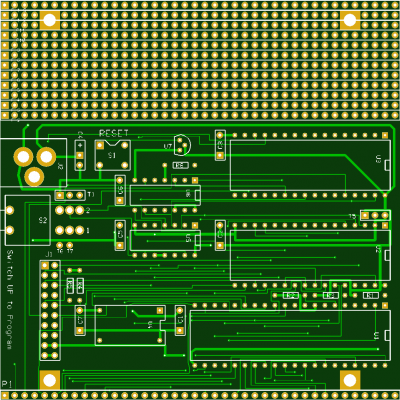

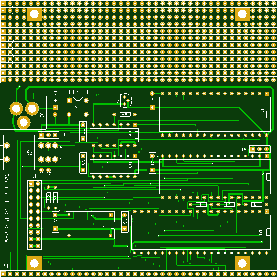

I'm still thinking about how to initialize W65C51 to receive data after reset, but the photo shows the design I sent off to JLCPCB. The design file for the prototype is documented here. It is a simple idea of using USB-FIFO to bootstrap and communicate so the programmer itself is quite simple with only RAM, 6502, a couple TTL logic, and a socket for EPROM. A toggle switch selects whether it is a programmer or a 6502 SBC. The pc board has plenty of prototype area to try other ideas. It fits in a Pactec CM5-125 enclosure.
