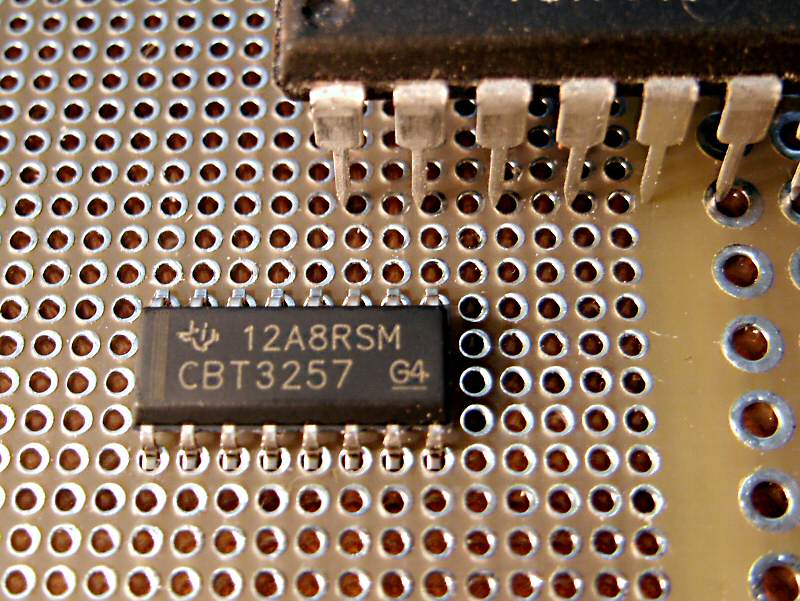

Most of the ABT and FCT series are produced in SMT packages, many being SOIC (50 mil). You won't find much in PDIP, but I don't see that as a limitation anymore. The SOIC packages are easily hand-soldered. If I can do it, all you younger guys certainly can! :P
Easily hand-soldered? Heck, you're doing better than I am if "easy" is the word that comes to mind! But the .050" stuff is do-able.
Although it's slightly off-topic, I will quickly mention that proto-board using .050" grid is available. Unfortunately the selection is very limited; I know of only two examples, the Vector 8021 and the 8028. The 8028 is actually a combo board with areas of .100", .050" and 2mm grid.
cheers,
Twin Industries has them too, and they tend to be much, much cheaper than Vector. I saw them at the local Fry's Electronics. See https://twinind.com/index.php/products/ ... ng-boards/ . The holes on .050" centers are too small to put regular WW sockets into though. Another alternative if you really don't want to make a custom board is to use the SOIC-to-DIP adapters. They tend to be expensive; but buying several would still be a lot cheaper than getting a PC board made.
