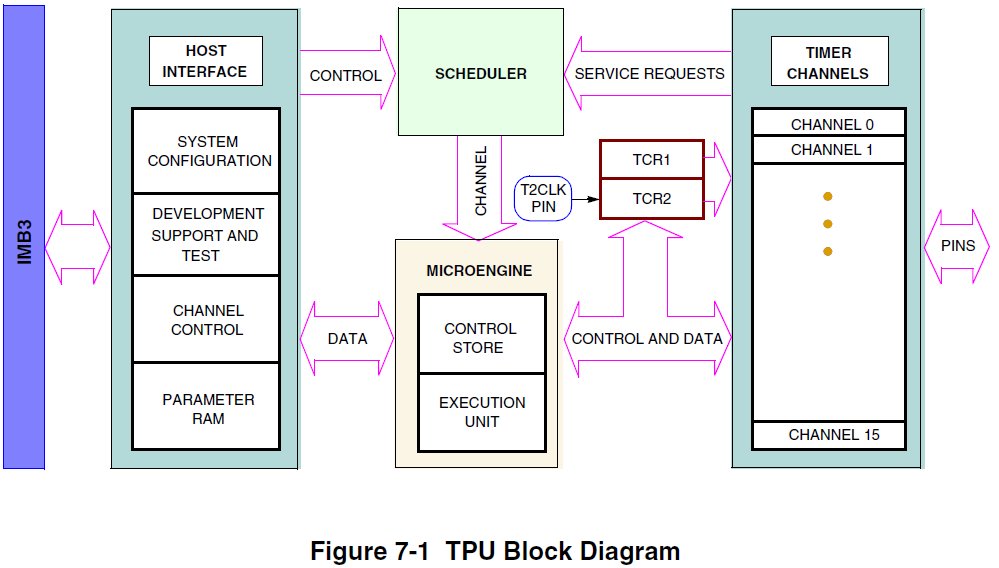

What made the 68332 such a big success was the TPU, "Time Processor Unit".
NXP 68332 product site:
http://www.nxp.com/products/microcontrollers-and-processors/more-processors/coldfire-plus-coldfire-32-bit-mcus/68k-processors-legacy/m683xx/32-bit-microcontroller:MC68332?tab=Documentation_Tab
TPU reference manual, seems to be not visible at the 68332 product site,
somebody better archives this file:
http://cache.freescale.com/files/microcontrollers/doc/ref_manual/TPURM.pdf
"The TPU is an intelligent, semi-autonomous co-processor designed for timing control.
Operating simultaneously with the CPU, the TPU processes microinstructions, schedules
and processes real-time hardware events, performs input and output, and
accesses shared data without CPU intervention. Consequently, for each timer event,
the CPU setup and service time are minimized or eliminated.
Figure 1-1 is a simplified block diagram of the TPU."
The A mask set (or original mask set) includes the following functions:
• Discrete input/output
• Input capture/input transition counter
• Output compare
• Pulse width modulation
• Synchronized pulse width modulation
• Period measurement with additional transition detect
• Period measurement with missing transition detect
• Position-synchronized pulse generator
• Stepper motor
• Period/pulse width accumulator
• Quadrature decode
The G mask set (or motion control mask set) includes the following functions:
• Table stepper motor
• New input capture/transition counter
• Queued output match
• Programmable time accumulator
• Multichannel pulse width modulation
• Fast quadrature decode
• Universal asynchronous receiver/transmitter
• Brushless motor communication
• Frequency measurement
• Hall effect decode

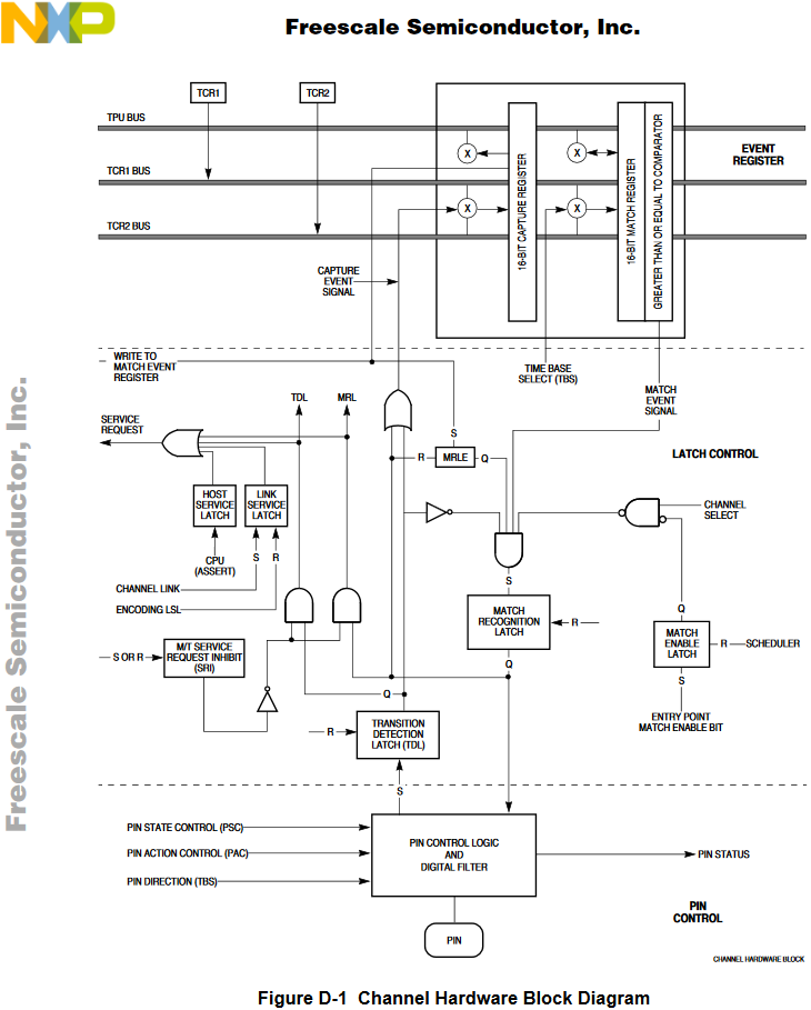

Block diagram for one of the 16 channels (one channel is tied to one I\O pin):
It's an interesting concept, and I hope that somebody from the FPGA section of the forum
might find the time for digging into it... someday. :)

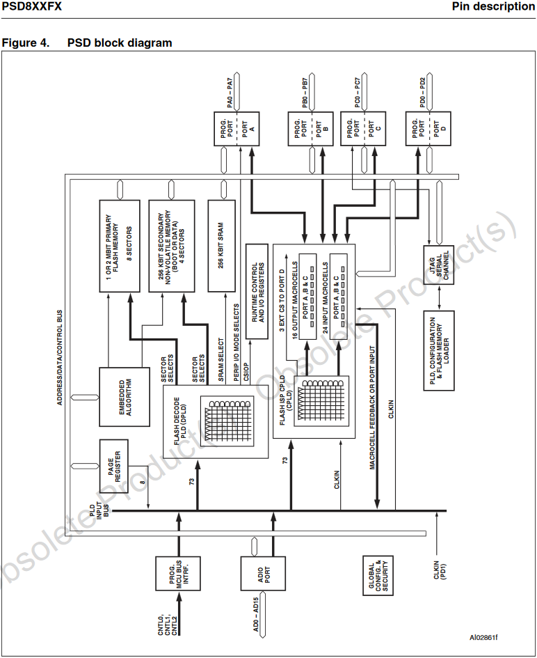

Somewhere above in this thread I had mentioned the 6530,
a chip with RAM, ROM, timer and I\O, so it was possible to build a little 6502 computer with only two chips.
I now stumbled over the PSD813 datasheet, that's also a neat chip with RAM, Flash, CPLD and I\O.
First manufactured by Waferscale, later manufactured by STMicroelectronics, unfortunately it's obsolete now.
Somebody better archives the datasheet before it disappears:
http://www.st.com/content/ccc/resource/technical/document/datasheet/eb/ab/40/d0/d5/3a/44/e4/CD00004948.pdf/files/CD00004948.pdf/jcr:content/translations/en.CD00004948.pdf
Unfortunately, I found no similar chip when searching the internet...
I have a data book and other literature from WaferScale Integration, from before STMicroelectronics bought them. It looks like they had really cool stuff. It looks like it's all gone now. Shucks.
