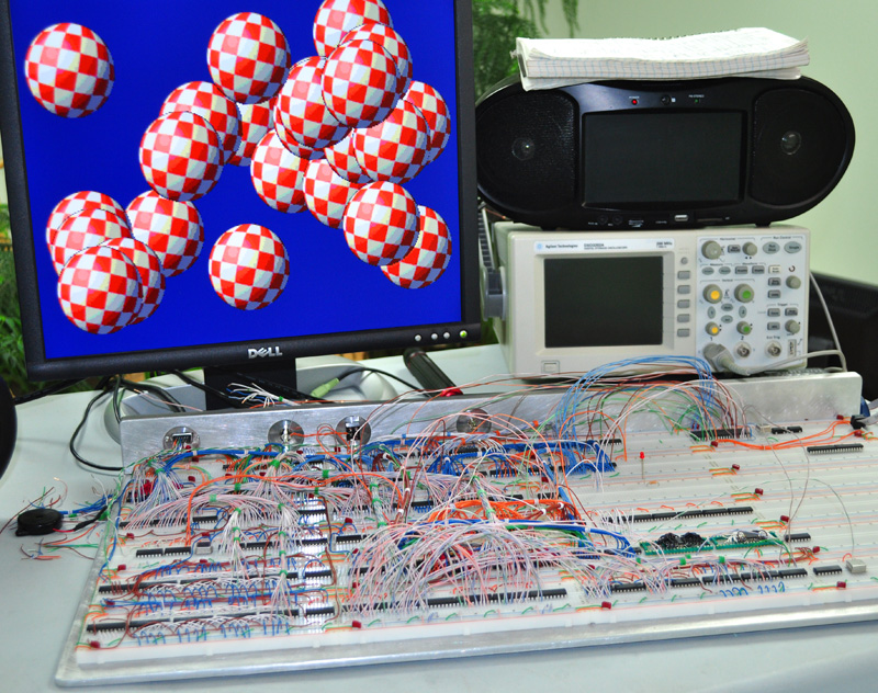

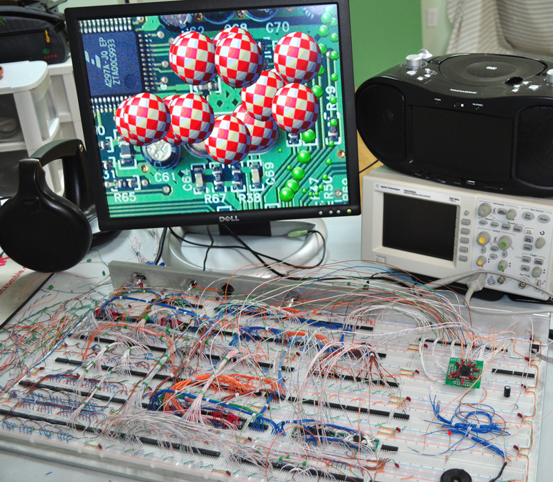

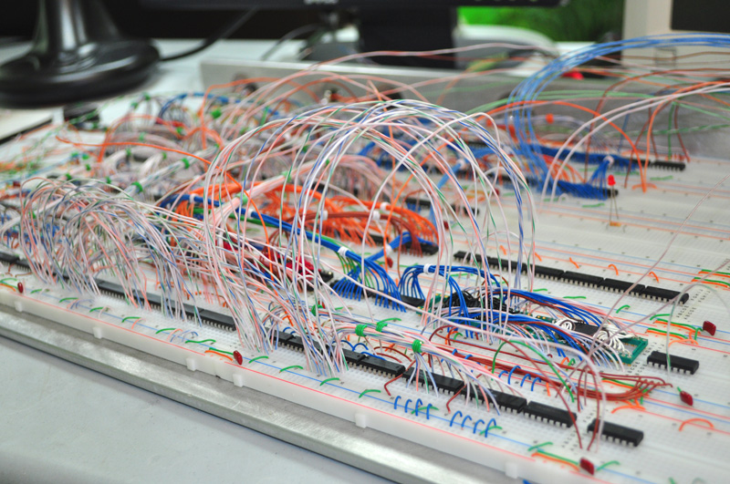

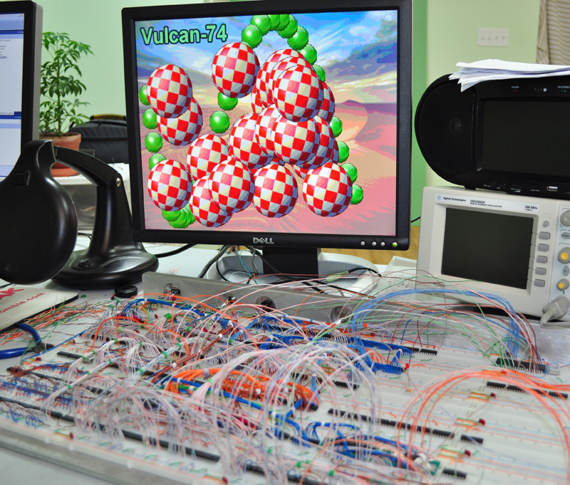

I had some time to test the Playfield Generator, and everything works as expected.
Because the test AVR only has 128K of program memory, I had to add another AVR to load the Playfield SRAM.
The competed system will load from a 4MB external Flash Memory (Game Cartridge), so memory will not be an issue.
So here is what is going on during a startup right now...
The Game Logic AVR triggers the Playfield AVR to dump a 400x300 image to the Playfield Memory.
When completed, the Playfield AVR just releases all of its IO, going invisible to the system.
The Game Logic AVR then loads all the Sprites to the Sprite Memory and then enters its Main Loop.
The Main Loop is just a simple C/ASM program that tells the GPU what to do with all the graphics data.
Because I am only testing the Playfield Generator, the wiring looks like hell for now...

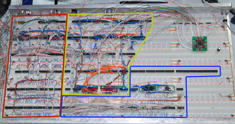

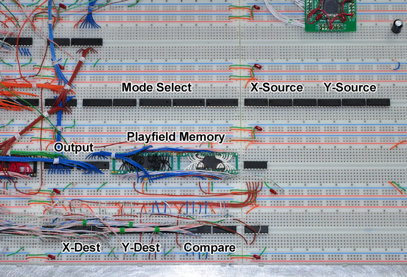

This is the new 1024K Playfield Generator.
That row of unconnected chips above the Playfield Memory will soon be the offset generator system.
The Playfield is 1024K of dedicated SRAM, which can be split into the following sizes for scrolling...
Mode 0: 1024x1024 - Square or static Playfield
Mode 1: 2048x512 - Good for horizontal scrolling games
Mode 2 : 512x2048 - Good for vertical scrolling games
I am currently only generating a 400x300 image, but will soon connect the scrolling subsystems.
Well, enough yapping, look what this thing can do already...
80 moving Sprites drawn over a 400x300 background!
Yeah... try that on your Tandy, Andy!

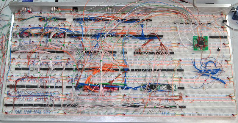

From here, I am going to take some time to get the "Glue Logic" under control.
The Glue Logic controls the way the CPU interacts with the board, and it is getting complex.
I am building this thing "on the fly", simply jamming in chips and wires, already knowing what will happen.
It's kind of like a second language now, so I have not even made a single schematic yet!
I want the 6502 or AVR to have an easy time talking to the board, so I will optimize the Glue Logic next.
For instance, rather than having a separate "Write Enable" for the Sprite and Playfield SRAMs, I may just make a select mode.
My goal is to keep the IO under 64 toggle bits, even when the 4 channel Sound Generator is done. It will be tight!

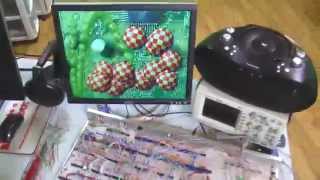

Here is a video showing the many improvements made recently...
https://www.youtube.com/watch?v=chACO3WNtg0

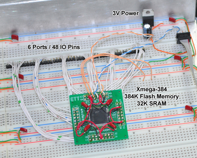

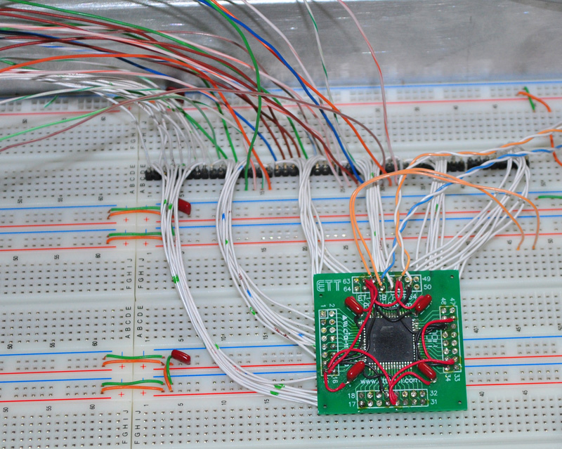

Well, I decided that it was time to deal with the mess of IO wiring scattered all over the board.
Vulcan-74 will probably need 64 IO bits before it is done (with sound), and I am already needing 36, just for the GPU.
Each line basically does something as it is cycled from high to low, so IO is actually very simple.
When I add the multiplexers, IO requirements will drop to under 16, but for testing, I need raw IO lines.
For this reason, I decided to remove the Atmega-1284s, and drop in an Xmega-384, which has 48 IO lines.
The XMega also has 384K of program memory, so I can simulate the cartridge memory much easier as well.
to use the XMega, which is only available in a TQ package, I resorted to my usual trick - more wiring!...
All testing can now happen from a single chip.
The XMega deals with IO differently than the ATmega, so I adjusted the assembly program to work.

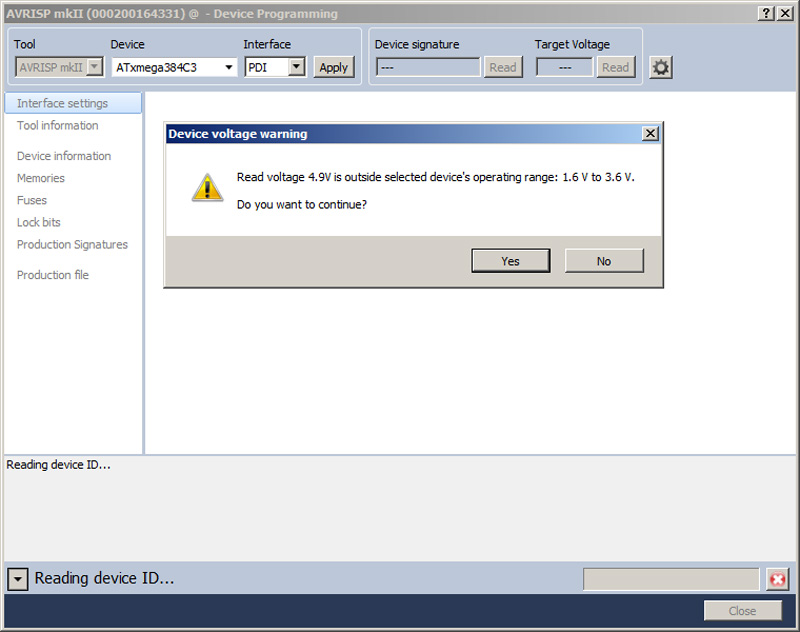

Also, the XMega is a 3.3v device, while Vulcan-74 is a 5v system.
Looking at the datasheets for the XMega IO vs the 74HC parts, I have found that I should be ok.
The XMega IO will put out 2.4v to 3.1v, and the HC logic needs a minimum of 2.2n on the input (just scraping by).
Since there are only a few inputs to the XMega, I will just drop a 10k resistor on those pins and let the clamping diodes deal with it.
If there are any IO glitches, then I will simply crank the XMega up to 5 volts, 1 volt beyond its maximum rating!
I know, I know... this blatant defiance of ratings will probably open a symmetrical temporal rift and swallow the universe!
Actually, I ran this same XMega at 5 volts for 3+ months on another crazy project I was testing, yet here it remains.
Anyhow, I am going to rewire everything and make sure the IO plays well with the XMega and then continue testing.
Once all subsystem are working, I will start on the multiplexed IO system.

3.3 volts was not enough to drive the 5v logic, especially on the sync and page flip IO lines, that reach 2 feet across the board!
No problem, though... I just cranked the XMega up to 5 volts and everything is working fine.
This is the same XMega I ran on a board for 3 months at 5 volts, overclocked to 72Mhz (yes, you read that correctly).
In the final design, there will be no abused ICs, but I am cool with this overloading for testing purposes.
I'm givin' 'er all she's got Captain, I don't know if she'll hold up!

The 3.3v test XMega is still running the balls demo, over-volted at 5 volts, and it has not crashed (2 weeks now).

Here is a current sitrep, showing where the board is at, and how real estate is currently divided.
The XMega-384 is running low on IO pins!
Since all of the IO from the various subsystems are not multiplexed at this time, the AVR being used as a "6502 stand-in" has to deal with 42 separate IO lines, and this is without the 32 more that the sound system will require! The IO will later be mapped to a 256 byte address block for the 6502, but for now I need a microprocessor with some serious IO ability, which is why I am using the XMega-384. Once the video section is working the way I want, multiplexing will be added and then the 6502. The sound system will be developed under 6502 control once one channel is working. All 4 channels are exact copies of one another, you know... SID style!
To deal with the Vulcan Logic being at 5 volts, I just over-volted the 3.3 volt XMega!
The PlayField Generator layout on the breadboard.
As things progress, I often move chips around to add new features that were not in the original plan. The PlayField Generator was actually not in the original plan, but will give Vulcan-74 some serious ability to make huge scrolling games without having to resort to tile mapping. The PlayField was going to be a 1024x1024 bitmap that can be scrolled to any position, but I decided to add a little trickery to make it size selectable between 2048x512, 1024x1024, and 512x2048. The Mode Select hardware is a 2-4 decoder that turns on one of the three 74HC245s, driving different pairs of high address bits to the counters.
X and Y Source counters are presetable 74HC193 counters, setup as 12 bits each. Using the Mode Select, each counter set can output 9,10, or 11 bits to the PlayField Memory, which is 1024k, addressed as a pair of bits between 0 and 11 btis in width.
X and Y Destination counters are 74HC590 counters that drive the Source Bitmap date directly to the 400x300 Back Buffer Memory at 20MHz. As these counters wrap at their borders, they advance or reload the Source Counters to their set values, which is why the massive bitmap can be blasted to the screen at any position. So it's kind of like looking at a huge poster through the end of a cardboard tube, you can only see part of the image depending on where you position the viewport.
The PlayField operation also clears the screen for the Sprite Generator, to redraw everything at 60 frames per second.
For a single color blank screen, it's just a matter of writing that color to 400x300 worth of the PlayField Memory.
Vulcan-74 Country and its 3 Provinces.
Vulcan-74 has grown into a very large Nation of silicon very quickly. It's almost funny when I originally planned to have both the video and sound systems all on the same breadboard! This entire board will be filled by the time I add the IO system, and the Sound System will require a board of about 2/3 the size of this one! It's going to be fun looking for PCB manufacture to make the estimated 18x12 sized board! I could make smaller boards and stack them, but one of my goals is to show off the entire board through a glass top cabinet, so a flat single PCB layout is the only layout I will allow. Oh well, I am not afraid to hand wire the entire system point-2-point if I need to.
As per the above photo, the board is divided into three subsystems...
[Red Sector = VGA Generator]
This is the VGA Video Generator. This system tuns independently of the CPU, and draws a VGA frame following the 800x600@60Hz VESA standard exactly. The resulting image is 400x300 with 256 colors, split into a RRR-GGG-BB color space of RED(3 bits), GREEN(3 bits), and BLUE(2 bits). The Video Generator has its own dual banks of 10ns 120K memory, which are auto swapped on the next Vertical Sync by toggling the "Flip" IO line. The CPU can flip screens, as well as reading and writing directly to the back buffer, one pixel at a time. The video system contains the single 20MHz clock oscillator the drives the entire board.
[Yellow Sector = Sprite Generator]
The Sprite Generator contains its own 1024k 10ns SRAM, and can draw blocks of memory (Sprites) to the Back Buffer without any CPU intervention. The CPU simply tells the Sprite Generator the X and Y dimensions of the Sprite in the memory (Source), and the X and Y location on the Back Buffer (Destination). An "Alpha" color is also set, which is an ignored pixel to allow transparency. With the locations set, the Sprite Execution is only single IO line toggle, and the CPU is then free to do whatever it wants as the Sprite is drawn at a speed of 5MHz to the back buffer. Sprites can be of any number and size. Currently, the Sprite Generator can manage about 100 Sprites of 32x32 before the frame rate drops from 60 to 30. Even at 15 FPS, games would still be fine, so there is no lack of power.
[Blue Sector = Playfield Generator]
The purpose of the Playfield Generator is to overlay a full 400x300 screen onto the Back Buffer at high speed.
The Playfield, can be scrolled in any direction, any number of pixels, and can be set to the following sizes...
Mode 1: 2048x512 - Good for horizontal scrolling games.
Mode 2 : 512x2048 - Good for vertical scrolling games.
Here is a HUGE photo of the board as of today...
http://lucidscience.com/temp/vt85l.jpg
My next block of free time (scarce) will be used to wire up (nicely) the PlayField Generator for a full test.

Much like the Sprite Generator, the PlayField Generator is a fully autonomous State Machine with its own 1024K of SRAM and selectable addressing.
The PlayField Generator runs at 10MHz, so it can copy a 400x300 bitmap to the Back Buffer at amazing speed.
PlayField generator with Source Counters connected.
The only thing missing from the Vulcan-74 Graphics System is the PlayField Generator Address Selector, which will allow the giant stored bitmap to be either 1024x1024, 2048x512, or 512x2048 in size. The ability to adjust the shape of the PlayField image will make it easier to program games or demos that require square, or rectangular scrolling backgrounds.
A massive 1024x1024 Background scrolling.
Well, I was pleasantly surprised when i flipped the switch on after adding the new wiring and seeing everything work perfectly!
Usually I forget a wire or tangle up one of the many bits in the address lines. Not this time... sheer luck!
To get the HUGE 1024x1024 into the PlayField Generator Memory, I had to jump through a few hoops since there is no Serial Flash available yet.
I cut the image into 512x512 chunks and then loaded them into the SRAM one at a time, reprogramming the XMega for each of the 4 chunks!
Since the memory is left intact during an AVR reprogramming, I just changed the address each time to make up the large 1024x1024 image.
When the Loading System is completed, PlayField Images will just be boot loaded on powerup, so the CPU does not have to work hard!
PlayField Memory, like Sprite and Video memory is also directly readable and writable by the CPU for direct access.
So I must declare the Vulcan-74 a total success so far!!
I didn't even plan on having the PlayField Generator, but it sure adds a lot of power.
As promised, a video showing a bunch of Sprites and a 1024x1024 scrolling background...
https://youtu.be/3fXuFCxMHVI
Too bad the uploaded video looks so grainy. The real deal is crisp, smooth, and jitter free!
To move the PlayField Bitmap, the AVR only needs a single line of code in the C Main Loop...
RunPlayfield(X,Y);
The assembly library is also very simple, as it only has to tickle bits on the main board.
I am only running the AVR at 4MHz, so at 20MHz, the 6502 should have no problems!
