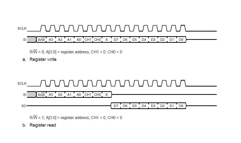

I did some playing around with an NXP SC16IS750, and here's the SPI timing for it. (Chromatix, you mentioned the MAX3100, which also looks like a nice chip -- and I suspect its SPI timing is similar. This suggests you may've underestimated its potential, although I'm happy to be corrected on that.)
This image from the 16IS750 datasheet shows a simple read and a simple write of any of the on-chip registers (which BTW are like those of the widely popular 16C450, thus facilitating re-use of existing code; just have SPI read/write subroutines replace parallel read/writes from/to the UART). Notice it takes 16 clocks to read or write a byte. That's because there's a one-byte prefix containing r/w, the register address, and 2 unused bits.
In this simple case 50% of your bandwidth is overhead (because it takes 16 clocks to transfer 8 bits). But a 1 MHz 6502 can, as noted, bitbang 50,000 SPI bits per second, and 25,000 of those bits will be useful data. Thus, 19.2 kbaud on the asynch connection won't be a problem.
Using the FIFOs increases program compexity somewhat, but (among other benefits) it all but eliminates the 50% overhead. That's because the entire FIFO contents (eg: 64 bytes) can be transfered using just a single prefix byte. SPI throughput basically doubles, and that's how I calculated 34.8 kbaud... for a 1 MHz 6502 using bitbanged SPI. :shock: Obviously a faster CPU can exceed this figure.

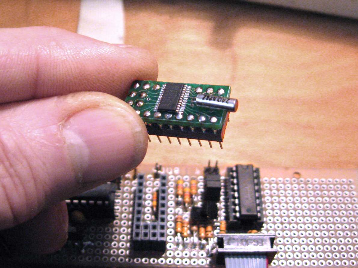

(BTW Sparkfun used to sell a 16IS750 breakout board; dunno if it's still available. And here is a much smaller breakout board of my own. :mrgreen: )
