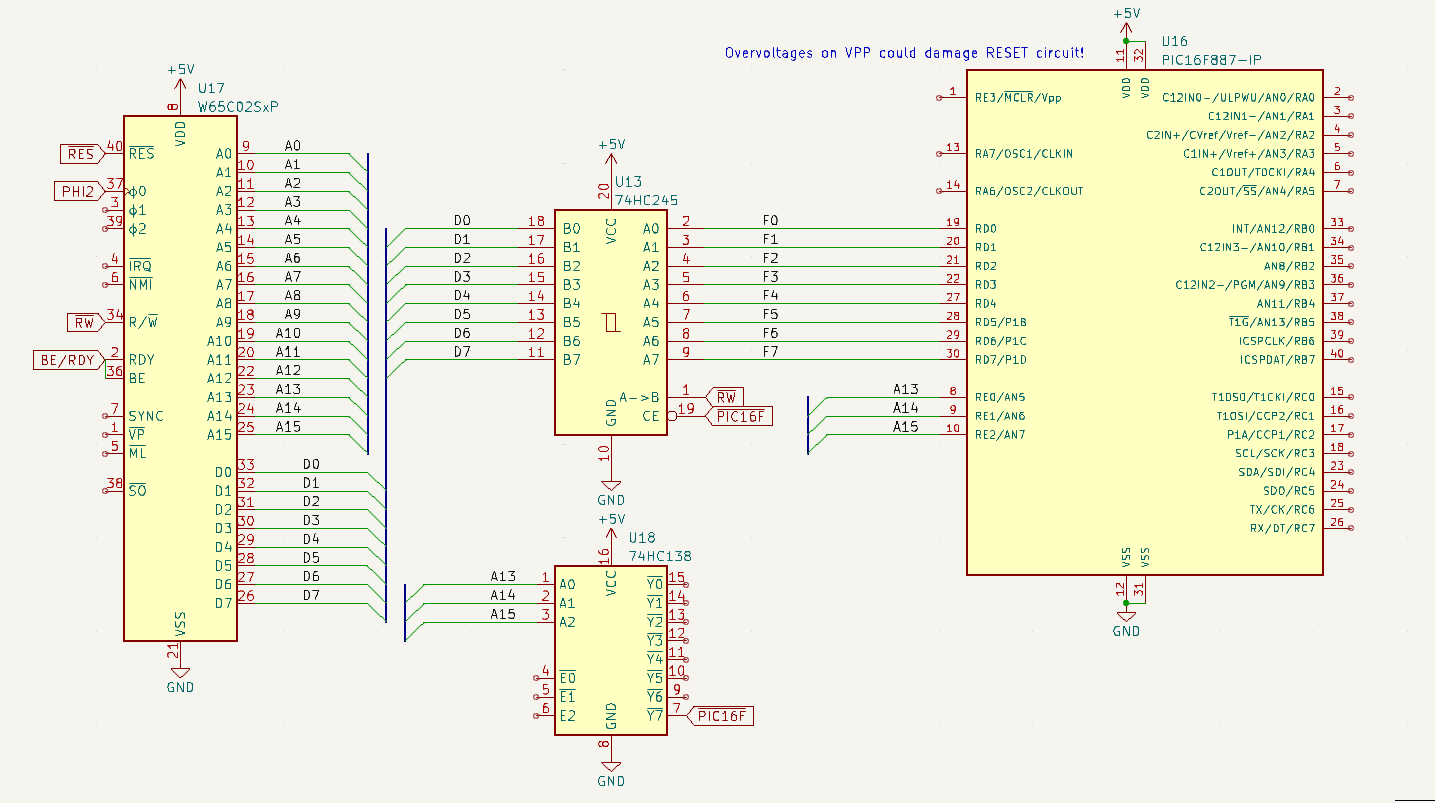

Hey everyone!
Just seeing if I could get some direction and/or advice. Lately I've been fascinated with the PIC16's and particularly I chose to start playing with a whopper, the PIC16F887 in the DIP40 package. The main reason why is for it to replace the ROM on my next 6502 design, but then it can double as my I/O device for keyboard/audio/SDcard.
Attached is a proto-schematic of what I'm thinking so far. Essentially the PIC is attached to the data bus through a '245, selected through a '138 (or a CPLD, etc). Here it should be selected when the 6502 is looking for a reset vector, but there are other configurations possible such as DMA in conjunction with the BE/RDY line, etc. After bootloading, the PIC16 could send interrupts on a timer or when keyboard/SDcard data is ready, giving the PIC16 plenty of time to set up the data bus while leaving the 6502 to do none of the hard lifting. It wouldn't be as fast as interfacing with a VIA, but most of the internal programming of the PIC16 would optimize what data does need to be transferred.
Any ideas on what might work best? Any links from previous builds? I'm open to suggestions of any kind!
Thanks guys.
Chad

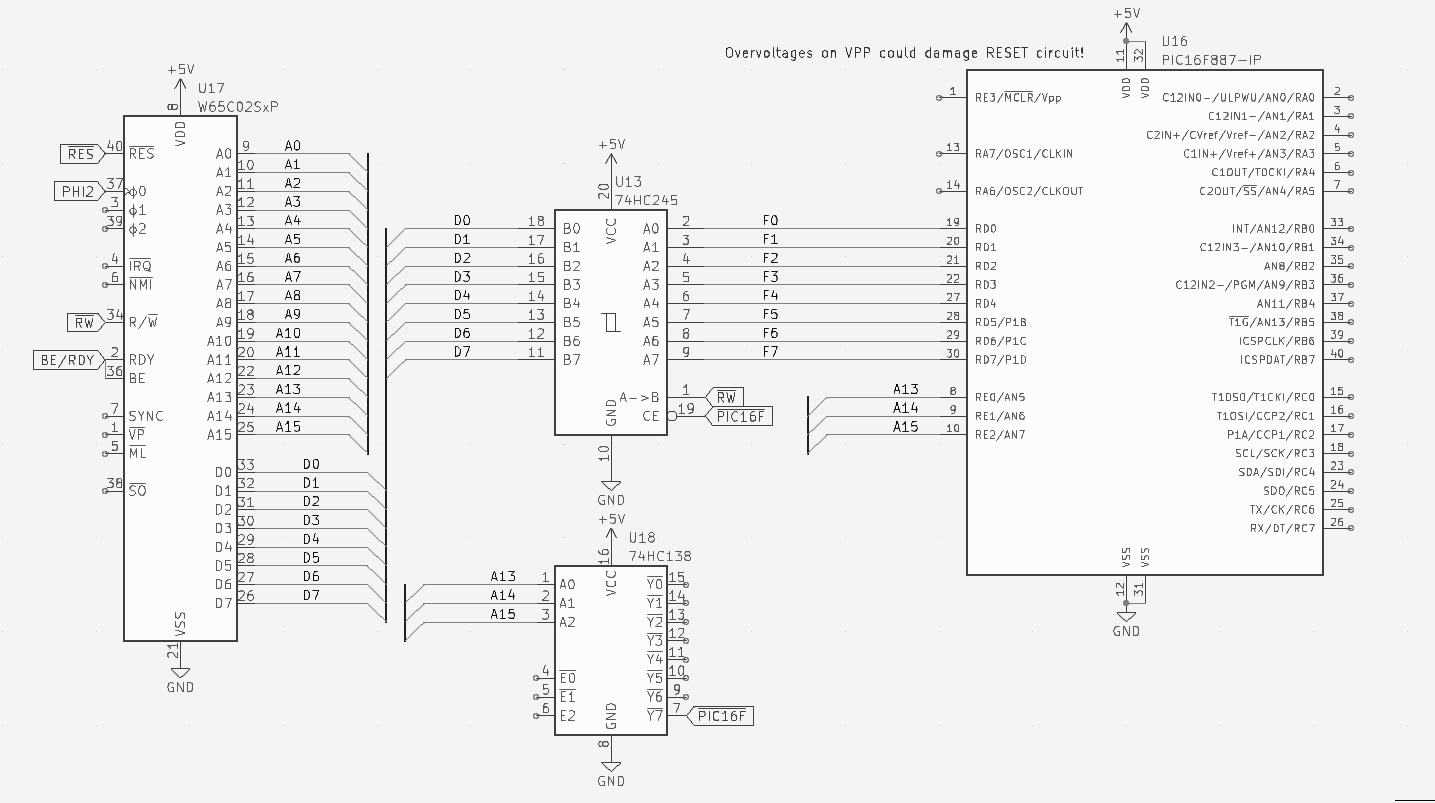

EDIT: Added Black and White version of the picture. Sorry BDD!

sburrow wrote:
Hey everyone!
I do something similar on my Ruby boards, but with an ATmega1280p. (40-pin DIP package). the µC boots the 65xx, acts as a serial port and runs all the filing system code. (It also has a serial translation layer that converts from Acorn VDU codes to ANSI codes so programs that to text screen stuff - like editors - can run unchanged on any old terminal that supports ANSI as well as the dedicated RubyTerm program that handles graphics)
However in my case, the µC isn't acting as a ROM as such - it's not fast enough to keep up with the 65xx @ 16Mhz so I do it differently. (Although I did consider having the µC clock the 65xx at one point)
But I don't see any reason your way shouldn't work if the PIC can sample the ROM select signals (A13:15] and respond fast enough. (I know very little about PICs - like their max. clock speed?)
Ah - just done a quick search - 32Mhz - might be fast enough for a 6502 at 8Mhz... Hard to know though.
Is the buffer needed? Can't you tri-state the pins on the PIC?
Could the PIC generate the /PIC116F signal to save an IC?
In Ruby, I also connect A8:15 to the µC too. A0:7 are pulled high - that way the µC can access the top 256 bytes of RAM in a mutually exclusive way and communication is via the Rdy signal (65xx executes WAI)
In my original 6502 board I used a GAL to soak-up the glue TTL - R/W qualification, address decode for a VIA, etc.
There is latency in the way I do it though - the ATmega needs time to switch the buses over - tristate/release, etc. PIC might be faster. I do get about 33KB/sec transfer over the interface though which is fast enough.

PostPosted: Fri Oct 27, 2023 10:24 am
Posts: 718
I have been going off the assumption that the the PIC will be considerably slower than the 6502 in reaction time. It takes 4 clock cycles to do one instruction, and thus I don't think I can reliably have it load data onto the bus or tri-state in time for things to work smoothly. Unless the 6502 is running in the kHz range during bootloading I suppose.
I don't think the PIC is any faster.
The STM is reasonably nifty when it comes to changing port directions but disappointingly slow at responding to interrupts
Yep, I'm expecting that. I know the PIC isn't inherently designed for 6502 systems, but the possibility of replacing the ROM and VIA in one chip sounds nice. I read through that link you sent, thank you.
Things to think about, thank you!
