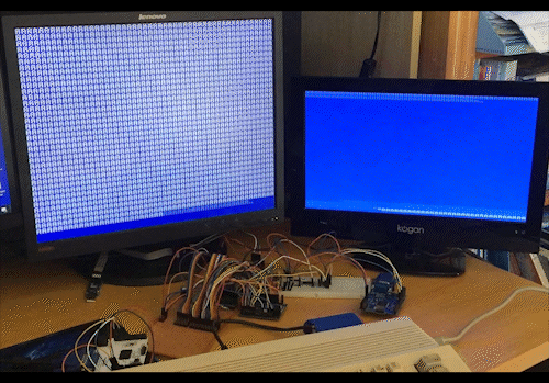

Here's a gif of it running side by side with identical code base vs a Commodore 64. (C64 left, J64C right).
I'm extremely happy with the progress so far and have had many sleepless nights working out and resolving various problems along the way.

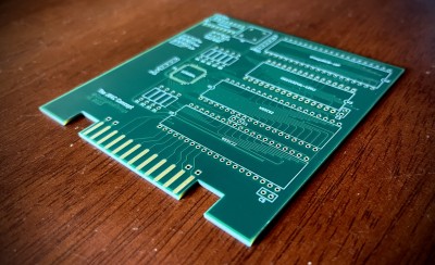

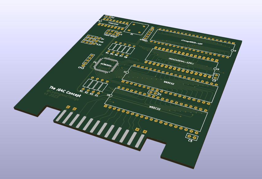

Just ordered some boards through PCBWay. :D
Just has a couple of ports allocated though an edge connector for now. That should give me enough to play with for a little while, until the next version.

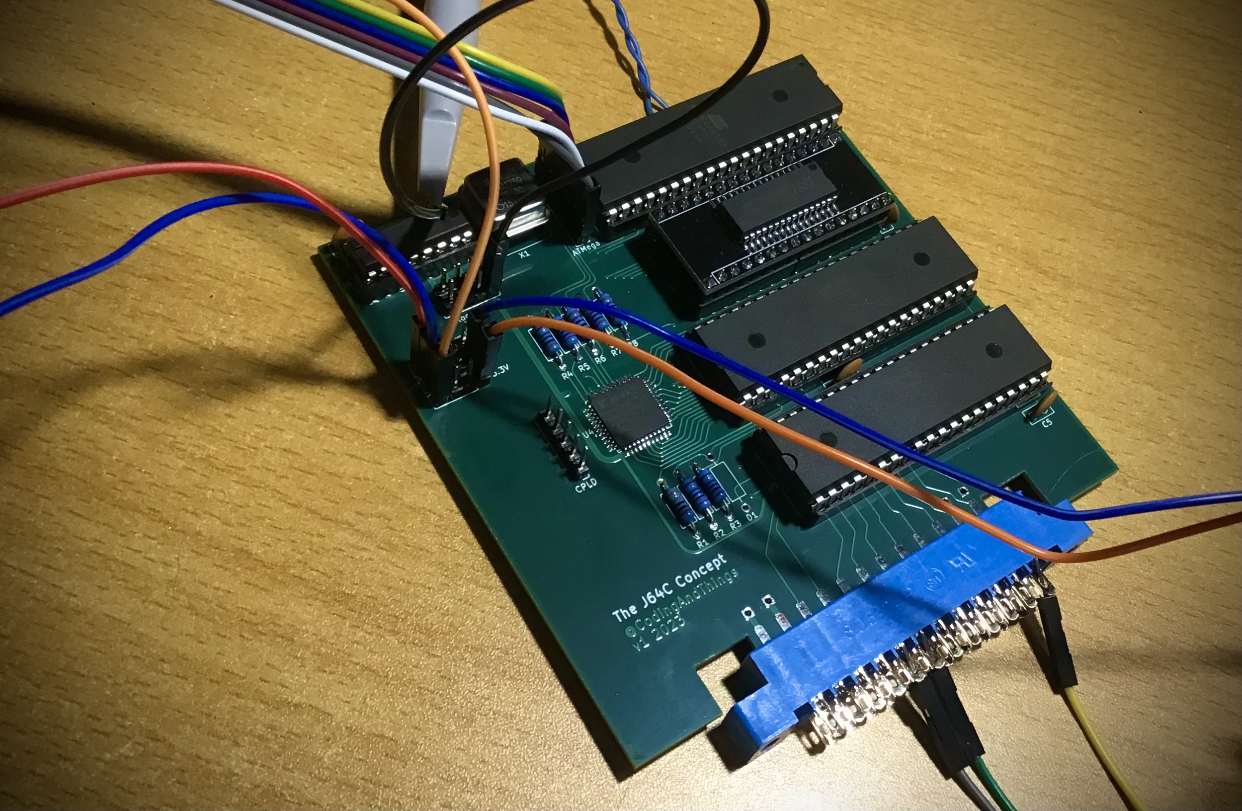

The boards are in! Wish me luck! :lol:

PostPosted: Thu Sep 21, 2023 8:13 am
Posts: 155
Well this turned out to be better than anticipated. My first attempt at a homebrew computer is working perfectly!
Started out at 1.5 MHz, but had some initial issues getting beyond that. I seemed to be able to iron out the quirks in the bootloader/reset side of things and sorted that out.

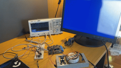

25.175 MHz! Still stable!!! Been running on my bench for the past hour, doing its thing sending data to the screen via a GameDuinio board. Craziness!
Not even sure what this thing will top out at, but it's going far beyond my wildest expectations.

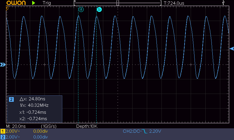

Probably sounds far fetched. But I have this running next to me right now at 40 MHz!

Safe to say the W65C22 isn't going to cause as much of a bottleneck as people would think. Time to push on and see where the upper limit is! 8)
Edit - Make that 50 MHz!!! 8)
50 MHz seems to be where it caps out before it cracks it. Time to play with clock stretching and see if I can squeeze any more.
Ah man... Scratch all of that. I was feeding that clock in to a clock divider. So I'm still running at 25 MHz. :oops:
Still the gif video above still stands. It's moving along very nicely!

40Mhz is realistic. I have a hand wired design that does 40Mhz with elevated supply voltage of 5.4V. I have a revised pc board coming in next week that I hope to run 40Mhz at nominal 5V.
50Mhz is incredible!
