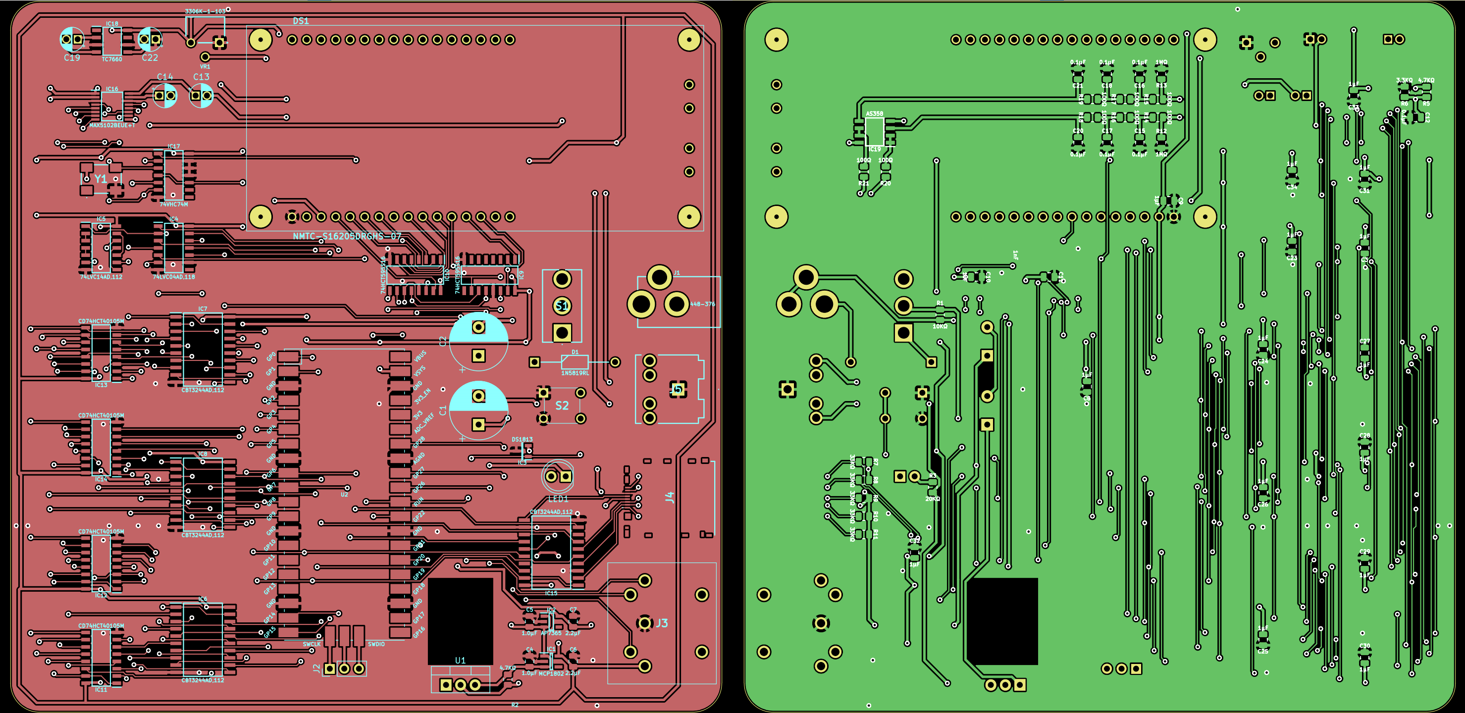

To put it in perspective that PCB probably took about four hours from start to finish. I doubt that's impressive for a professional (well, I know it's not from having watched YouTube videos) but I think that's a good time for a hobbyist. And only about a third of that time was trace routing. The majority was placing components; a bit of board setup (and clean up); and footprint fixing. I'll happily spend an entire weekend on a coding problem - an afternoon on a PCB seems okay. And I have something tangible at the end.

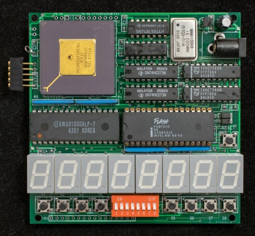

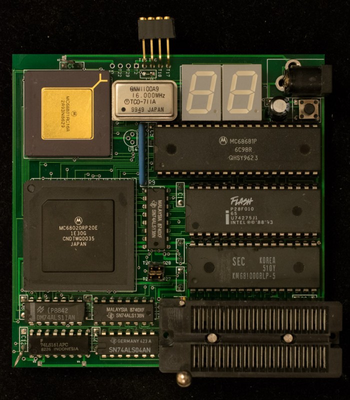

I started with manual routing in early 1980's with Racal Redac's Maxi workstation (expensive! >$100K) but once I had decent autorouter such as Cooper & Chyan router, I don't do manual routing anymore. The schematic/PCB tools (WinDraft & WinBoard by Ivex) I currently use were inexpensive tool for small business but does have Specctra router (aka Cooper Chyan). Ivex went out of business in early 2000's and I haven't updated it for 20 years but I still use it to design every boards and autoroute pretty much all of them. The software are buggy but not updating for 20 years means I know just about every bugs and how to work around them. For through-hole components on 100mmX100mm board and JLCPCB design rules, the Specctra router can 100% complete in 2 layer even with components placed shoulder-to-shoulder. Here are a couple examples.
