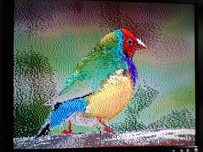

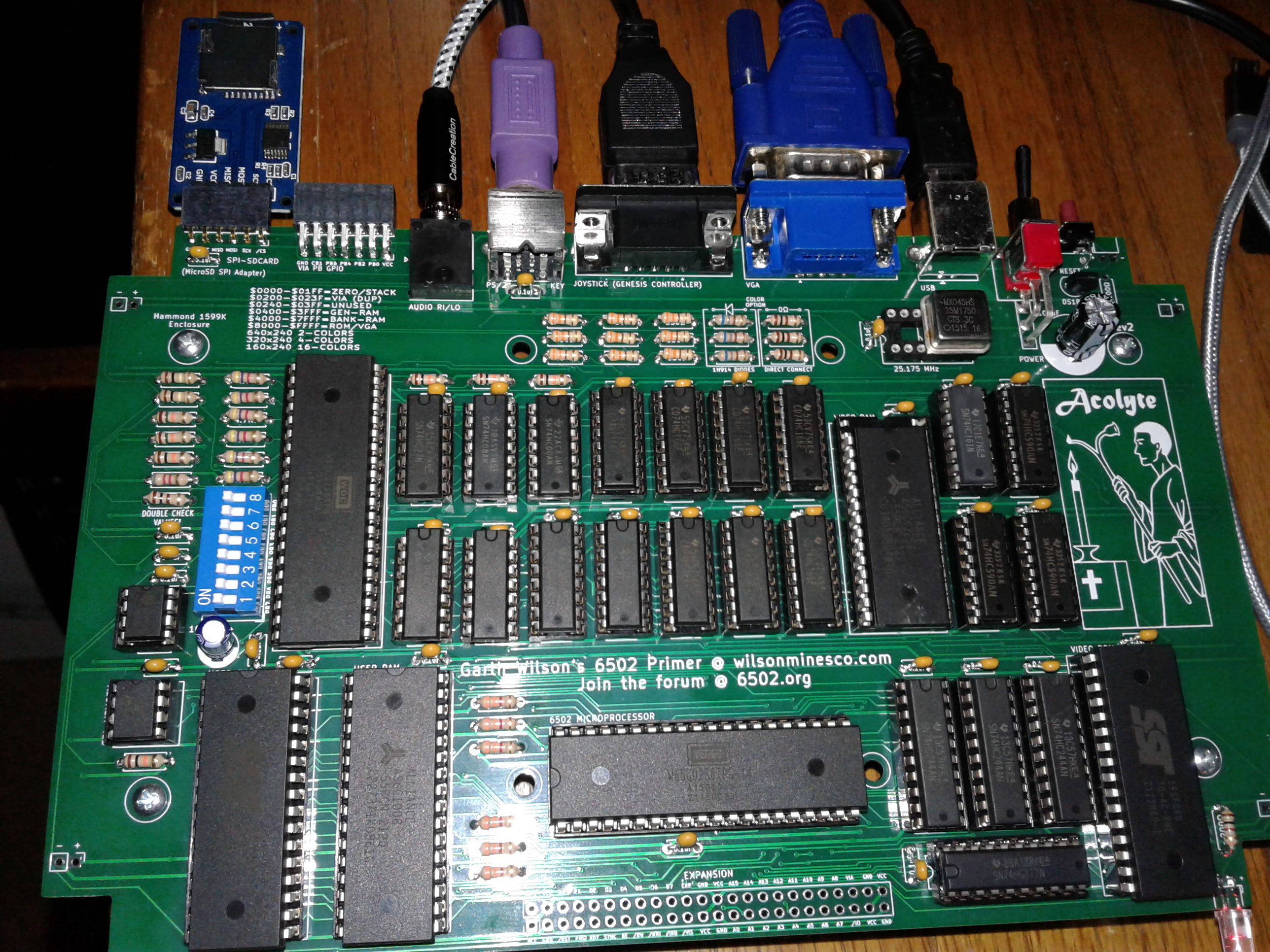

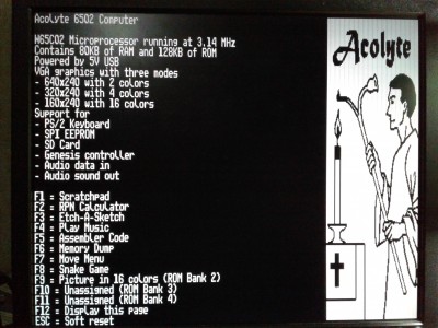

Hello everyone!
Revision 2 of the Acolyte 6502 Computer is now complete! Previous topic on the Rev1 board is found here:
viewtopic.php?f=4&t=7096
So for the past few weeks I have been working on revising the board, making small changes, adjusting color settings, and eventually adding audio-out and Genesis controller support. Attached are some pictures, commented code, and schematics. All extra info can be found here:
https://github.com/stevenchadburrow/Acolyte6502Computer
But I have a small story, and I'm sure you have had this happen to you to:
I soldered everything yesterday, and didn't want to even turn it on because I knew I'd be fiddling with it all night. Well, I turned it on anyways, and the screen was flickering. HUH? So I scrubbed the bottom with a toothbrush and the flickering went down, some. I was sure it was crud somewhere, so I went over my soldering again and again, and removed hairs and anything else I could find, yet it still flickered. I then pressed my finger on the expansion pin-holes and the flickering stopped! I touched in other places and it stopped, or got worse. WHAT? Surely I messed up a connection, or JLCPCB bit me again. The scope didn't help because if I scoped a problematic pin, the flicker would stop and the scope would read fine. UGH! What could it be? I whittled it down to my primary counter, a 74HC161. So I replaced it with another one, and the flicker entirely disappeared! YAY! This chip was *brand new* from Mouser, so what could have happened, I don't know. Glad I had replacements to test.
Other than that, nearly everything else worked as expected. I only had a very few small changes in the code I had been designing for this board. The software side is great, I have focused on using the keyboard Function keys to navigate. Some programs include a RPN Calculator, Music Composer, Assembler/Disassembler, Memory Dump, Data Movement/Transfer GUI, and a simple Snake game. I have had my 3 year old daughter test the system, and she has found many bugs along the way! Always have a young child test your 6502 computer, LOL! :)
Genesis controller is not yet working, but I'll be working on that later. I seem to have messed up my understanding on how it works, and basically I should have included 6x pull-up resistors on the board. I think I can navigate it in software, but that'll be for later. Other than that, all other things are working: EEPROM, SD card, PS/2 Keyboard, Audio Data In, Audio Sound Out, and of course VGA graphics.
Thank you all for the help and support along the way. I really couldn't do it without you. And, a very very special thanks to Garth, for his continual patience with me :)
Thanks everyone, have a wonderful day!
Yes, YAY! Congrats on your success, Chad. :)
As for that chip, did you try swapping the old one back in again? I wouldn't be surprised if the problem re-appears, but I also wouldn't be surprised if it doesn't.
You may already be aware, but I'll remind everyone that bad connections are an extremely common cause of trouble in electrical and electronic circuits. Solder joints are one example, but switches, potentiometers and connectors can be a point of bad connection, too. And it's not at all uncommon for the "bad" connection to fix itself after being disturbed.
An IC socket (and the IC pins) together work as a form of connector, and it's possible that removing the old chip and inserting another -- or reinserting the same original chip -- is the all the disturbance that's necessary to displace the problem. Maybe there was a bit of dirt or flux that landed in the wrong place? I'm purely guessing as to the exact mechanism, but experience has taught me to be wary of hasty conclusions (such as "must've been a bad chip").
PostPosted: Fri May 27, 2022 1:17 pm
Posts: 718
Thank you Jeff, I appreciate it. So I did just recover that old one from the trash, and replaced the good one with the bad one, and indeed the flicker came back. I put the good one back in, and the flicker went away. I probably couldn't even take a picture of the flicker, because it only happens in very particular circumstances and fairly minor. Last night I was showing it to my wife, and she couldn't tell until I pointed it out in a very specific spot on the screen. Of course I could tell immediately because I'm *looking* for issues like that. So, does the chip "work"? Yes, it functions. Does it work well? No, something is wrong with it, and I cannot tell what exactly.
So then, is this a "bad chip"? That is actually a good question. If I had 100 of these chips, and tested all 100 of them, would I get 99 of them without flicker? Or would I get 50 of them without flicker? Am I pushing margins and I just got lucky with this particular chip? Or in the end, is this just a bad chip? All good questions to ponder on. I will say that my "Half-A-Pi" and "AcolyteRev1" boards both used the exact same setup with this particular chip, and both of those worked immediately without any flicker. So we currently have 3 out of 4 chips work and as expected, and 1 out of 4 'works', but not as expected.
I'll hang on to this chip, for curiosity sake. But my curiosity isn't so great that I'm not going to move on to the next goal :)

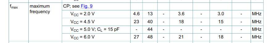

First, let's look at the datasheet for a second. Maybe you can help interpret this for me:
https://assets.nexperia.com/documents/d ... 4HC161.pdf
Specifically the attached picture.
So I'm running this at 25.175 MHz. The first values are Min/Typ/Max so I'm well within that 27/48 range there. BUT then there is the -40C to +125C stuff, which doesn't make sense to me because that's from Antarctica to the middle of an Aggie bonfire. And I DON'T meet that range. At 25 MHz I'm above the 21 and 18 mark. Now, it is getting pretty warm here in Texas, but I didn't stick this in the oven or something. Before I start laying my soldering iron on good chips, can you explain what I'm looking at?
Here's another thing: I am literally just copying George's (gfoot) circuit. And he and many others have used these '161s/'163s at 25.175 MHz. Jeff, you in particular showed me how to use this chip on a previous build where I was using it at exactly the same speed. Looking at the schematic, FOUR other chips are directly pulling from that same oscillator, and another EIGHT chips are using it's inverse. None of those guys have issues it seems, only this one sad '161.
I could try to find a variety of '161s, and I honestly am considering it. I want this to be a solid build, I want to prove this build. To myself, and to you.
I'll start with sticking this bad chip in the freezer and seeing if that helps. That at least that is safe enough to test.
Thank you Jeff, good discussion, I appreciate the insight.
