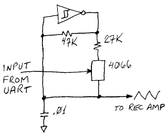

For a simple 9-level DAC (digital-to-analog coverter), you can use a 65(c)22 VIA's shift register shifting out free-run under T2 control, more or less as a PWM. See my second diagram and accompanying code after the "Digital-to-analog converters" heading of my 6502 primer's "circuit potpourri" page at http://wilsonminesco.com/6502primer/potpourri.html#DAC . What I did on my modem design however was to use a relaxation oscillator and use an ACIA's TX output to turn a transistor on and off in series with a resistor so the capacitor would charge faster or slower. I was looking for my schematics yesterday but still have not found them.

PostPosted: Tue Mar 15, 2022 8:15 pm
Posts: 8546
AndersNielsen wrote:
and can leave the SR for other important things.
Would you need those other things at the same time you need the cassette data storage?
I guess the relaxation osc. approach would also work with T1/PB7?
Here's the relaxation oscillator idea, although there are lots of possible variations on this theme. The 4066 is an analog switch.
The resistor and capacitor values will give somewhere around 1200Hz and 2400Hz, although you might have to adjust them for any given 74HC14 Schmitt-trigger inverter since the hysteresis points are only specified to be in a range, not an exact amount like you could get with an op amp and a few more parts. Regardless, you don't have to keep sending samples to produce a continuous wave of a given frequency like you would have to with any kind of D/A converter.
I can see that working! I’m sure I have a 4066 somewhere so I will try it out before I commit to the “sine wave DAC”. For the other approach I have to set PB7 to flip at 9600 or 19200hz to get 1200/2400hz and it works. Probably wouldn’t at 1mhz though.
This way I guess I can get by with a lower irq frequency.
