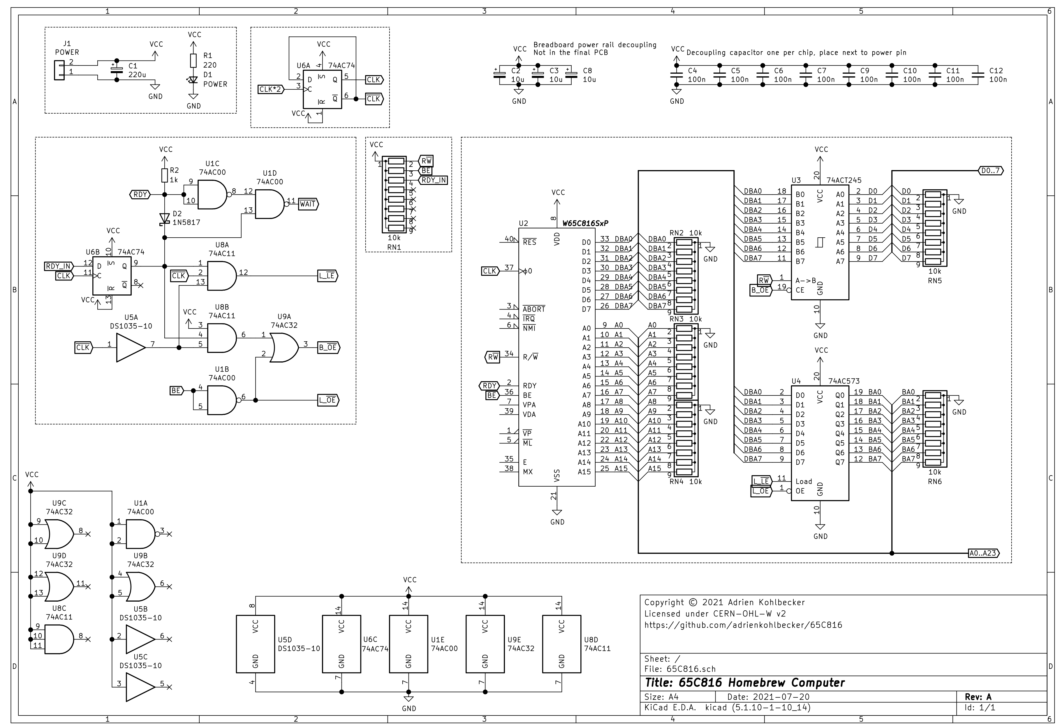

The latest episode is #5, and discusses how to transform the RDY pin into two uni-directional signals, RDY_IN and WAITN. Hope you find it interesting!
This is the current schematic:

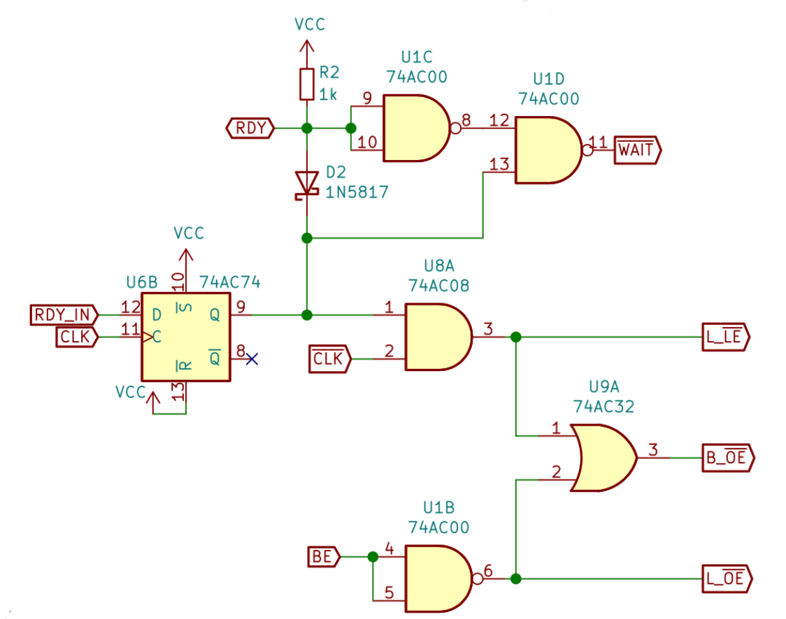

The latest episode is #6 (released a couple weeks ago but forgot to post here!).
In that episode, I add support for RDY in my databus demultiplexing circuit. After decoding it into RDY_IN and WAITN in the previous episode, I can now use this signal to determine if I should open the latch and enable the buffer or not. Had to add a flip flop to register the RDY input so that the glue logic and the CPU are kept in sync, as well as a clock flip flop to make the timings work. I'm pretty happy with the results, but I'm now working on the next episode which will go back on the timings, and (spoiler alert), use a DS1035 delay line to make them work even better.
This is the new logic:
And of course this is the whole new schematic:
Hope you find this interesting!

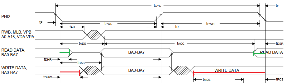

I'm also just done watching episode 7 which reminded me I have a question about read/write timing.
If you take a look at tDSR does that mean that READ DATA must be valid (at 5V) 10ns before the clock falls? If so I assume that means that the 65C816 is constantly latching that READ data internally and needs it to be latched before the clock fall?
Also as tDHR is 10ns does that mean READ DATA actually needs to be valid for at leas 20ns in total (the green line)?
Thanks,
Andrew
PostPosted: Sun Oct 24, 2021 8:35 am
Even with a flop which captures data on the clock edge, there is usually a small setup time and a small hold time constraint both of which need to be satisfied for reliable operation. Which is to say, nothing is instantaneous, and there needs to be a little stability around the crucial moment.
In some cases the hold time will be zero, but it's still a constraint.
Internally, what may happen is that an unstable input at the critical moment will cause internal delay as the signal settles, which turns into a problem of getting the right answer in time for the next clock edge. Worse, it's possible that the slowly changing signal on the inside is interpreted as low by one part of the chip and high by another, which can cause completely unexpected results, or a lock up.
Search for 'metastability' for more on this.

Yes, that is my understanding as well. You need to present the data at the CPU pins 10ns before and 10ns after the falling edge of the clock. Note that the buffer that you add in front of the CPU impacts those timings: in my build using the 74ACT245, I need to present the data to the buffer 19ns before and 9ns after the falling edge of the clock. See this section of my timing diagram

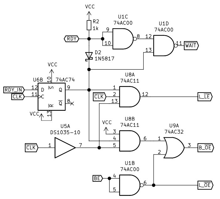

In that episode, I go back on the timings of the databus demultiplexing circuit, and I add a delay of 10ns to some signals using a Maxim DS1035M-10, which is a pretty cool, accurate delay chip. This is the final episode in this demultiplexing series, and I'm now pretty happy with the circuit as is. In the next episode, I'll go back to basics and work on the clock!
Here is the new glue logic:
And the whole schematic
