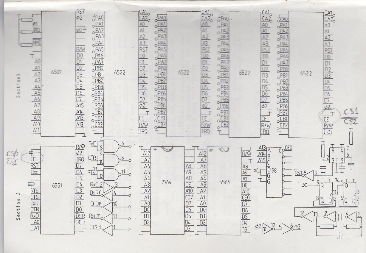

Hello all ... back in 1989 I bought a J.P. Designs Parallel 65 SBC (*) for a model railway project. I still have the receipt, purchase price back then was £127.02! The project never went anywhere but I still have the SBC. The board has R6502A, 6264 8kx8 static RAM, 2764 8kx8 EPROM, R6551 ACIA, 4xR6522 VIA, and the following for glue logic: 74HC74, 74HC04, and 74LS138. Finally a 1488 and 1489 provide RS-232. The 138 decodes A13/A14/A15 to give 8 8k blocks, phi1 (yes phi1) being used as input to the 138 to qualify the /CE outputs. On the 6264 and 2764 /OE and /CE are connected together. The 6502 runs at 1Mhz.
Finding a bit of free time recently whilst other projects are on hold I decided to get the SBC out for a bit of fun. I removed the 1488 and 1489, fitted a couple of jumpers, connected a 5V RS232 to USB adapter, and applied power. It worked :D
Now thinking I'd like to get back into playing with the 6502 family - I had an Acorn Atom back in the late 70s and a loaner BBC micro in the early 80s. I'm contemplating upgrading to a WDC65c816, 32kx8 CMOS static RAM, and using a 8kx8 NVRAM (STMicroelectronics M48Z08-100PC1?) in place of the EPROM. Glue logic would be updated to decode 32k+(8*4k) and would use phi2 to qualify R/W to generate /OE and /WE. I'd also like to use the existing PCB as much as possible cutting a few tracks and rewiring where necessary. For the 65816 and new glue logic I'm thinking of a small point to point wired daughterboard connected to the 40 pin header conveniently provided on the original board which breaks out the original 6502.
This raises a couple of questions:
1. should it be ok to mix the modern CMOS chips with the older NMOS chips - I'd rather not replace the VIAs and ACIA if not necessary, in fact I'd rather retain the original ACIA in order to avoid the well documented transmit bug in the 65c51.
2. with reworked address decoding and glue logic nothing would require the old 6502 phi0 or phi1 so I assume I can just ignore those, simply rerouting the external clock that would have gone to phi0 on the 6502 to phi2 on the 65816.
I've noted the various posts and resources on 6502.org re replacing a 65(c)02 with an 65816 so am aware of the pins that have been repurposed and how they should be connected.
Anything strikingly wrong with the above approach? What have I missed?
The NMOS inputs won't have any problem with the CMOS outputs. However, driving CMOS inputs with NMOS outputs can be dodgy, as an NMOS output's logic 1 is a lower voltage than that of a CMOS device. We know from testing, for example, that an input to the 65C816 when running on 5 volts needs to be 2.7 volts minimum for the 816 to recognize the input as a valid logic 1 (as an aside, this is substantially below what the data sheet says is a valid logic 1). The salvation is that if very lightly loaded, an NMOS output might rise into the low 3 volt range—the theoretical maximum is 3.4 volts, which is enough for the 65C816 to recognize it as a logic 1.
That's correct. My only caution is that you examine the Ø2 clock on a 'scope to verify that it swings rail-to-rail and that the rise/fall times are very short, ideally under 5ns.
I've added my emphasis ... looks like mixing CMOS and NMOS is asking for trouble.
See below for what the clock output from the 74HC74 looks like - rail to rail pretty much with some ringing, but not quite <5ns rise and fall. Adds more to the potential troubles!

By chance, do you have a schematic for it?
The user manual includes a 'circuit diagram' as shown below. Not quite sufficient in itself, for example not showing that the output enables and chip enables are tied together on the ROM and RAM.

But enough reminiscing ... what am I going to do? My thinking is now more like:
1. Still try to use the existing PCB - it is only double sided so should be easy enough to cut tracks and rewire as needed
2. Switch to use of CMOS throughout, i.e. 65c816, VRAM (in place of EPROM), RAM, 65c22 (noting the difference in IRQ treatments for N and S variants), 65c51 (using 65c22 timer to work around transmit bug), and of course CMOS glue
I shall explore some different memory maps and address decoding and see if I can figure a solution that gives me more RAM, maintains the 4 VIAs and ACIA, but manages to fit the glue logic into 2 14pin and 1 16pin devices to fit in the existing sockets. If I can't do that then I'll revert to the daughterboard on the 40 pin header idea. It would be nice though to keep everything on the original board :)
Again, many thanks for the warm welcome, your insightful replies, a reminder of teenage excitement, and, along with the rest of the forum, providing much for me to ponder upon. No doubt I'll be back soon as I get into the detail and see how much life I can inject into this old board.

Like the others, I'd be reluctant to butcher the board. As with the early KIMs, what you have may have collectors value. It would be unfortunate to destroy that value.
Replacing the 6502 with a 65C02 would make more sense in this context. The 65C816 emits the bank bits on the data bus during Ø2 low, which might lead to bus contention and instability in this unit. A bus transceiver slaved to Ø2 and RWB would eliminate contention, but again, would require some butchering. The 65C02 wouldn't give rise to this problem.
What you are suggesting would be bringing you perilously close to scratch-building a computer. As I said above, I'd be reluctant to butcher this unit and would instead consider building something else if you wish to do what you are describing.
...looks like mixing CMOS and NMOS is asking for trouble.
It can be. As Ed noted, you need to carefully study what is driving what to identify likely trouble spots. Reiterating, a CMOS output into an NMOS input is no problem. The reverse may be a problem...it depends on circuit loading and to a lesser extent, the maximum rise and fall times that the device being driven can tolerate.
Case in point: my POC units all use an SRAM with TTL-compatible inputs and outputs, this in a circuit that is 100 percent CMOS. It works because the 65C816's inputs are more "sensitive" than the data sheet indicates. In general, it seems modern devices with TTL-compatible outputs like the SRAM (and the EPROM) I use have significantly more fan-out capability than their predecessors of the 1980s. Considering that a CMOS input draws virtually no current once the circuit's state has settled, that helps to minimize loading. The odds are pretty good that a modern TTL output will adequately drive a CMOS input.
Yes, I'd expect rail-to-rail with a 74HC device—didn't know that was the clock source. The rise/fall time is not a problem with a Rockwell 65C02, but might be with a WDC 65C02. You'd have to test to be sure. Worse comes to worse, you can replace the 74HC74 with a 74AC74, which will easily meet the 5ns requirement, albeit with a little more ringing.
Speaking of ringing, what I see on your 'scope capture doesn't appear to be anything about which to worry.
