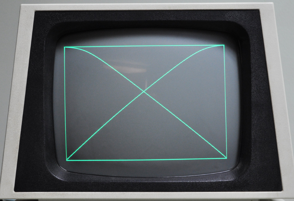

Currently, I have managed to draw a 768 * 240 bitmap using the old shift register method.
Monitor linearity is not perfect, but I think that is just a matter of my sync signals being a bit off the mark.
The cross should be perfectly vertical. Seems after vsync, the monitor is "catching up".
It looks decent with an image though, but I am sure I can fix the issue by tweaking my timing a bit...

Looks quite good... on the upper X pattern, perhaps part of the issue is with the horizontal and vertical deflection amplifiers for the display. As the machines are quite old, I wouldn't be surprised to find some old caps which are either a bit leaky or light on capacitance. The same can be said for carbon composition resistors, as their value tends to go higher over the decades. I have a pretty large collection of NOS Allen-Bradley carbon comp resistors.... and all have increased in their resistance values so they are far out of their marked tolerance. Lastly, any heat-sinked transistors generally suffer from dried-out thermal goop, so they tend to heat up more and some non-linearity sets in. Nice to see the progress you're making however.
PostPosted: Fri Aug 07, 2020 6:44 pm
Posts: 674
I just had my VSync signal too long. As soon as I reduced it, the video was perfectly square.

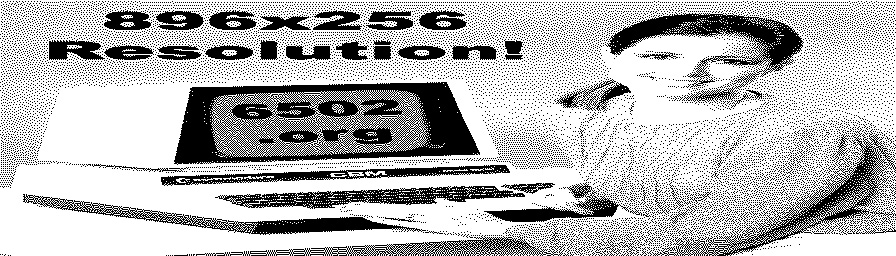

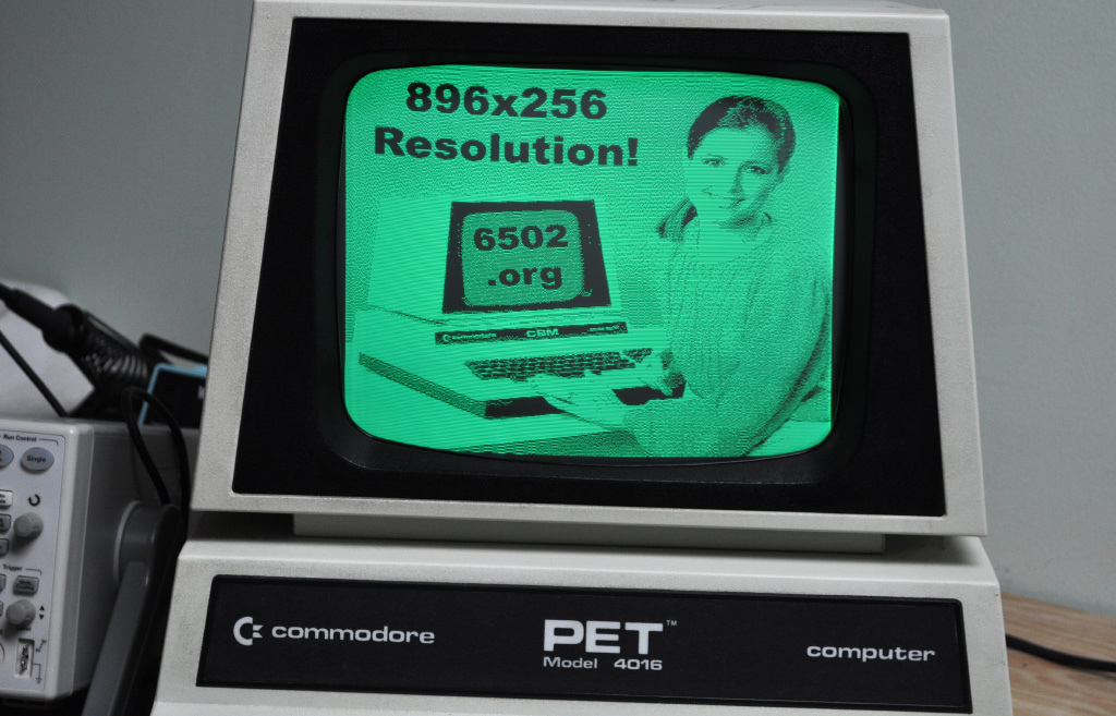

I wrote a simple bitmap converter to create 8 pixels per byte and then upped the overscan to a place where the monitor was happy.
The result is a maximum of 896 x 256 resolution. Ten percent more in either direction, and the monitor has issues syncing sometimes.
So I will have to decide if it's better to just keep to 768 x 240 with some borders, or go for this maximum resolution of 896 x 256 with some overscan.
Here is the result...
And the original bitmap I converted for this test...
Ok, the rain stopped again, back to work!

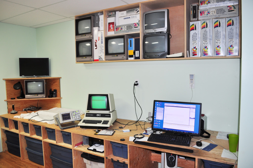

Seriously, very interesting. But I have to admit, what caught my eye was that corner shelf where you have the two monitors. I've been thinking about building something similar myself but haven't found any good plans online.
Do you have any specs, closeups, etc. on how that was built?

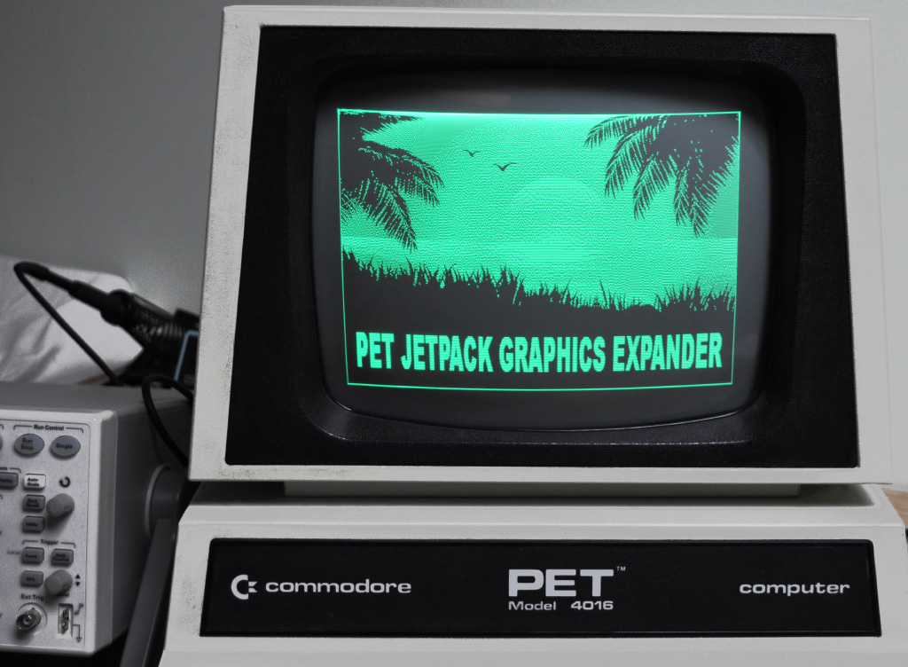

PostPosted: Fri Mar 12, 2021 10:57 pm
Posts: 674
Not sure when I will have time again to drop in, so here is a greeting showing the original PET video mixed with the new GPU...

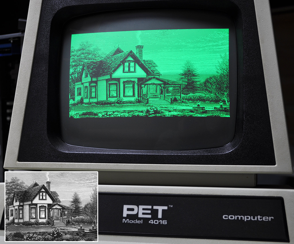

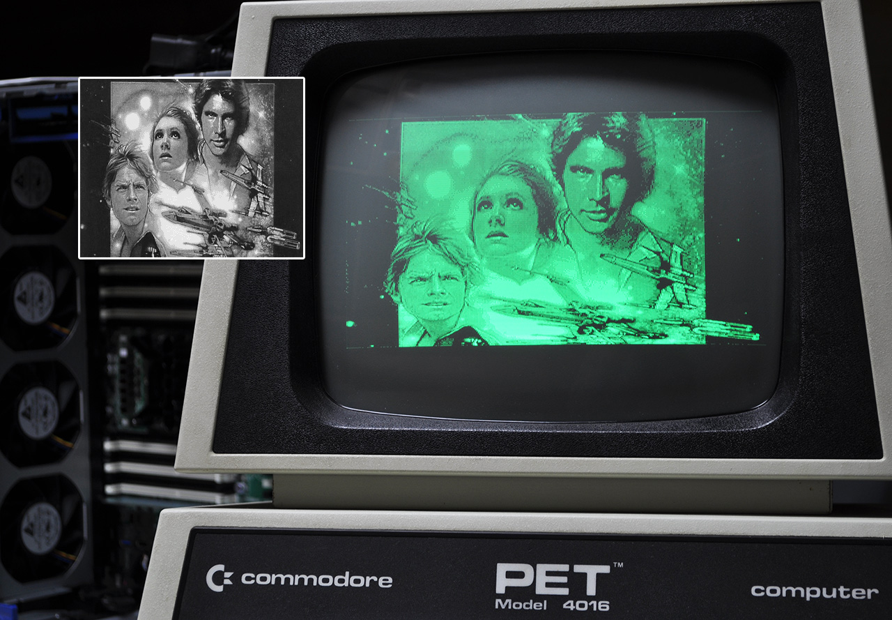

PostPosted: Sun Mar 14, 2021 12:34 am
Posts: 674
Wow, it actually works!
This is only 320x240, but does show that 16 shades of green can be done with a PET CRT.
320x256 actually fills the screen a lot better, so I may try 640x512 next.
Actually, calling these "shades of green" may be misleading as they are just very tiny pixels. In other words, the PWM takes a value from 0-15 and turns on a pixel for that much time. Technically, it is still a monochrome image, but has an effective resolution of 5120 * 256. Can your modern PC do that??? Nope.
Here is the result, possibly the first time a PET displayed a photo-realistic image....
I can't wait to see if I can push interlace and get a 640x512 image to show. For sure 640x200 is possible.
PET Jetpack is no longer a crazy idea, it can be done.
Here is the simple Shift Register Logic that sends out the pixels based on a 320*240 image stored as 4 bit data...

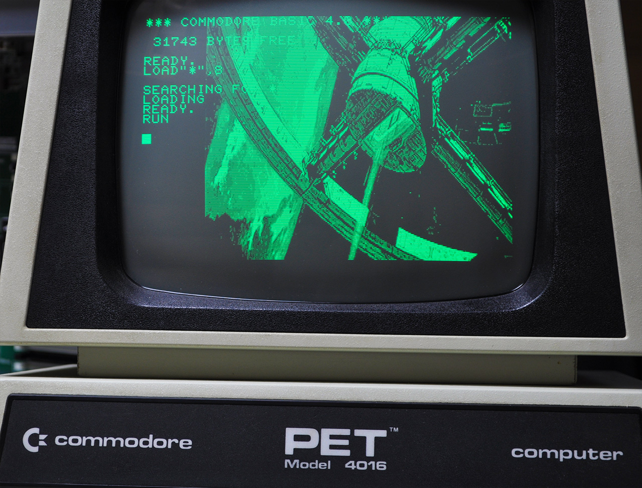

PostPosted: Sun Mar 14, 2021 12:58 am
Posts: 674
One more pic, this time a little higher resolution (320x256), along with the pic I converted to PET Data...

PostPosted: Sun Mar 14, 2021 11:52 pm
Posts: 674
Being lazy today, just hangin' out with my PET.
Managed to finish the 640x200 Video Generator with original PET video underlay, it it looks great.
I don't think I will mess with interlace as this is already working better than I ever expected.
Now that this project has completed the POC stage, I am going to make it more real.
The next step will be to map some commands using the data register on the PET IEEE port.
I already emulate loading of disk programs, so now I will also add commands using the same port.
The PET will even be able to draw graphics in basic using poke / peek.
Sprites, lines, shapes, etc will be added and perhaps some basic sound, similar to the original PET, but with some ASDR envelopes.
The goal is to add some shabang to the PET without making any mods. The "JetPack" will just drop onto connectors already available on the board.
