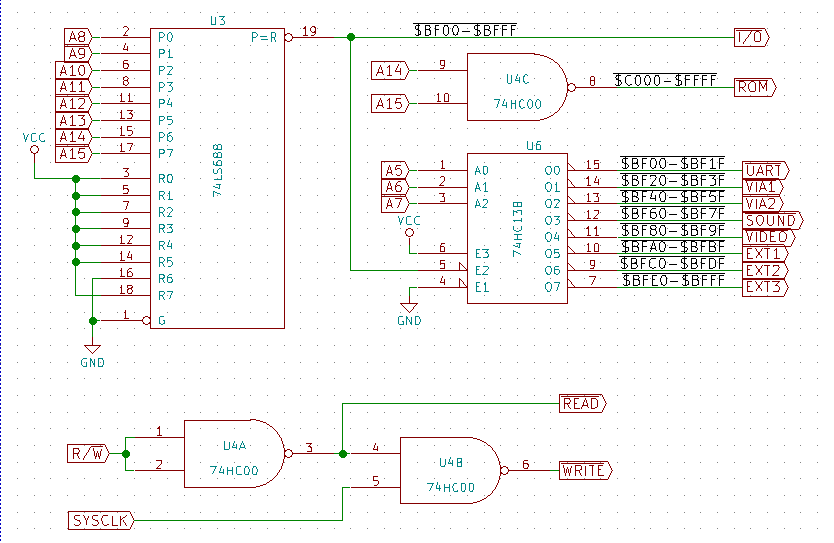

I am told the ARMSID has exactly the same timing requirements as the original MOS6581/MOS8580 SID.
https://www.waitingforfriday.com/?p=661#6581_SID_Timing
As far as i can see, the address should be stable 0 nS before R/W goes low!
But we all know that the SID datasheet is not exactly errorless...
I attached my current address decoding circuitry as a .gif to this post.
(very standard '688 and / '138 arrangement)
Keep in mind i use the direct R/W line for the (ARM)SID, not the qualified /READ and /WRITE.
@Chromatix: your solution sounds very interesting indeed. I'll check in to that as well.

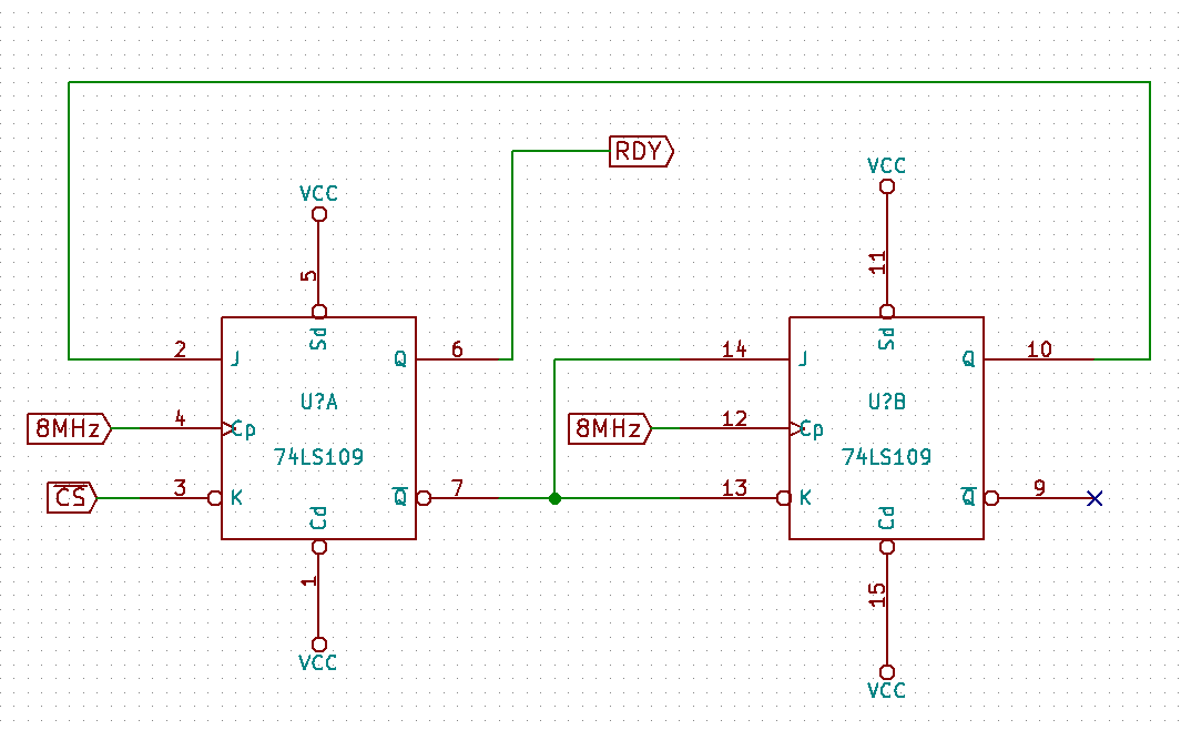

*EDIT: By the way, using the two halves of a '109 as Jeff described *almost* made it work; there are come crackles but generally the ARMSID sings.
Not sure if that is anything to go by, but does give me hope.

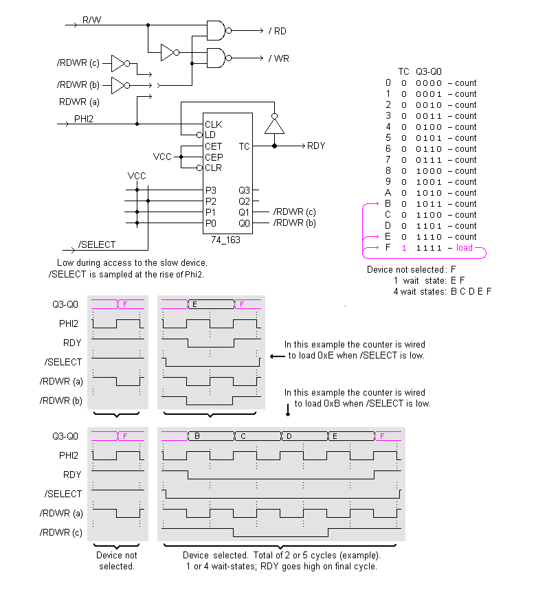

Probably the '163 counter circuit could be adapted to drive RDY instead [...] I'm sure we can figure something out.
Okay, here's an early draft of a diagram I'll eventually add to my main post. Comments (and proof-reading!) welcome.
This spills the beans on a '163-based RDY sequencer. I've shown detailed timing for only two possible examples, but others exist (based on different counter load values).
As you see, /SELECT being inactive (ie high) means the counter will surely load 0xF. But the value loaded when /SELECT is low varies between examples. If you wire the counter inputs so the counter loads 0xF or 0xE then the extended cycle will take 2 cycles total, and if you wire the counter to load0xF or 0xB then the extended cycle will takes 5 cycles total.
Optionally, you can do more than simply lengthen the cycle (pull RDY low). You can connect one of the counter output bits as a timed enable that trims the width of the /RD pulses and /WR pulses sent to the slow IO device -- note the bottom trace in each of the timing diagrams. You're giving the device extra address setup time before /RD or /WR go active; also extra address hold time after they've gone inactive. In a high clock rate system, this is the sort of pampering many sluggish devices require. :)
Without this timed enable you'd probably be forced to use Phi2 to qualify the /RD and /WR pulses -- and using Phi2 means each access will yield not one continuous /RD or /WR pulse but instead a series of short pulses, shown in the timing diagrams as /RDWR(a). Some ROM's may tolerate this, but /RDWR(a) is clearly not an ideal choice :|
Chromatix's '299 suggestion also bears consideration -- and I agree the 74HC299 is a useful chip to keep in stock. :) (BTW for this application the physically smaller 74_166 would work, too, although it'll require an inverter.) As described, the suggested circuit doesn't offer the timed enable I just mentioned, but that's easily remedied simply by adding a second '299 (or 166). One would output to RDY, the other to the enable signal.
Compared to a '163, the pair of shift registers give more flexibility in adjusting the setup and hold times to the minimum required. In some cases that should buy you a modest performance boost.
Doubling up the shift registers involves a space penalty, of course... unless you're willing to piggyback one '299/'166 atop the other. The upper chip would have its parallel inputs tied high/low in a different pattern, but AFAICT only one pin (the serial output) will need an awkward flying lead to connect to the motherboard.
edit diagram: one minor tweak, one outright bug fix!

If i was to use this setup, as i understand it,. I would have to add another inverter to the now stretched /RDWR line, as the (ARM)SID normally uses the processors (combined) R/W line directly.
Should not be problematic, just an extra logic block added to the SBC
I am going to experiment with this for a bit (if i can dig up a '163 from my stash).
Thanks again.
*EDIT* I stand corrected, the stretched /RDWR line IS a combined line for read and /write...
PostPosted: Sun Jun 28, 2020 11:07 pm
Apologies -- I didn't really complete the picture, having not yet considered devices which use the 68xx/65xx style bus interface.
I guess I was thinking R/W from the CPU would go straight to the 65xx device's R/W input. And of course /SELECT (presumably from an address decoder) goes to the 65xx device's /CS input.
Leaving us with the device's Phi2 input. Which I guess would be driven by an *inverted* version of one of the trimmed-width pulses. I mean the Q outputs -- /RDWR(c) or /RDWR(b), depending which extended cycle length you've opted for.
But when the device isn't being accessed Phi2 will remain low -- no clock at all. Will your (ARM)SID object to that?
