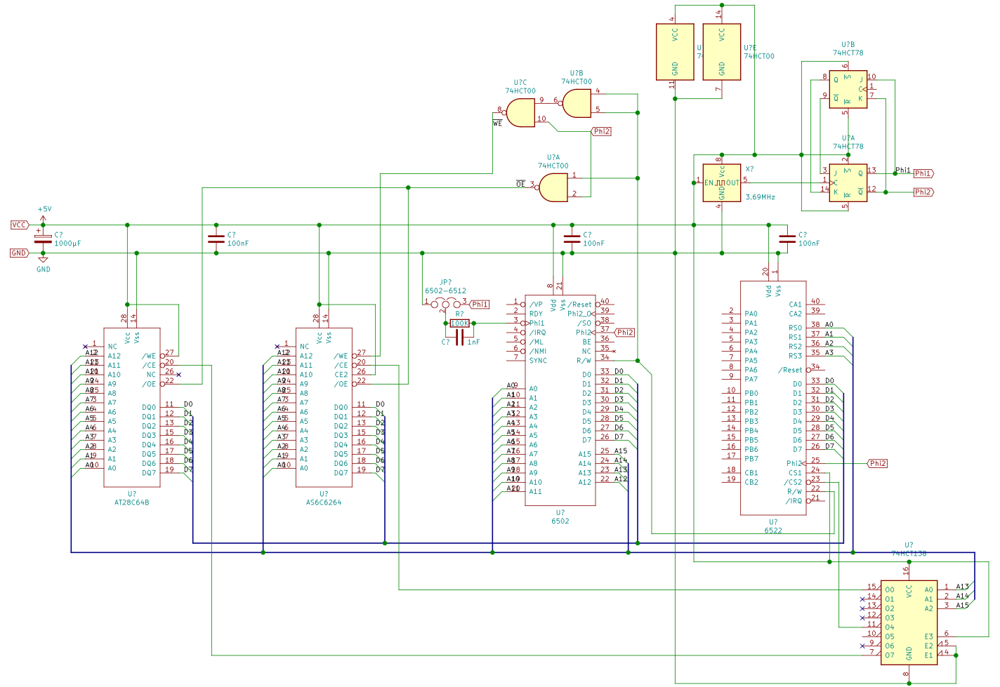

PostPosted: Thu May 30, 2019 1:07 am
I've got some way into laying out the schematic for this. So far it looks very much like a standard (if basic) SBC, as most of the effort has gone into making the symbols representing the 6502, 6522, RAM and ROM chips - as well as learning my way around KiCAD as I go. It's not a very "discoverable" interface, and it has a lot of traps for the unwary.
(Apologies to BDD for not making this monochrome - I don't need advice on this, just giving a progress report of sorts. I plan to separate some of the auxiliary circuits with labelled signals, to help declutter the main part of the diagram.)

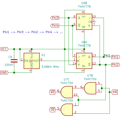

The 74HCT78 in the upper right corner is wired as a state machine to produce a quadrature clock from a 4x source. The latter is specified as a standard UART-frequency half-can CXO, but pretty much anything in the 1-4 MHz range should work. Having a quadrature clock means I can have the shift registers (not yet drawn) sampling both Phi1 and Phi2 phases at their midpoints - hence they won't be trying to sample signals which, in some cases, are specified to be unstable at the Phi2 clock edges (especially Phi1 and Phi2_O).
Since all of the support chips are CMOS rather than TTL, bus loading will be low, so even an NMOS CPU under test should be able to drive signals somewhat faster than specified - not to mention that typically a 1MHz part was simply one that failed a test at 4MHz, as in practice that was the criterion for the 2MHz speed grade. The truly paranoid might wish to use a maximum 2MHz oscillator, so that even a 1MHz NMOS or early-CMOS part is within official spec for midpoint sampling at 500kHz. The 1.8xx MHz oscillator that the 6551 takes will be fine for that.
Three-quarters of a 74HCT00 produce the qualified /OE and /WE signals, and a 74HCT138 decodes the top three address bits to provide chip-selects. There'll be one more output used from the '138 when I add the Adafruit display connector, and I may add a conditional qualification of the decode signal by Phi2_O to help deal with the corner case presented by the CMD 65SC102, which divides its clock input by 4 (and produces its own quadrature clock output on the Phi2_O and Phi1 pins). I think this extra circuit would sensibly use the remaining section of the '00.
Speaking of clock corner cases, a jumper arrangement to handle an optional 6512-required Phi1 clock signal is in - but presently this can't be detected by the machine itself. I'll need to rework that, and it'll most likely involve adding another 74xx chip.

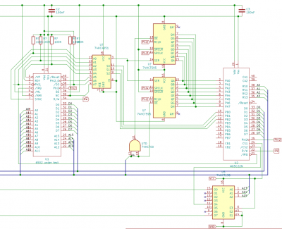

I think I can get away with installing just two shift registers (one driven by each midpoint clock), plus a multiplexer chip to actually connect to all the signals of interest. I can then use one of the address lines to select which parallel output is presented to one of the 6522 ports (as the 6522 itself is only partially decoded and thus mirrors many times), leaving the other port free to drive the multiplexer and some other diagnostic controls (such as the Phi2_O qualification of chip select, which would otherwise cause trouble with the 6522 when used with a standard 6502).

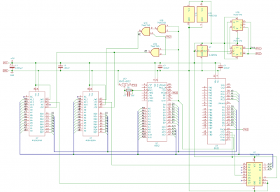

PostPosted: Thu May 30, 2019 9:30 pm
More progress today, wiring up the shift registers and cleaning up the schematic layout somewhat. The quadrature clock signals (Phi3/4) are also now properly labelled.

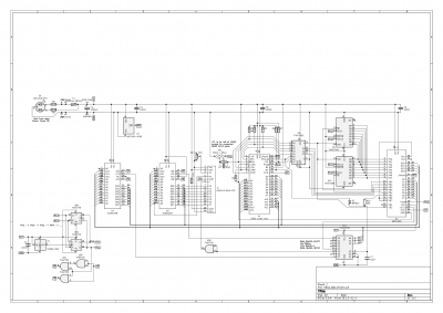

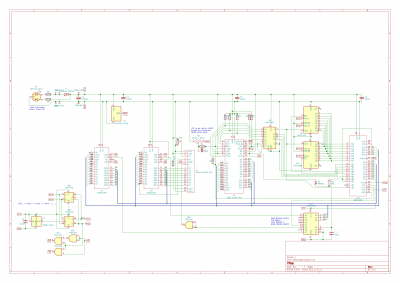

PostPosted: Mon Jun 03, 2019 3:10 am
Finished at last, at least in terms of the schematic.
I included a polyfuse to help guard against putting a completely non-6502 chip in - hopefully it'll heat up and go open before any chips do - and a bi-colour LED to indicate whether it is open.
I had to take an "interesting" tack for qualifying the /CE signals, to minimise the chip count. The reason /CE is qualified by Phi2_O at all is because there is one 6502 variant in which the Phi2 input is not directly usable as the system master clock, as it is internally divided by 4 and turned into a quadrature clock. This is not really a problem for reads, in this particular machine, but a single write will appear to be 4 consecutive writes - hopefully to the same address as each other. The VIA and RAM can probably cope with that, but the LCD module would probably object. OTOH, I can't unconditionally gate /CE, because that would violate the timing requirements of the VIA (/CE valid before Phi2 rises, but Phi2_O trails Phi2).
The system comes out of reset with the VIA ports at high-impedance input. So by default the Phi2_O pin will charge up the little capacitor through the Schottky diode, and thereby hold the '138's enable input high. This should be true even for the '816, where the Phi2_O becomes VDA, since the first valid accesses the CPU makes are data fetches (the reset vector), and every opcode fetch also drives VDA high. One of the first tasks of the Reset handler will be to configure Port B so that bits 0-4 and 7 are driven, not floating - as the W65C22N doesn't have bus-holding devices, unlike the W65C22S (which I can't use because TTL compatibility is needed to handle NMOS CPUs).
Subsequently, the VIA and shift registers will be reconfigured to sample the Phi2_O pin at the midpoints of the Phi1 and Phi2 phases, and a few instructions later it will be clear whether the Phi2_O pin is following the Phi2 clock faithfully or not. The VIA's cycle timers can then be used to determine (by executing an instruction sequence with known timing) whether the discrepancy is due to an '816-style VDA output or a divided clock. If the latter, the /CE gate can be turned on by actively driving PB5 low; this discharges the '138 enable whenever Phi2_O isn't actively driving it high. The need to do this is sufficient evidence to identify the '102 variants of the 6502 family, without examining the other pins' output, which is fortunate since the shift registers sample with the un-divided clock, not Phi2_O.
PB7 is wired to both PB6 and CA1, so that the Timer 1 pulse output can both be chained to Timer 2 for a long delay time (useful for the human-readable output phase of operations), and used to trigger a Port A input latching operation. The latter should allow more flexibility in sampling pin outputs during interesting instructions, rather than always having several cycles overwritten by signals associated with the VIA-reading instruction.
Now I get to explore the joys of PCB design, and incidentally write some software.
File comment: Mono version for BDD
File comment: In living colour…
Note that that is not true of the W65C22N like it is of the W65C22S. The N version's inputs are like LSTTL loads.
Can you get away with a 74HCT245 bus transceiver, with the direction determined by R/W\?
