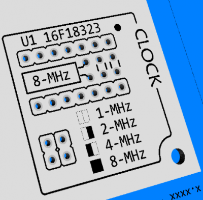

PostPosted: Sun Feb 10, 2019 4:58 pm
Posts: 588
What kind of resolution and range? Is 1.0-MHz through 20.0-MHz in 500-kHz increments enough? How do you want to select and display the frequency? Will a set of jumpers do? Or, a pot' (no display)? Or, a Rotary Encoder and OLED display? Or, a push button and a pair of 7-segment displays?
You might consider using one of a number of PIC microcontrollers that come equipped with a 20-bit NCO peripheral module. After connecting power, a crystal, and allocating a clock output pin, an 8-pin version could provide three jumpers to select one of eight frequencies. A 14-pin version would have enough I/O pins to employ any number of select and display options.
Food for thought... Mike
