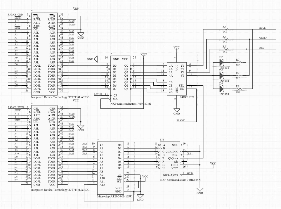

The current circuit is pictured here without the CPLD included in the diagram:
Memory is divided into Even (Character data) and Odd (Color data) addresses from the MPU side

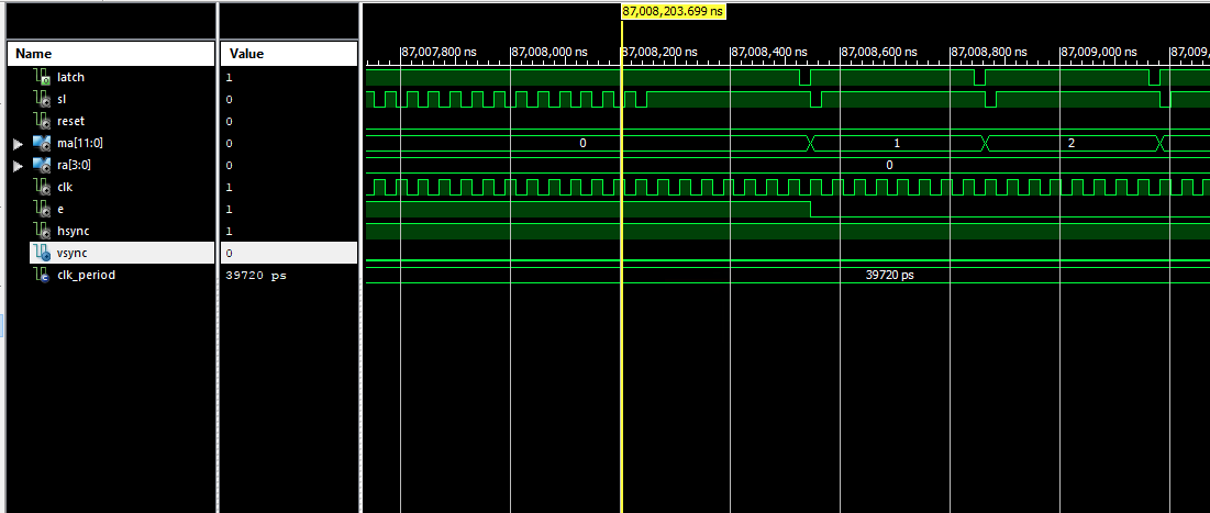

Interestingly the ROM is so slow (150ns) that to get it working I have to load the shift register just before the rom is pointed to a new address
As a matter of fact if you look at the timing from the RTL Simulation you can see that the shift register is loaded at the same time the MA output changes, presumably the SRAM and ROM delays are just long enough for this to work...
SL = Shift register Load
E = Video output enable
I could load the shift register sooner than that by a couple of clocks but that'd push the first X pixels off the left hand side of the screen. since the horizontal count is in characters rather than pixels I can only really load shift register right as the address is changing (and this is why I need to latch the color data at around the same time). how was this done with CRTC based systems?
This results in an 80x30 display with 16 colors foreground/background that works almost perfectly. At the moment I don't have the second SRAM to store the color data so I've been testing by connecting MA0-7 to the inputs of the color latch.
The only problem I've had is that I can't get the color to sync up with the characters perfectly
Basically the color data seems to change just after the character does, resulting in the first pixel of the character being the wrong color. tuning the latch output to load sooner/later just pushes it over one side or the other. never matching up perfectly with the character data
I'm going to see what happens when I actually source the color data from RAM, as well as replacing the HC logic with AC logic to tighten things up a bit.
I probably need to add a second latch after the color mux too?
Any pointers would be appreciated!

Thanks Cray Ze, I had tried delaying the character pixel as you said but it didn't solve the problem.
I'll also go through and remove IEEE.STD_LOGIC_UNSIGNED from my code thanks for that tip too!
After adding the extra SRAM for the color things look a little better but there's still a little problem with the first pixel of each character as pictured below
Interestingly it's only on the edge of some colors not sure why. but I'm almost certain the issue is actually due to the propogation delay of the 74HC273 which is 19ns keeping in mind that the width of each pixel at a 25mhz pixel clock is 40ns.
So I've ordered a couple of 74AC273s to see if that fixes it (fingers crossed!) In the meantime I'll clean up the VHDL as per your helpful suggestions

Replacing the 74HC273 with a 74AC273 solved the problem, though it didn't work properly until I added a 1K resistor between the CP input and the CPLD, Breadboard noise? I'm not sure whether to add this to the circuit when I go to PCB?
Switching the 74HC157 to a 74AC157 results in no text just the background color so I presume it isn't switching for some reason that is beyond me, I'll see what happens when I move to a PCB but it seems to work with the 74HC157 just fine anyway.
One last thing is that the characters are stretched because I'm using a 25Mhz oscillator instead of a 25.175 MHz as specified by the VGA spec for 640x480@60Hz and it seems that the timing difference causes my monitor to detect the mode as 720x400. I've ordered a 25.175 MHz oscillator.
Next step is to get it made into a 4 layer PCB so that I can eliminate a lot of the noise, even though it works on the breadboard there is some visible noise.
