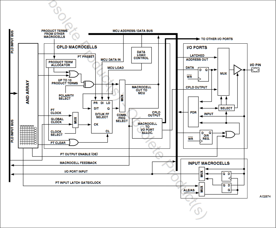

When spending some more thoughts on this:
What really would be cool would be having sort of "a small FPGA area" (nothing fancy) on the chip,
tied to some registers, up\down counters and comparators (ALUs would give more flexibility, of course).
This way, the "end users" could implement just the set of peripherals they really are going to need,
as there is a difference between building a CNC controller and a video game when it comes to peripherals.
Hmm... of course, programmable logic on the chip could work as glue logic for the CPU cores, too.
Edit: dug out the PSD8XX datasheet. Please take a look at the block diagram on page 52.
