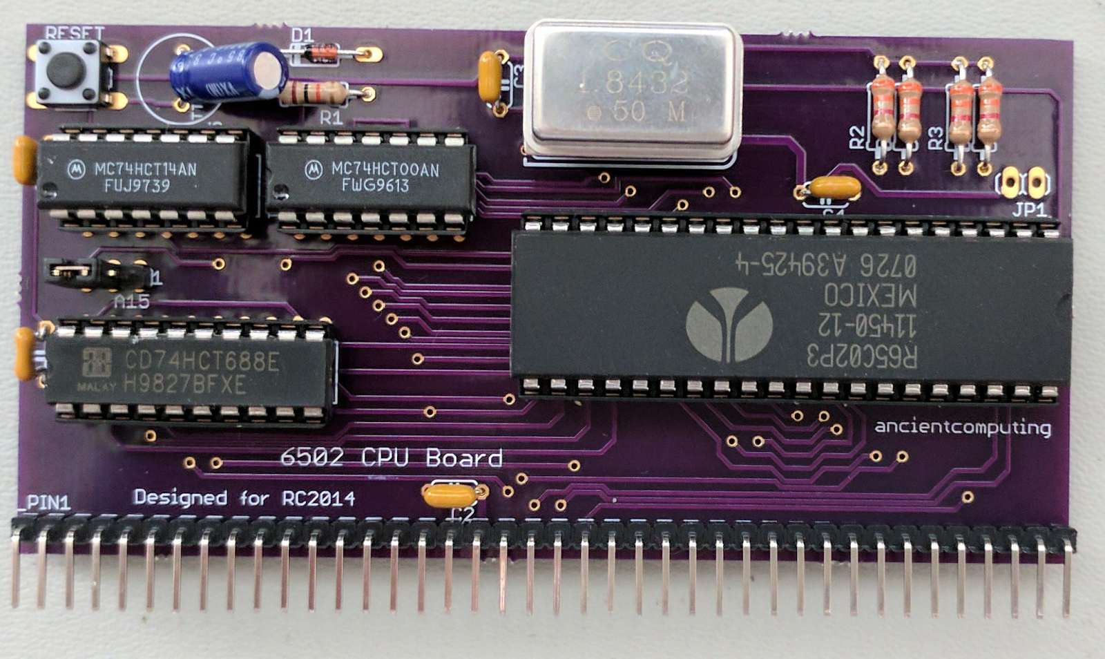

And you can even reuse (most of) the other RC2014 modules/boards.
So if you have been looking at the RC2014 community from the outside and don't want to learn Z80 programming (and hardware), but like the idea of a modular approach to building retro hardware, I have just what you are looking for:
A couple of articles in my blog (http://ancientcomputing.blogspot.com/) describes in some detail the hardware design and what RC2014 modules work with the 6502.
An initial Monitor/Debugger is available. It's based on the lite version Daryl's monitor but heavily modified so that the user interface is similar to my Monitor/Debugger for the Z80 on the RC2014. Many thanks to Daryl for making his code available.

There was a small mistake in the Readme.md in the schematics directory on your Github repo: Pin 1 of the 65(C)02 should be grounded UNLESS you're using a WDC chip, not IF you're using a WDC chip. The picture above is wrong too: it should have JP1 in place with a Rockwell 65C02 mounted. I filed a pull-request in Github to fix the documentation.
Great project! I was thinking of designing something similar (and I was going to name it "RC1402", feel free to use that :-) ). Are you considering making this available as a kit? I might be interesting in buying one.

Thanks for the correction, Jac. 've fixed the documentation. You're the first contributor! :)
To be honest, I had no problem using the board with pin 1 disconnected. I'd tested out with a CMD and a Rockwell 65C02, and also a Synertek 6502 at frequencies from 1MHz to 3.072MHz.
That's probably why WDC felt that they could "reuse" the pin: leaving it disconnected with the older 65x02 didn't result in anything bad...
Regarding making it available as a kit: absolutely no plans. This is to avoid any appearance of conflict of interest with the day-job. However, nothing prevents anyone else from doing so.
Yeah, the pin is probably just connected to the substrate, just like pin 21. I don't know much about CMOS vs. NMOS properties but I have a feeling that it was probably more important on NMOS chips to keep the voltages stable all across the chip. NMOS needed more current (so more voltage drop, I reckon) and I'm pretty sure early chips were made bigger than they are now, too.
Either way, your mileage may vary so pin 1 should be connected on non-WDC chips and (because it's an output) should be disconnected on WDC chips.
