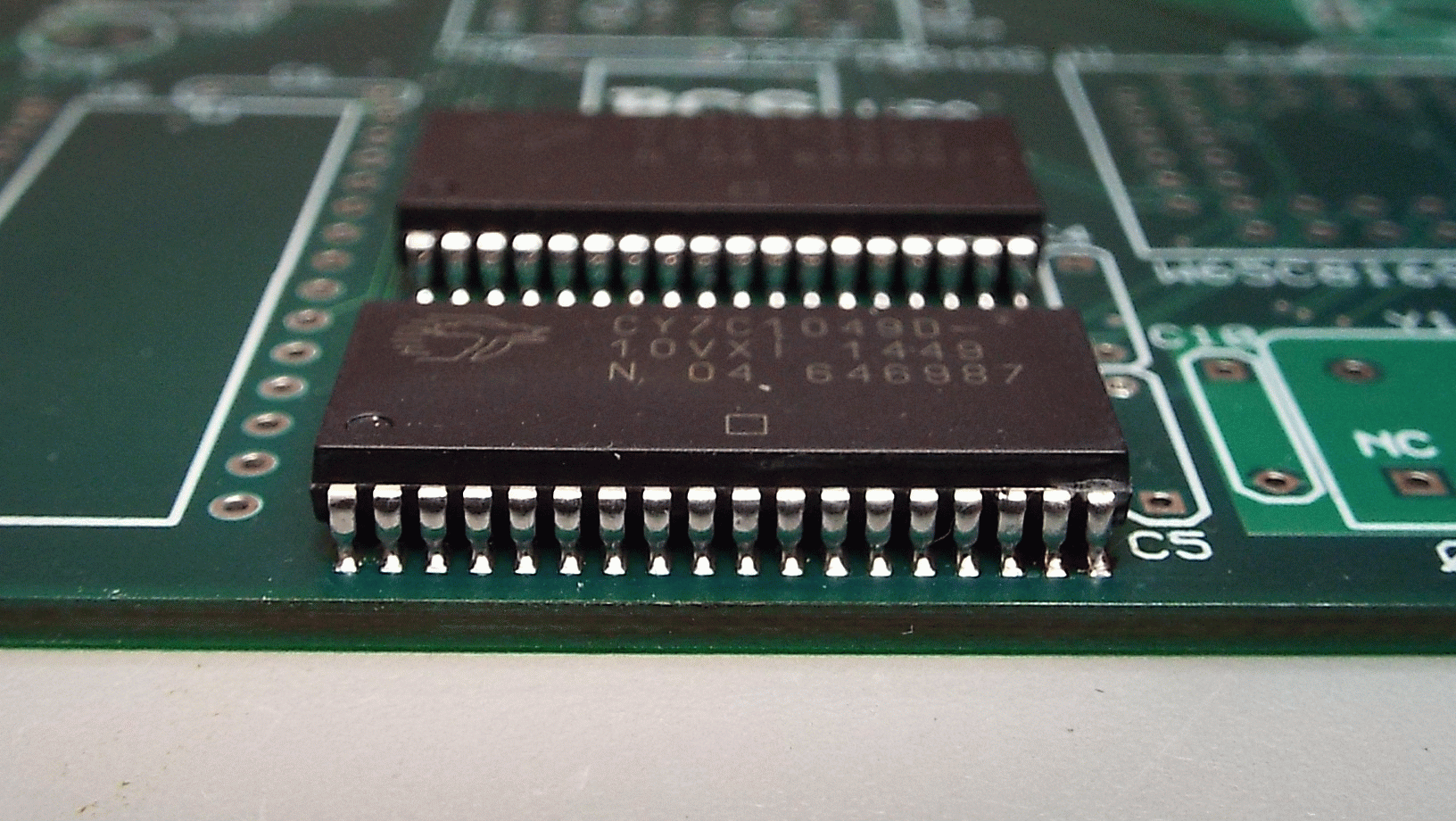

As for the DIP SRAMs, I'm afraid those are going the way of the dinosaur. SOIC packages predominate but can be manually soldered. See below, which is the SRAM on POC V2. Garth Wilson soldered those for me, as my vision is too weak to allow me to do such close up work anymore.
File comment: SRAM in SOIC

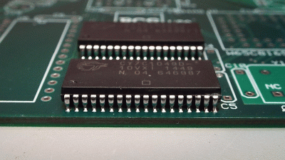

I did those with my 30W iron with a 1/8" chisel tip that covers three pins at once.  I didn't use any extra flux, a magnifier, any solderwick, or anything special.  I don't do one pin at a time.  Here's the method:
  • Tack two opposite corners just enough to hold the IC in place.  It doesn't have to look nice yet, but you do need to get the IC straight and centered before continuing.
  • Put some solder on a third corner, at the opposite end of one of the first ones you did.  This will hold the IC in place in the next step.
  • Now go down the other side, starting with the corner which so far got no solder.  Flood that side, making one big bridge all the way down, moving the soldering iron back and forth, making sure all pads get wetted too.
  • Do the same thing to the remaining side which up to now only had the corners soldered.  Now you'll have both sides all bridged, with lots of extra solder.
  • Go back to the first side you flooded.  Hold the board vertically, with that row of pins vertical, and start with the soldering iron at the top of the row, and re-melt and move it down slowly.  The extra solder will come off on the iron.  You might have to shake some off before you get to the bottom of the row, if there's a threat that it will drip onto something it shouldn't.  Continue down the row.  Each pin should be left with the right amount of solder, just perfect, with no bridging, in spite of the large size of the tip.  If I have trouble with an area, I'll put more solder on it again and repeat.
  • Do the other side the same way.
After it's cooled, I chip off most of the rosin with any small tool, preferably one that's not too sharp so it won't scratch the board, then finish with a Q-tip dampened with acetone to get the slight remainder of rosin off.  That way I don't need a vapor degreaser, or to dunk the whole board in solvent, etc..
It may seem very counterintuitive, but the results in the picture speak for themselves.  I don't think I've done finer pitches than .050" this way.  They might require something a little different.
