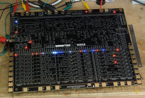

Just posted on the mos6502 g+ page:
Breaking news! Eric Schlaepfer has just broken cover with his MOnSter 6502 project - using quad MOSFET surface mount transistors he was able to duplicate exactly the NMOS 6502 netlist as used in the simulator at visual6502.org - by using MOSFETs he avoided the pitfall of most low-level recreation attempts, which is coping with the bidirectional switches between the internal busses.
The starting point was to calculate the size of PCB - on estimating that it might be about a square foot, the project was on. There's more project timeline in the blog at
http://tubetime.us/?p=346

Oops, I should have linked to the main project site: http://monster6502.com/ where you'll see
"The maximum reliable clock rate is not yet determined, but we expect it to be in the tens to hundreds of kilohertz range."
Also noteworthy: the foot-square PCB took ten weeks to route, by hand.

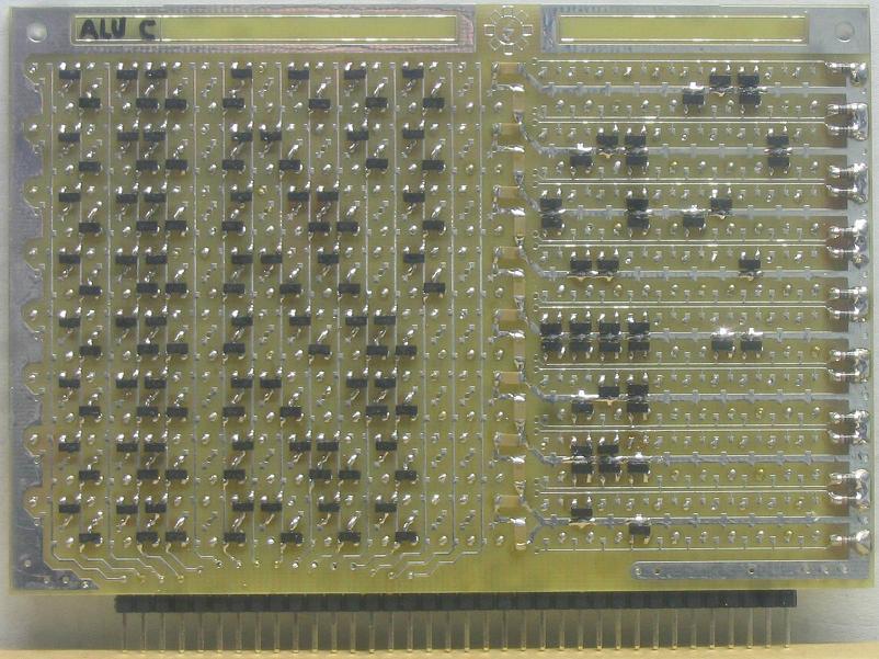

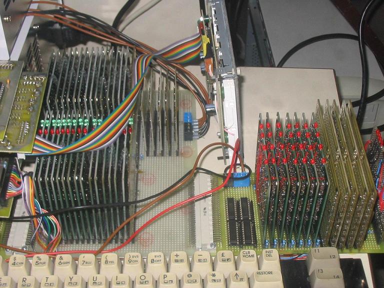

On a related topic, now is a good time to remember that 6502.org's own ttlworks is also the maker of a discrete-transistor CPU, although his MT15 is not a 6502 replica. Links to more photos can be found here. And his Technical Articles Folder has more on his custom CPU's, including the 3000-transistor MT15.

Jeff, thanks for mentioning MT15. :)
Gate capacitance of nowadays MOSFETs still is a bit too high, that's the problem.
For instance, if one wants just to build a single CMOS inverter with logic level MOSFETs,
making it faster than 3MHz probably would drain > 30mA from a 5V power supply.
So bipolar transistors like BC847\BC857 seem to be a much better choice
when trying to build a transistor CPU...
Unfortunately, the 6502 architecture deliberately aims at FET transistors,
transfer switches and such.
And without understanding the NMOS 6502 down to the smallest little detail,
starting a redesign for being able to build an implementation based on
bipolar transistors won't have much chance of success.
That's why I haven't tried to build something like a transistorized 6502.
MOnSter 6502 certainly is an amazing and fascinating project,
congratulations to Eric Schlaepfer and Evil Mad Scientist Laboratories !
A 4 layer PCB of that size sure isn't cheap, and as a designer you can't exactly say
if the prototype would be working at all until you are through with soldering
thousands of tiny SMD parts. :)
BTW:
Since PCB prices go down pretty much when ordering a lot of identical PCBs,
MT15 was a bitslice design. One Bit per PCB...
What had limited the speed in MT15 was, that the inverters showed a hysteresis
to the input signal which increased when frequency increased,
but unfortunately I wasn't aware about this effect from the start.

The "traditional" approach to building a PLA would have been a diode matrix ROM.
Unfortunately, you can't just build large diode matrix ROMs,
current and capacitance puts a limit to that.
Back then, BC847\BC857 SMD transistors were in the same price range as 1N4148 SMD diodes
(while having a smaller package).
And unlike diodes, transistors do current gain...
So when building the MT15 PLAs, I had decided to go for CTL instead,
"complementary transistor logic".
Basically, CTL is sort of an "outgrow" of ECL emitter dotting.
For instance, a two input CTL AND gate built with BC847\BC857 feeding a 330 Ohm load
could have a propagation delay of less than 5ns because the transistors just are
"clamping" a voltage without working as a saturating switch.
Outputs of CTL AND gates can be wired_ORed together and tied to one single
pull_down resistor to form AND\OR combination gates,
did this with the outputs of two PLA PCBs.
I wasn't sure if CTL would be working as intended... but it did.
http://6502.org/users/dieter/mt15b/mt15b_1.htm
BTW: just in case that somebody might try to build a bipolar transistorized 6502,
my advice would be to go for a 3.3V power supply, to make massive use of CTL,
and to build inverters with BSV52 transistors (Schottky clamped with a LL101).
Adding a resistor (some kOhm) in parallel to the LL101 seems to fix that
little hysteresis problem I had mentioned... although I have no idea, why. :lol:

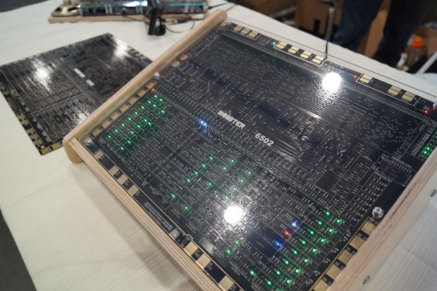

Here's Eric Schaepfler walking through a demo of the Monster 6502:
https://www.youtube.com/watch?v=73h4cjTeX44
via the article at http://makezine.com/2016/05/27/this-fun ... microchip/
