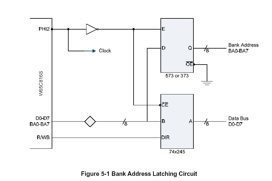

26-33: Data pins D0-D7/Address pins BA0-BA7 (Bidirectional). The 65816 can access 16 MByte of data, which requires 24 address pins. However, only 16 (9-20, 22-25; see above) are dedicated to the address. The other eight share double-duty with the data bus. Roughly: With the 6502, when PHI2 (Clock, pin 37) is high, the data is driven on the data bus (fans of Star Trek Next Generation will remember that "Data always takes the high road"). When PHI2 is low, neither the processor nor the system drives the data bus. This means there is "dead time" between individual reads and writes that is nominally half of the cycle. The bus is relinquished to the system. With the 65816, there is no more dead time: When PHI2 is high, the processor drives the data bus as usual. During PHI2 low, the processor drives the Bank Address to on these pins. This happens even in emulation mode, though only zeros are fed to the system.
(Note the address and data buffers can be switched off externally by asserting BE ("Bus Enable", pin 36) so that other devices can use the busses. See below for further discussion.)
There is a standard circuit in the 65816 data sheet for dealing with this situation:
For the data bus, use a buffer such as the 74ABT541, gated to high-Z-state when PHI2 is low. For the bank address, use a latch such as the 74ABT573 or 74ABT245 when PHI2 is high. If you only access the "original" 64 KByte bank, you don't need the latch. Note that this all becomes slightly more complicated because of the VDA/VPA pins. See the discussion about qualifying this circuit with those signals in this thread.

26-33: Data pins D0-D7/Address pins BA0-BA7 (Bidirectional)...There is a standard circuit in the 65816 data sheet for dealing with this situation:
...Note that this all becomes slightly more complicated because of the VDA/VPA pins -- see above.
It should be noted that WDC's circuit may not work as expected due not being qualified by VDA and VPA. The state of the MPU's D0-D7 pins is undefined when the expression VDA | VPA is false (where | means logical OR)—that is, during an invalid memory cycle. If the MPU is in such a state the above circuit will potentially latch garbage when Ø2 goes high. Complicating matters, if the MPU is being held in a wait-state due to RDY being negated, WDC's circuit will repeatedly unlatch and latch as the Ø2 clock cycles. Either of these conditions may trigger anomalous system behavior.
Also, the use of the inverter on Ø2 to condition the E input on the latch causes the latch to close slightly after Ø2 goes high, due to the inverter's prop time being added to the latch's internal response time to E's change of state. This may create a timing "race" condition in which D0-D7 may be driven with data slightly before the latch closes. This can be avoided by generating a two-phase clock from a D-type flip-flop (mentioned below), with one of the flop's Q outputs driving E and the other Q output driving the MPU's Ø2 input (as well as the Ø2 inputs of any 65xx I/O devices in the system).
It seems to me the WDC circuit will latch invalid bank addresses just fine. :) Is that a problem? VPA=VDA=0 tells us when to inhibit memory and IO due to an address that can't be trusted. Every address is 24 bits, and the bank address is simply the MS 8 bits of that. I don't see any advantage if the WDC circuit were qualified by VDA and VPA as you suggest.
[Edit:] IO and memory are expected to retain their contents, which is why they require VPA/VDA's protection against invalid accesses. But there's no requirement for the latch to retain its contents. Updates are continuous, each relevant only to the current bus cycle. I guess that's what I should've said in the first place! :roll:
Oh, I don't doubt that the WDC circuit will latch whatever shows up on D0-D7. We're thinking in terms of memory and I/O, but what if the glue logic itself reacts in some unanticipated way to a bogus bank address? That is something the designer might want to contemplate.
PostPosted: Sun Aug 16, 2015 4:14 am
Regarding bank addresses, "latching whatever shows up on D0-D7" is the full extent of that circuit's job description, isn't it? It seems to me that as long as the circuit succeeds in doing that then it's satisfactory.
If your concern is glue logic then it was confusing to instead criticize WDC's circuit (which can't be expected to prevent dummy bus cycles -- we're stuck with 'em!). But I'm happy to agree we need to keep our eyes open for unanticipated reactions.
I hope no-one overestimates the prospect of using VPA and VDA to qualify the enable input of the latch, keeping it low during dummy cycles (VDA=VPA=0). Although that will prevent an invalid bank address from appearing in the latch during a dummy cycle, what will appear instead is the leftover bank address from the previous cycle.
That means the bank address is running a reproduction of the previous cycle -- while other signals such as R/W and A15 - A0 are running the actual cycle (the dummy). Even if those other signals were also reproduced, it's still doubtful whether you'd want that cycle overlaid, glue-wise, on the dummy cycle. (For example, if the previous cycle triggered a wait-state, do you want that behavior for the dummy? Probably not.) To be attractive, the idea of qualifying the latch with VPA/VDA needs to offer a desired behavior and compare favorably with alternative remedies which are quite simple. I certainly wouldn't view it as a magic bullet or a routine precaution. [Edits...]

I'm still not convinced, because this
Tor wrote:
My guess is that when BDD said "verboten" it is in relation to setting up a protected execution environment (as BDD wrote later in the paragraph).
Correct. Whatever term is used to describe these instructions, they would either be instructions that should never be executed (STP immediately comes to mind) or should not be executed when the system is operating in user mode.
will result in a highly complex system. In my opinion the out of the box 6502/816 is not suited for a protected OS. In addition this would not only require inhibiting privileged instructions but also some sort of memory protection scheme, which, especially for the stack, will be very tricky. Without a dedicated supervisor mode stack pointer it is in my opinion near to impossible. If you are interested in building a protected OS you should rather look at other "legacy" architectures which are as well fun to play around with. For this I have my DCJ11A based SBC.
Use of VDA and VPA is as simple as connecting them to an OR (or NOR) gate, which is all that is needed to qualify bus cycles. It certainly isn't complicated. In a pinch, a couple of fast Schottky diodes and a pull-down resistor will work as a "gate."
As I said, my designs lack of PINs, no matter how I design a system, I always end at the point where I have to remove functionality in order to match the capabilities of the GAL/CPLD and VPA/VDA are one if the first signals that are eliminated.
With some non-65xx I/O devices there could be quite a bit of configuration required following reset (the 16550 and 26xx NXP series UARTs immediately come to mind). The most efficient way to carry out that configuration is to use indexed addressing to read a data table of registers and the values that are to be loaded into them, followed by indexed addressing to write to the registers. With the '816, such programming demands VDA and VPA qualification, since indexed addressing generates at least one bogus bus cycle per instruction.
Today memory size and ROM image size is mostly of no concern, so the very few bytes that avoiding these addressing modes could incur are not relevant. And even then, by using tricks like not using X=0 as the first address but instead using X=$80 and using "sta <address>-$80, X" you can avoid spurious access to IO registers even when using these addressing modes. I don't think that this will be overlooked by others. Keep in mind that the good old 6502 showed the same invalid cycles and has none of these output signals and still everybody could work with that. Just look at the way IO registers were accessed in a Apple II system.
I think that the percentage of cases where VPA/VDA are required or useful is very low.
