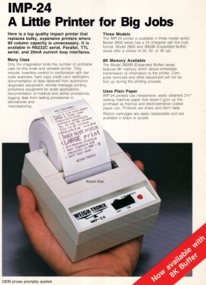

This isn't particularly 6502-related; but for printing needs in portable or miniature applications, it occurs to me that I should bring attention to the tiny dot-matrix impact printers from Weigh-Tronix. They use standard adding-machine paper, have RS-232 interface and a very large print buffer, are available in AC and DC models, and print up to 40 characters per line. I used one about 20 years ago at work, and it looks like they haven't changed much. The page of choices is here.
Edit, Oct 2022: The image I had linked to is gone, so I scanned a brochure I had here of one of the variations. There's lots of information on the back too, about specifications and options; but since it's no longer available, it seems kind of pointless to add that.

It's . . . it's . . . it's so cute!
It'll be a printer when it grows up! <gushy mode=parental>Who's the pretty printer? You are! Why, yes you are!</gushy>
All kidding aside, 40 characters on a standard adding-machine paper width is going to be nigh-impossible to read. ;)

All kidding aside, 40 characters on a standard adding-machine paper width is going to be nigh-impossible to read. :wink:
It would be about like 160 on standard 8½"-wide paper, which although small, is no problem to read. I do 136 on 8½"-wide paper all the time (still at six lines per vertical inch) for program listings and other things, with my old Epson dot-matrix impact printers on fanfold paper.
I used one of these tiny Weigh-Tronix in one of the automated test equipment setups I did. I took the cue from a bondwire-strength tester used at my previous place of work, a VHF and UHF power transistor manufacturer. After a bondwire machine was set up, they would take some transistors done on it and see how much force it took to pull the bondwires off, to see if the tiny welds were adequate. Similarly, they would take a small sampling from each lot of transistors in production to verify the bondwire integrity.
We had more tests to do and more results to print out than the bondwire-strength tester did, so I figured the tape would just get longer. The idea was that if a product failed one or more of its dozens of tests, the results would be printed out and rubber-banded to it and it would be sent to the repair station. Space would also be saved on the test workbench. It worked, but I soon decided the description of each test should be less abbreviated, and the test limits should also be printed on each line—or something like that. I don't remember the details anymore, but I went to a wider printer after that, in order to get a clearer, more informative printout, even if it did take up more space on someone's workbench as he was doing the repair.

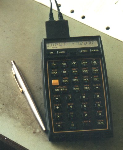

I never did get that one though, partly because it was twice the price of the Weigh-Tronix and I didn't really need for a printer to fit in a corner of my attaché case anyway.  I've only used full-sized printers with the HP-41cx.  [Edit:  Years later, I did get an HP82161A mini printer pretty cheap on eBay.]

Here's the same printer, but from 1980's and with an IEC interface:
Notice that the case is *EXACTLY* the same as the Weigh-Tronic one. Right down to the plastic detail.
I would assume there is a printer manufacturer that both Fidelity and Weigh Tronic buy from.

This isn't particularly 6502-related; but for printing needs in portable or miniature applications, it ocurs to me that I should bring attention to the tiny dot-matrix impact printers from Weigh-Tronix.
Darn if that thing doesn't strongly resemble a Star Micronics receipt printer from the 1980s.
