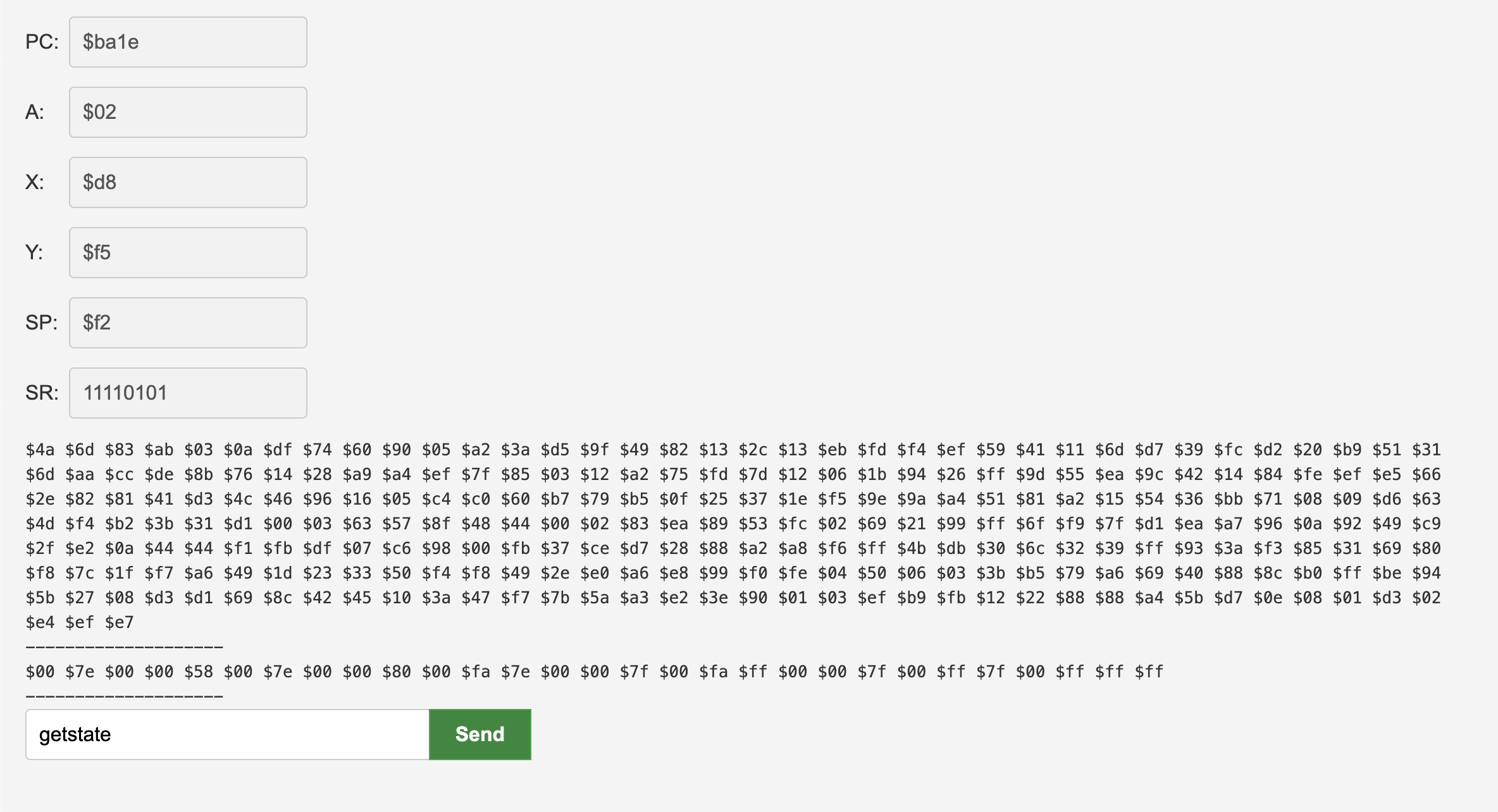

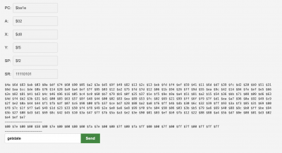

Nice kalj, it helped me to do something similar but then in the browser. I'm using the experimental Web Serial API (only the Chrome, Edge and Opera browsers support it). But I managed to create a simple web app that is able to connect to the device and send commands to the W65C02SXB board and receive data. It is not finished yet but here is a screenshot of what I made:
I only implemented the info, getstate and read memory commands (that was needed for the getstate command. I can create buttons for some command to make it easier like for the getstate command. It could use some polishing the received bytes good be presented better.
I would be awesome to create an in browser IDE for the board. But that would take some time to build. I will make it available on the web some day and also make it opensource so you can all have a look at the sources.

Do you or anyone else have an idea where those 29 info bytes stand for? Information about the board?

Looks like someone’s superannuated 65C02 code.  :D  Other than some seemingly-gratuitous absolute-long instructions, very little of it is native-mode 816 assembly language.

Ah I see, sxb.s lines 374 to 432 is the same it says $04 - REGISTERS. So is this a dump of the registers? I just see some loading of bytes into the A register and transmit character in A on FT245. Or these byte the addresses of the memory positions where the status of the registers are stored? From monitor.s of kalj his disassembly #define STATE_A $7e00. I can see the second and third bytes from the are the same sbx.s line 377 and 379.
