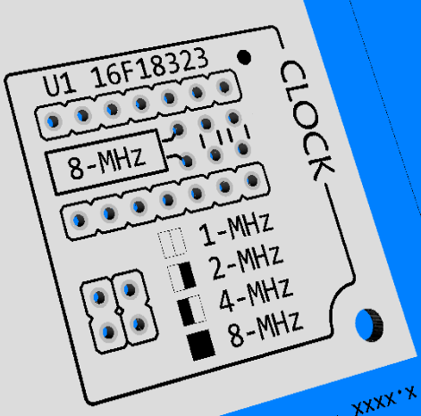

What kind of resolution and range? Is 1.0-MHz through 20.0-MHz in 500-kHz increments enough? How do you want to select and display the frequency? Will a set of jumpers do? Or, a pot' (no display)? Or, a Rotary Encoder and OLED display? Or, a push button and a pair of 7-segment displays?
You might consider using one of a number of PIC microcontrollers that come equipped with a 20-bit NCO peripheral module. After connecting power, a crystal, and allocating a clock output pin, an 8-pin version could provide three jumpers to select one of eight frequencies. A 14-pin version would have enough I/O pins to employ any number of select and display options.
Food for thought... Mike
The only problem is I need it to be selectable digitally by the machine so that it can slow itself down to talk to slower components. I could probably take this design and just use some via pins to ground the specific pins that select the clock, but at that point I think it's just about as efficient as using the 6900 and a digital rheostat.

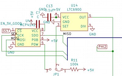

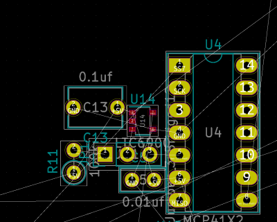

For reference, here's a picture of the schematic for the current solution, and how the chips look on the pcb:
I haven't actually placed this where its going to go, or routed anything for it yet, I've just bee messing with the layout.
EDIT: I see an issue with the schematic, I messed up the bypass capacitor on the 41x2, ignore that for the moment, I was really tired when I added this in this morning.

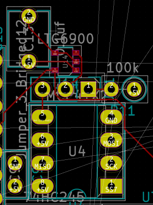

Why not just use the design I have with the clock generator controlled by a digital rheostat? Here's the updated final layout:
With a variable clock, I can set the board up while using a slow clock, and then start pushing it until it gets unstable, which could be at an odd number that's not available in an oscillator can (not to mention, I don't have to buy a bunch of oscillator cans to try). Is there an issue with running a clock like this?
PostPosted: Mon Feb 11, 2019 2:44 pm
Posts: 660
Location: North-Germany
As said on pg.8 of LTC DS the switching from one frequency to another by switching on/off a parallel resistor requires roughly 70µs to settle. Hmmm...
PostPosted: Mon Feb 11, 2019 4:46 pm
Posts: 346
Location: Knoxville, TN
Right, I forgot about that part, the 1799 is the same chip, but better, (higher frequency range) and seems to settle in only 25µs. Still very slow, but I wonder if it cleanly stretches or compresses the clock during that time, without any errant spikes.
The worst problem about this is, if it takes 25µs to settle, that means if we need to talk to a slower device, we must wait at least this long before attempting communication.
Maybe the 525 isn't such a bad idea after all?
