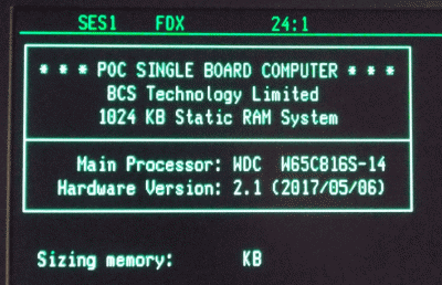

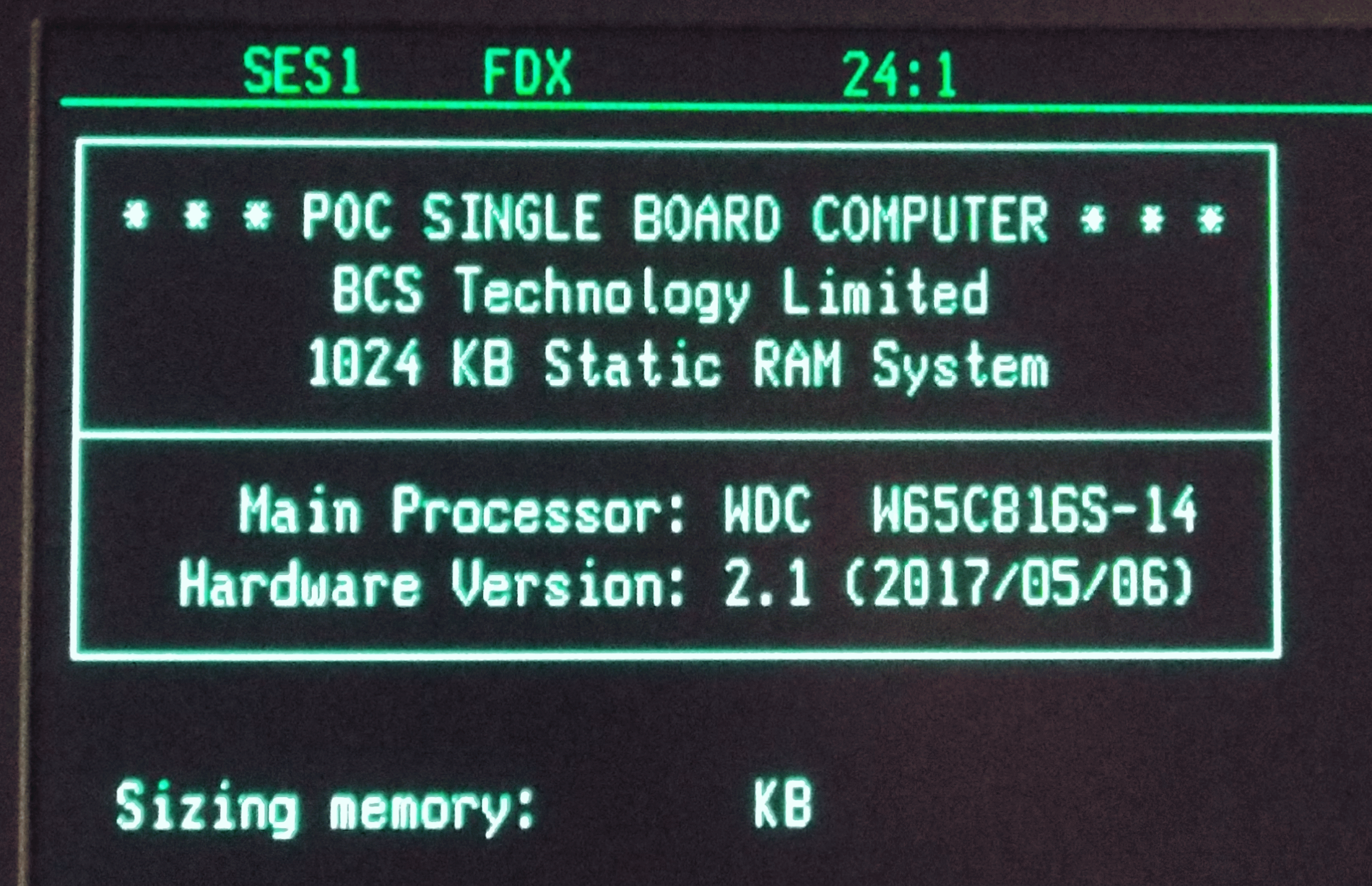

A little more progress. I've got interrupt-driven serial I/O working and can print the POST banner to the console.
POC V2.1 Banner Display
POC V2.1 Banner Display Closeup

Looking good!

BTW, I/O works on serial channels A, C and D at 115.2 Kbps. I brutalized the unit by writing a short program that was driving channels C and D at the same time, filling the screens with test phrases that were unique to each channel. It was interesting watching the /IRQ circuit while that was going on. :shock: I haven't tried driving A, C and D simultaneously because I only have two terminals with which to test.
I won't be able to test channel B until the firmware is finished, as that channel is wired to interconnect to one of my Linux boxes for software transfer. Much of the firmware can be "imported" from POC V1, with changes to adapt to POC V2's architecture. I'm particularly eager to see how the monitor will work with all that additional RAM.

Posts: 9426
