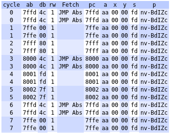

It's possible that an instruction such as JMP will be a worst case for address outputs, because the high byte of the address must appear in the cycle after it's read. See
http://www.visual6502.org/JSSim/expert. ... a&steps=20
But for control outputs such as RnW, Sync or VPA, VDA, VP, I see no such difficulty - the outputs should be direct from a phi1-gated latch. Timing will depend on load (and voltage, and temperature.)
