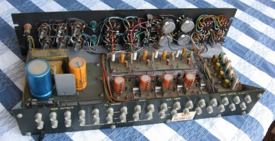

A lot of newbie builds I've seen over the years seem to bunch the wire together quite a bit (I saw one where all the wiring was neatly tie-wrapped together—naturally, it didn't work very well), which encourages mutual inductance and crosstalk, as well as parasitic capacitance. In any case, you're correct in that the inductance of longish leads may be more a problem than anything else, and of course, drive current won't offset this problem at any clock speed faster than a five dollar pocket calculator. Naturally, the best way to avoid this sort of trouble is to keep lead lengths to a minimum, and go with wire-wrap instead of patch-board. Of course, I "cheated" with POC V1 and started out with a PCB. :lol:
I found that out even in audio equipment I made as a teenager in the 1970's, before I got into digital:
The wires were initially all bundled, but that gave a lot of crosstalk which was relieved as soon as I removed the zip ties. I left the wires in position; but they were no longer pressed together.
But the way they had it neatly wired sure looked good didn't it? :wink:
