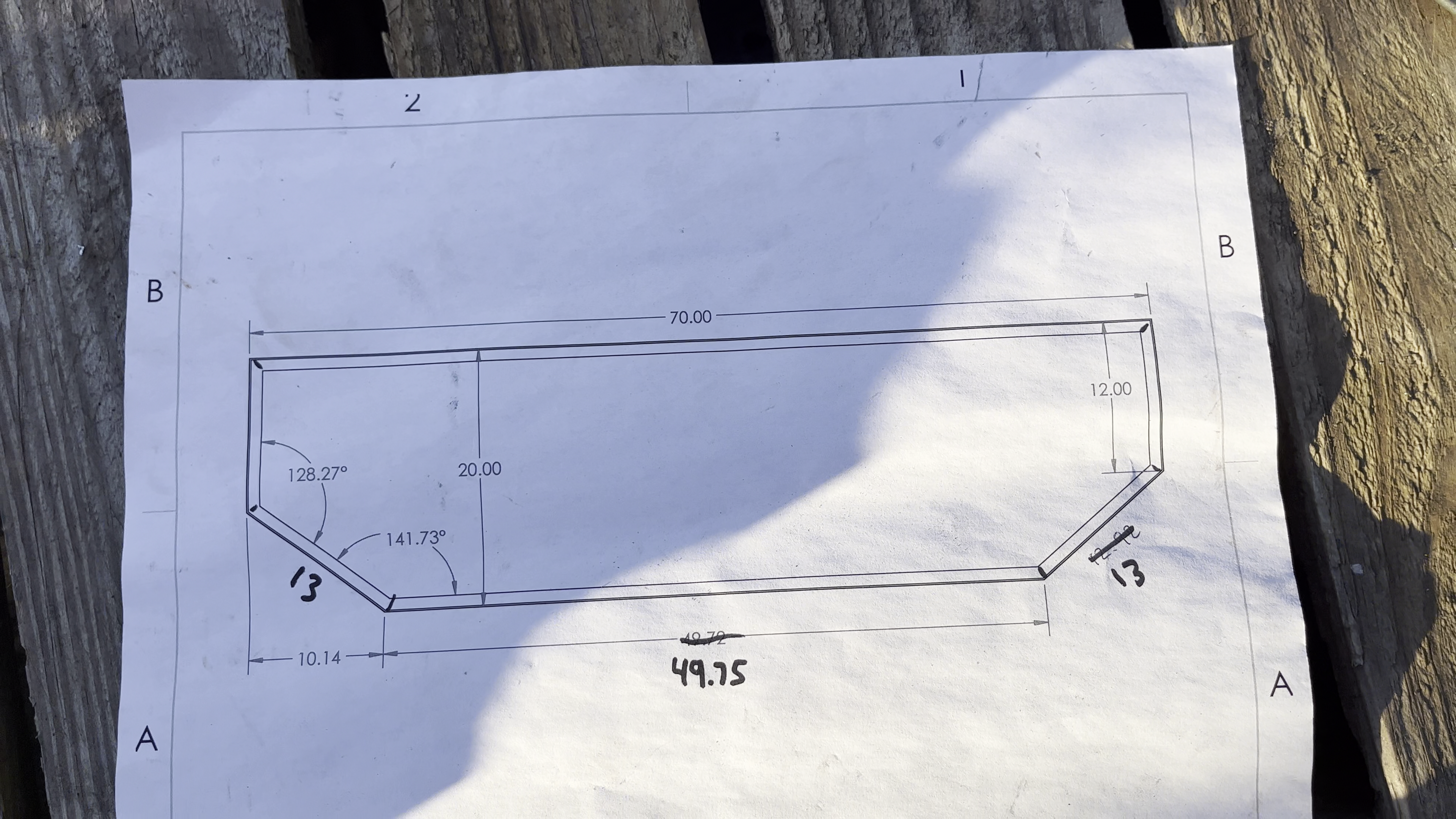

I have been busy up flying up North for work so I have mainly been working on the 6502 code for the sound channels and main OS. I built a tiny breadboard version with one channel that travels along with me so I can keep sane after the workday is done. Today I switched gears and took some time to start on the base frame so it would at least be done before the snow returns around here. Since I had not used my old welder for a few years, it needed work so by the time I had the sparks flying, the sun was already setting.
Did manage to get a lot of the base frame complete, which is the footprint for the entire unit.

Dimensions of the base frame that I am working on today...

Slowly working up the angles based on my sketch...
