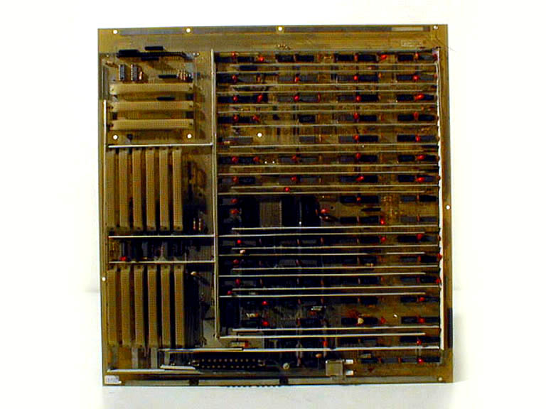

In ttlworks' photo of Andrew Holme's use of narrow strips of sheet metal, for best performance you would still want wires going across from ground to ground and power to power between ICs.
From another picture at Andrew's site, he had connected GND and +5V of a chip to one of the capacitors between the sheets.
BTW: nice Dilbert cartoon !
After I did an internet search, it appears that the trick of using sheet metal in the power supply isn't new:
...the interesting question when using sheet metal is, how to pull chips out of their sockets later if neccessary
without resorting to special tools. ;)
Would say, that two pieces of sheet metal connected to GND and +5V running in parallel might form up a neat high frequency capacitor.
Placing Teflon foil between two metal sheets probably won't be a good idea, because wikipedia mentions
that pyrolysis of PTFE is detectable at 200°C, and our soldering iron would have around 350°C.

Like you said, GND / VCC would still need o be "super-sized" for my project,
Uh, I'm not sure where you got that idea. What I was saying is that wire size has very little effect on inductance.
I was not speaking of wire diameter, just the number of GND / VCC connection points.
By having a set of solderable GND / VCC rails cross every IC in both the X and Y direction, I will void all potential ground loop problems.
I can't see this being any less effective than a real 4 layer PCB with inner VCC and GND planes.
Gotcha. That is very helpful.
The great thing that happens with a true ground plane is that the return current for any signal line flows through the ground plane, immediately under the signal line, taking the exact shape of that line. (This cannot happen if there are breaks in the ground plane like you would get with ground pours. This is why I've said many times that ground pours do not qualify as a ground plane in RF & fast digital work. In fact, sometimes antennas for things like cell phones are just a trace brought across a perpendicular slot in the ground plane at that point. I did design a chip antenna into something recently for 2.4GHz. 20 years ago I would have thought that was crazy. There is a way to use pours to supplement real planes; but if they're not done correctly, they can actually make things worse, according to experts in the field like Rick Hartley, Eric Bogatin, and Suzie Web whose lectures you can see on Altium's YouTube channel.)
If other parallel (not perpendicular) lines are closer than the ground return path, some of the return current will try to flow through those lines instead; so for example if a negative pulse goes out on the one signal line, it will try to induce an equal but opposite one on nearby lines that should have remained quiet. Ideally the distance from the signal line to the ground plane is closer than the distance to any neighboring signal line. We can't quite reach the optimum if we have super narrow trace & space and only two or four evenly spaced layers, but there's still a great benefit.
PostPosted: Thu Mar 30, 2017 9:08 pm
Posts: 8409
This is why a multi-layer PCB with internal power and ground planes is the ideal for high speed digital work. Of all the things that could go wrong with my POC units, poor signal quality, ground bounce and instability were not a concern. Building on a four-layer PCB was key. I also was meticulous about bypassing every device on the board, other than reset generators.

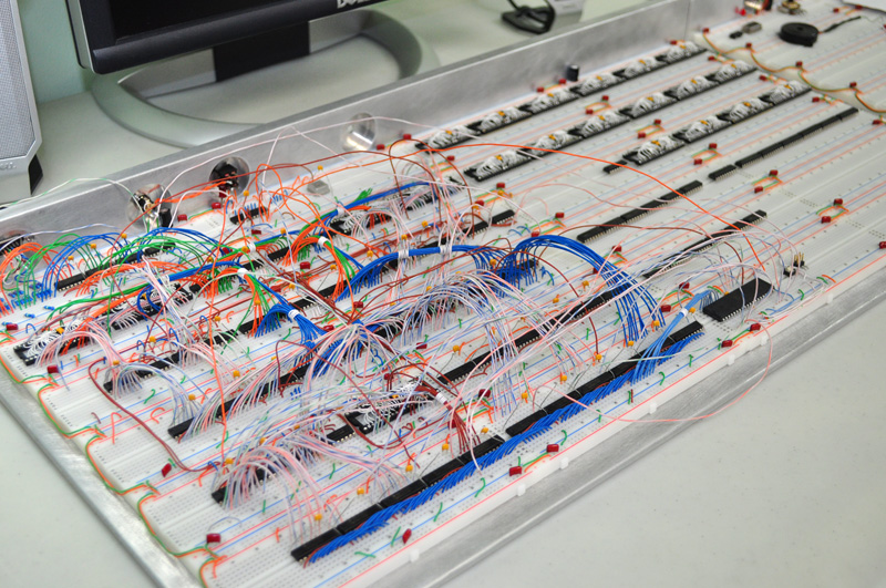

It has been a busy month, but I did get a day to work on the board last week.
Since the new Sync Generator is fully software programmable, I decided to experiment with different video modes.
At 640x480, these are somewhat limited, since it is only the vertical resolution that can be altered.
So, at 25MHz, 640x480 or 640x240 are really the only options, but that aspect ratio is not much good.
I have also been battling some serious capacitance issues with my clock routing at this speed.
So much so that, I had to "tune" some of the clock lines using a variable resistor!
A non-breadboard layout would certainly work later on, but these glitches will make testing very difficult.
During my latest experimentation, I went back to 20MHz, and revisited the 800x600 VGA mode.
At 20MHz, the horizontal resolution is fixed to 400, but there are decent vertical options available.
The system can now do 400x600 (default mode), 400x300, or even 400x200.
Actually, the vertical can be divided to any number whatsoever.
Just like the Amiga, multiple modes can be delivered on one screen.
A demo may have a 400x600 title at the top, but then do fast graphics at 400x300 in the center screen.
At 400x600 with 4096 colors, the images looks as good as 640x480, but there are no clock speed issues at all.
Seems that 20MHz is the "safe" zone for my giant breadboard, with 25Mhz being right at the razor's edge!
During my testing, I had to rewire most of the address lines, and alter a lot of once tidy wiring...
This is what it looks like before I clean up the wires.

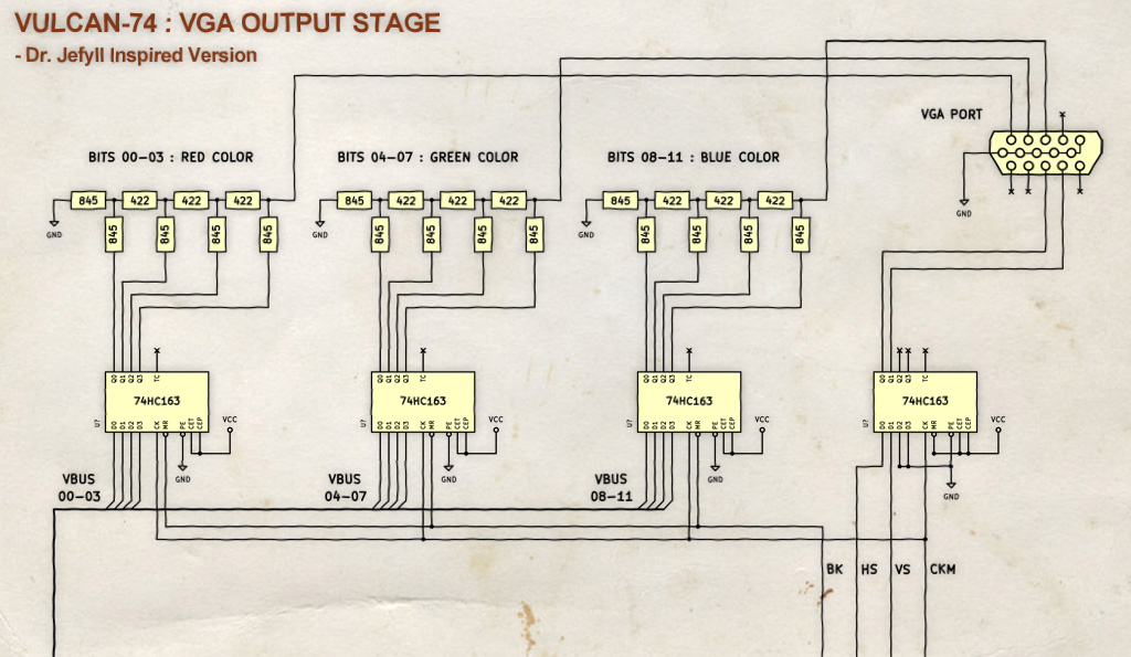

Here is the VGA Output Stage, which is just a simple circuit that aligns everything on the Master Clock...
VGA Output Stage.
VBUS : 12 Bit Video Data Bus
CKM : Master Clock (20MHz)
BK : Blanking Signal
HS : Horizontal Sync
VS : Vertical Sync
I originally used 74HC08 AND gates to sync the data to the clock, but I was bullied into trying 163 counters instead.
... and whadda ya know, it saved one extra chip! Kudos Jeff!
I will drill downward on the other parts of the schematic and post them when I have the time.
