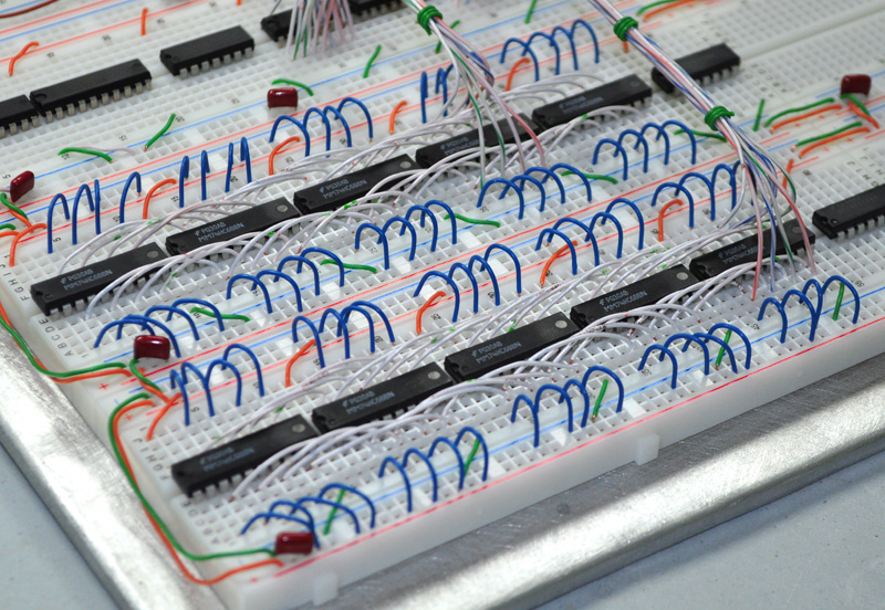

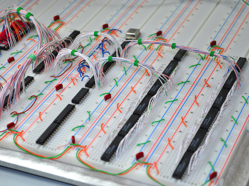

The damn black-flies were insane out in the back 40, so I came in for a quick wiring break.
Added 9 bit bus wiring from the X and Y counters to the Horizontal and Vertical comparators.

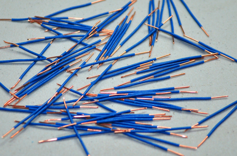

There are 10 x 8 bit comparators, so I cut 80 small wires. Go ahead, count em!
Each comparator is an 8 input AND gate. All input wires attached.
The top row of comparators are responsible for trigger the following events...
1) Horizontal Sync Pulse On
2) Horizontal Sync Pulse Off
3) Horizontal Blanking On
4) Horizontal Blanking Off
5) Horizontal Line Reset
The lower row of comparators are responsible for trigger the following events...
1) Vertical Sync Pulse On
2) Vertical Sync Pulse Off
3) Vertical Blanking On
4) Vertical Blanking Off
5) Vertical Line Reset
Each On and Off sequence triggers a Set or Reset on a 74HC74 Flip-flop.
Timings are based on the 40Mhz, 800x600, 60Hz VGA standard, divided in half.
Next photos I show will hopefully have pixels on a screen!
Cutting them isn't the bad part. It's the stripping the ends that would quickly become major tedium. :lol:

Hi BDD,
stripping the ends is no problem, with the right tool this is done fast. Good ones are not cheap, about 100USD, but they are worth it. It saves you a lot of dentist bills.

Posts: 652
I use a small Swiss Jack-knife. Just roll the end along the blade and pull.
Wires are cut and untwisted from Cat5 cable.

And in addition this requires more than 180 connections plus space and decoupling condensators for the 74HC688 plus the 74HC74 flip-flops. You should definitively consider GALs for that task. It's much easier. I would say two GAL16V8 would be more than enough. If you want that system to be the future "Game System" it has to be easier to implement. Ok, you could sell "building your own computer as 1000+ piece puzzle" as the introductory "game" :wink:

Indeed, it's almost insane how many wires and ICs I am going to use in this project!
But to be honest, I am not looking for an easy way. This is about using as many 7400 chips as I need to meet or exceed my original goals.
The more difficult this project becomes, the more fun I will have.
This is why I coined the project Vulcan-74, because it's almost pure logic.

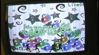

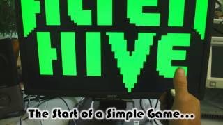

Here are some of my single chip Game Systems made over the last 10 years...
https://www.youtube.com/watch?v=CXFOTpM2Jn4

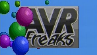

Single XMega over clocked to 60Mhz to bit-bang color NTSC!
https://www.youtube.com/watch?v=IRroMaaCAn4
FPGA with external SRAM clocked at 80MHz.

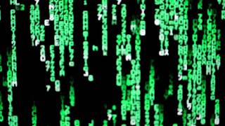

Matrix rain on a single FPGA.

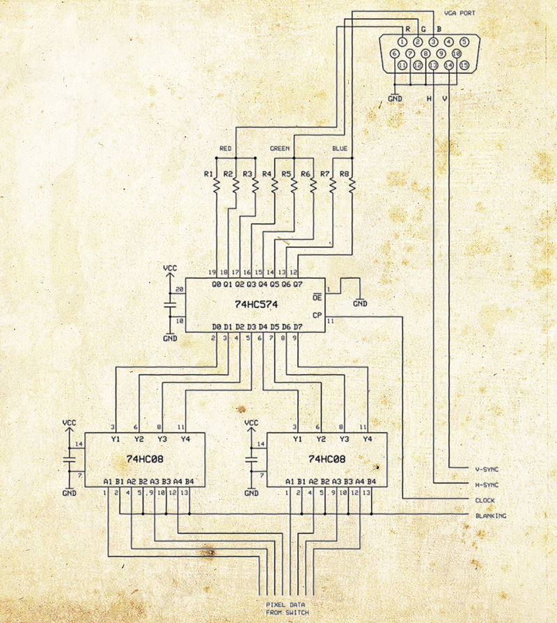

Here is a snapshot of the last segment of the video driver responsible for synced output and blanking.
The use of the dual AND gates keep propagation under my set limit.
Originally, I used 74HC157 data selectors, but they had a 20ns throughput.
One might ask... "why not just use the last 573 OE as a blanking control"?
... there is a reason!
Brad
PostPosted: Tue Jun 23, 2015 4:46 pm
Two reasons I can think of. Replacing the 'hc574 with an 'hc273 would solve one of them...
Love what you're doing, btw!
J. :)

PostPosted: Tue Jun 23, 2015 5:21 pm
Posts: 652
Thanks for the positive feedback!
Close on the 273, but it would suffer the same issue as the OE on the 574. Of course, with the 273, you wouldn't have to use pull-down resistors to hold the low level required during blanking, but alas, there would be another problem.
So far I have tried using 273, 373, 245, 157, and several other combinations until I found this one, which works perfectly for 400x300 or 640x480 speeds.
Anyone care to venture a guess as to what issue this odd circuit solves?
I bent my brain for many nights until I came up with the 74HC08 solution!
Brad

PostPosted: Tue Jun 23, 2015 6:07 pm
Right -- that's one of the problems I noticed. The other is that, on '574 (or '273), the prop delay from clock to output will differ from the prop delay from OE\ (or CLR\) to output. To provide the absolute timing regularity that video demands, it's pretty well obligatory to arrange things so a single clock signal updates both pixel data and blanking.
I would consider replacing the '574 with a pair of '163 counters, which offer synchronous load and synchronous clear, both from a single clock. (Load and clear are the only functions you require -- no counting is involved.) And you can eliminate the AND gates from your circuit.
'163s are great little chips -- good for so much more than just counting!
