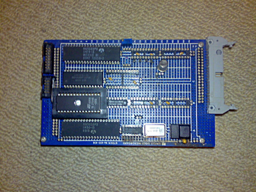

Here is my micro AIM-65 version 2.
My first version was missing the 6532 which is used for the TTY/RS232 parameters.
I guess I should have translated the german article sice it has the 6522/6532 combo as well.
My next project will either be the full AIM 65 or a CRT module.
Schematic_AIM-65 Micro V2_2022-04-02.pdf [306.75 KiB]
Downloaded 90 times

Very nice! You should cover your EPROM window to reduce the risk of unstable behavior.

I have three question about the AIM-65 Micro V2_2022-04-02:
1.- Are you loading the AIM Monitor firmware from Rockwell onto your 27C256 EPROM?
2.- What is the use of the H4 pinheader jumper between CA1 and CB1 on VIA 65C22?
3.- Did you use a 65C22 VIA instead of a 6522 VIA for some reason?
And a note if you are not going to use the AIM65 keyboard:
You might not need the RIOT 6532 by enabling access from $A400 to $A4FF addressing to your RAM area instead to use the 6532's R/W memory space, or by modifying the monitor's .asm code to allocate some parameters in the memory area that you want and then and reassemble it.
So easy as rewrite:
   0147             ;      *  Ex_6532 ADDRESSES (A400-A7FF) , parameters new area in RAM    *
   0147             ;      **********************************
   0400                  *=$A400  ; eliminates this line changing it by the following
   XYZW                  *=$XYZW  ; where $XYZW is the start address area in RAM that you want use to reallocate the parameters
Then, reassemble all the monitor .asm code and load it in an EPROM.
FWIW: I made this in the 80's:
It has been kicking about my room/office(s) since then, sometimes on a shelf, sometimes in a box and recently I decided to remove the UVEPROM and read it... It disassembled just fine.
Sample size 1, YMMV, etc.
 Post subject: Re: AIM-65 SBC
PostPosted: Wed Sep 21, 2022 6:53 pm
Posts: 3353
In case it's unclear, Mike wasn't warning about accidental erasure of the EPROM. Instead, the problem is a temporary effect that can appear when light is allowed to strike the die... and which will disappear when the die is restored to darkness.
I personally got bitten by this in 1994. In my case the chip in question was a 68HC705 EPROM-based microcontroller. According to my understanding (gained after the fact), the PN junctions on the die can translate light into voltage, just as does the PN junction in a photovoltaic cell. On a PV that's a good thing, but of course on an EPROM these voltages are unexpected and not exactly.... helpful. :|
