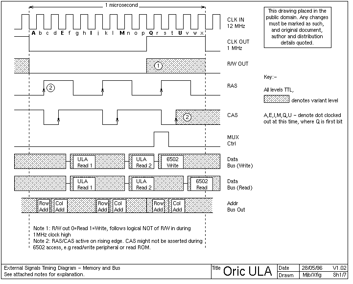

It's true that the NMOS 6502 is a two-phase design, and it's true that the Z80's approach is to use multiple cycles (T-states) for access. (The Z80 has an easier time of driving the strobes of a DRAM as a consequence.)
It's also true that designs using the 6502 commonly use phi2 as a kind of strobe, to have a mid-cycle demarcation. But as Arlet's figures show, even the CMOS version of the CPU doesn't have any external behaviour which relates to the rising edge of phi2. Only the falling edge.
And, it's also true that several designs using the 6502 make use of the fact that RAM access times are somewhat shorter than a half-cycle, to allow for two RAM accesses within one clock cycle, where the second RAM access is for video (or maybe other things?) This is clever, but it amounts to double-clocking the RAM, not as evidence that the 6502 is double-clocked.
As an interesting illustration of other approaches, see the Oric:
